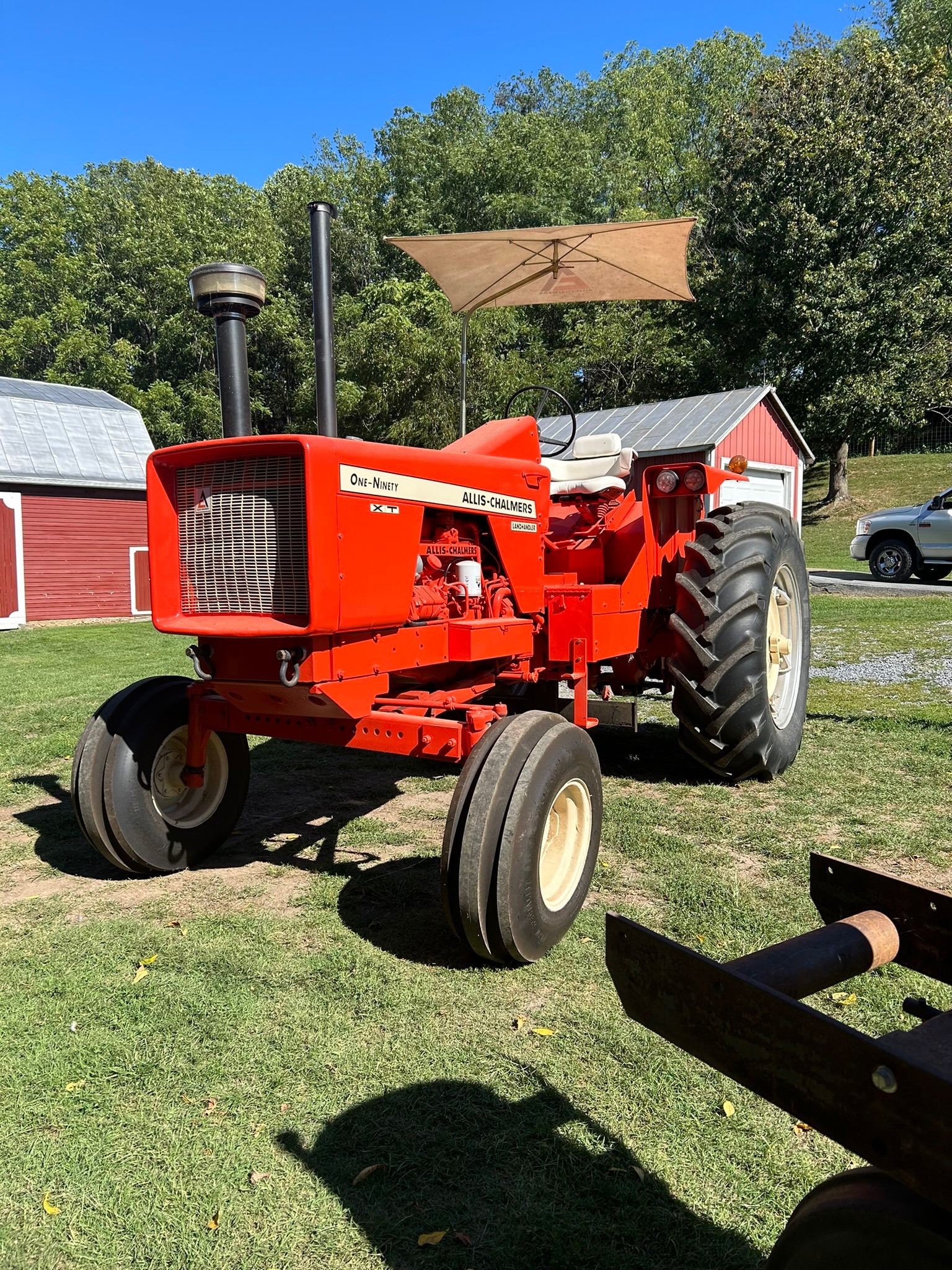

Last week I was using our XT and front end loader to clear dead branches around the perimeter of the fields general cleanup, carry branches and sticks to the burn pile. A day or so later I went to get the tractor out of the shed and noticed the grill was not on the front of the tractor. First I almost got sick to my stomach because it's a pretty good grill, so we started backtracking and looking for it. We found it on top of the burn pile evidently when I was pushing the branches and debris up a stick popped the grill off and I didn't even see it was missing just happy that it's still in pretty good shape. So for anyone out there pushing brush keep an eye on your grill!

When I went through my XT back in 2016 I decided to remove the terrible latches and install a back plate, drill and tap it. Now 4 bolts hold my precious grill in place. No more worries of it coming unlatched and getting run over. Very easy to remove for service. I’m glad you didn’t damage it, they are expensive if you can find a good one.

Great Idea!!! and it looks good too.

AC720. That is the way to repair it! Looks better and works better than factory. Sometimes you can improve on a factory idea. Smile

That looks nice. A cleaner look and better attachment

I do like the looks of that. Will be on the "to do list" for this winter.

Thanks everyone, it has worked very well.
