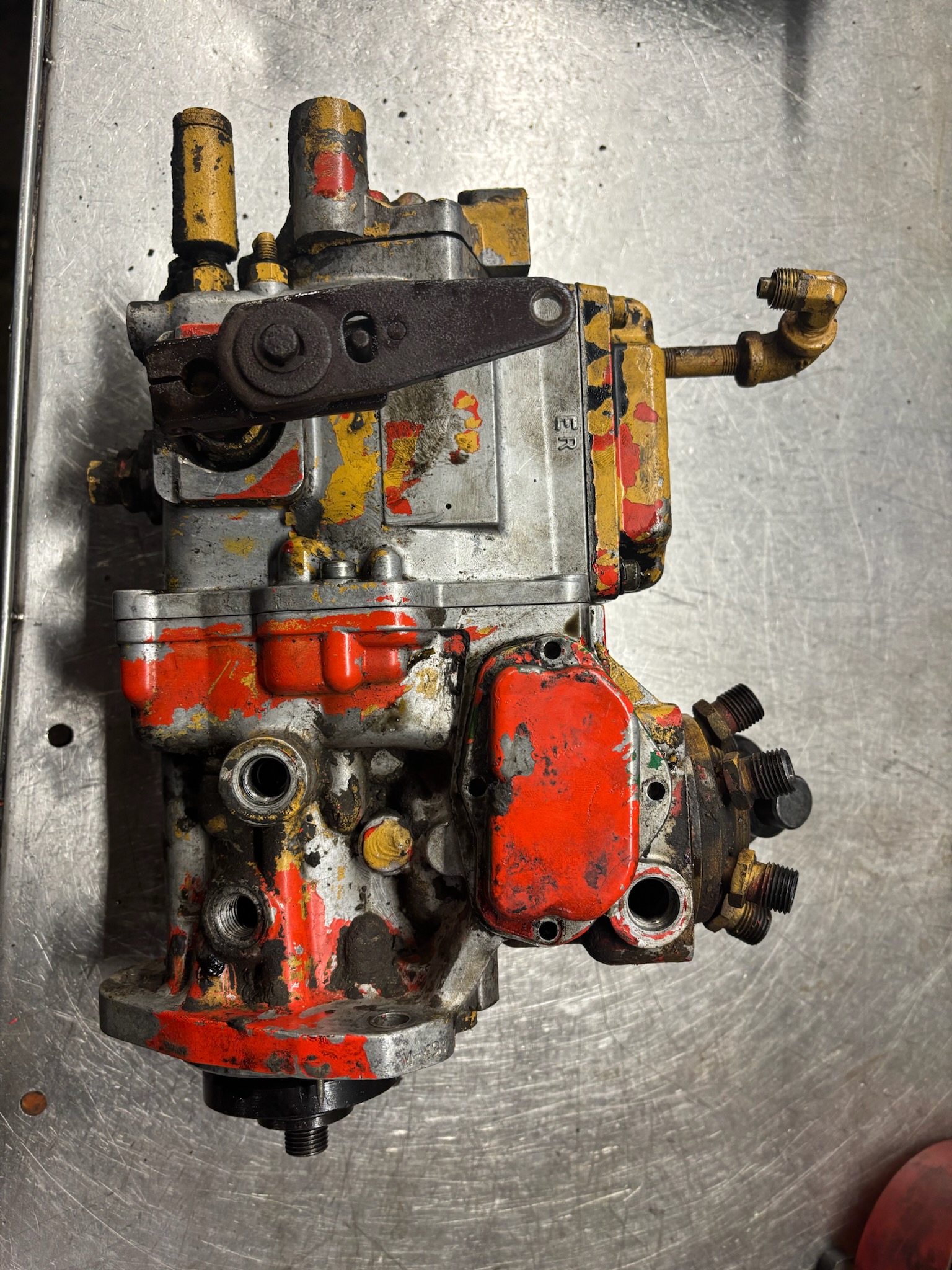

Help Needed:  I have a 645 Fiat Allis Wheel Loader.   It's been a good machine, but my fuel injection pump has gone out.  It is a 1978 645 Wheel Loader.  Serial # 11Y05591
Engine Model #:  670I
Catalog #:  EX45687
Engine Serial #:  70-29570
The pump that is currently in the machine is an American Bosch (Rotary)
The tag is not on the pump.  Can anyone identify the pump #?  The pump may have been changed out since the original build, I don't think so but who knows.
Does anyone know how to get the right parts to repair this without tearing the motor down, etc.

Dean...can you post a picture of the pump? what does the pump spec plate say?

Post Options Post Options   Thanks (0) Thanks(0)   Quote dyounkin Quote  Post ReplyReply Direct Link To This Post Posted: 20 Jan 2025 at 6:22pm
uploads/25415/Loader_Injector_Pump.jpg
1978 FIAT ALLIS WHEEL LOADER
Fuel Injection Pump Identification Needed for rebuild kit OR compatible replacement pump.  The pump tag has been removed.
Rotary Pump
Fiat Allis Loader Serial # 11Y05591     1978 Machine
Catalog #:  EX-45687
The casting #'s on the pump are:  ER   M-4xx

Post Options Post Options   Thanks (0) Thanks(0)   Quote AC Mel Quote  Post ReplyReply Direct Link To This Post Posted: 20 Jan 2025 at 7:50pm
Ok... that's a different version than I was expecting....I think we have some fuel pump books also.....I'll look tomorrow. I'm sure some one else will post up info.
Points: 22777
Post Options Post Options   Thanks (0) Thanks(0)   Quote DrAllis Quote  Post ReplyReply Direct Link To This Post Posted: 20 Jan 2025 at 7:51pm
American Bosch M-100 pump about 90% the same as a 1066-1466 Farmall tractor. Any good injection pump repair facility will have no problem repairing it if that is the problem. What is it doing ??

Post Options Post Options   Thanks (0) Thanks(0)   Quote dyounkin Quote  Post ReplyReply Direct Link To This Post Posted: 21 Jan 2025 at 8:33am
The pump was not pumping fuel. Dribbling fuel. Cracked injector lines and dribbles. This machine is used to lift heavy pieces of rear load garbage truck packer bodies.
Points: 22777
Post Options Post Options   Thanks (0) Thanks(0)   Quote DrAllis Quote  Post ReplyReply Direct Link To This Post Posted: 21 Jan 2025 at 11:29am
Remove the hose/line at the head of the pump (top) that is pointed "out". Crank the engine a bit. Fuel should gush from that hose. Are you sure you don't have plugged fuel filter(s) or the outlet to the tank isn/t letting fuel out ??
