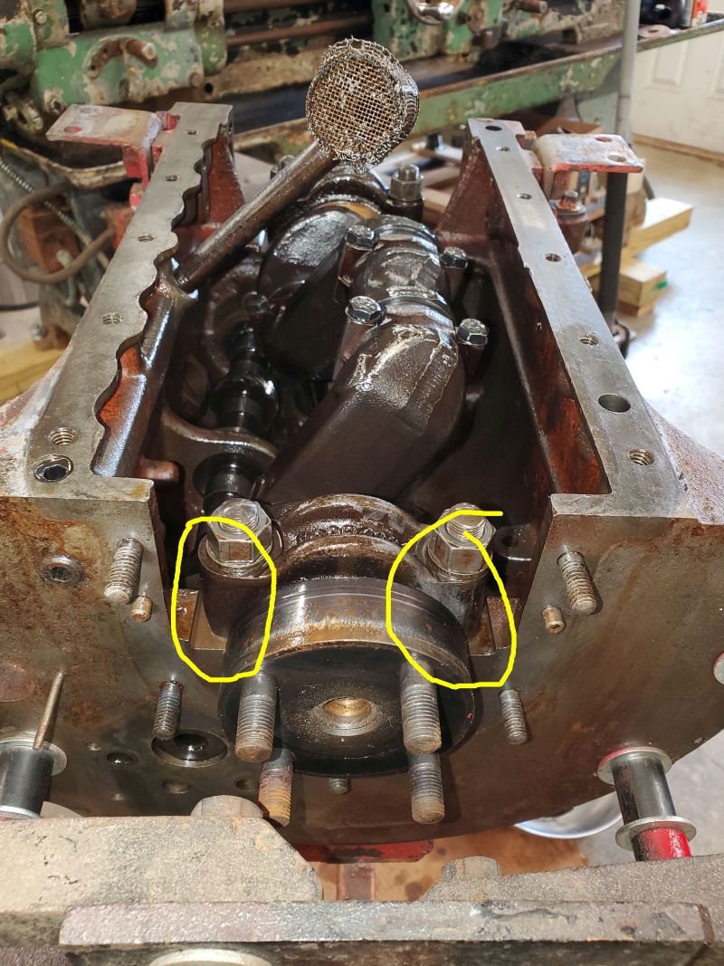

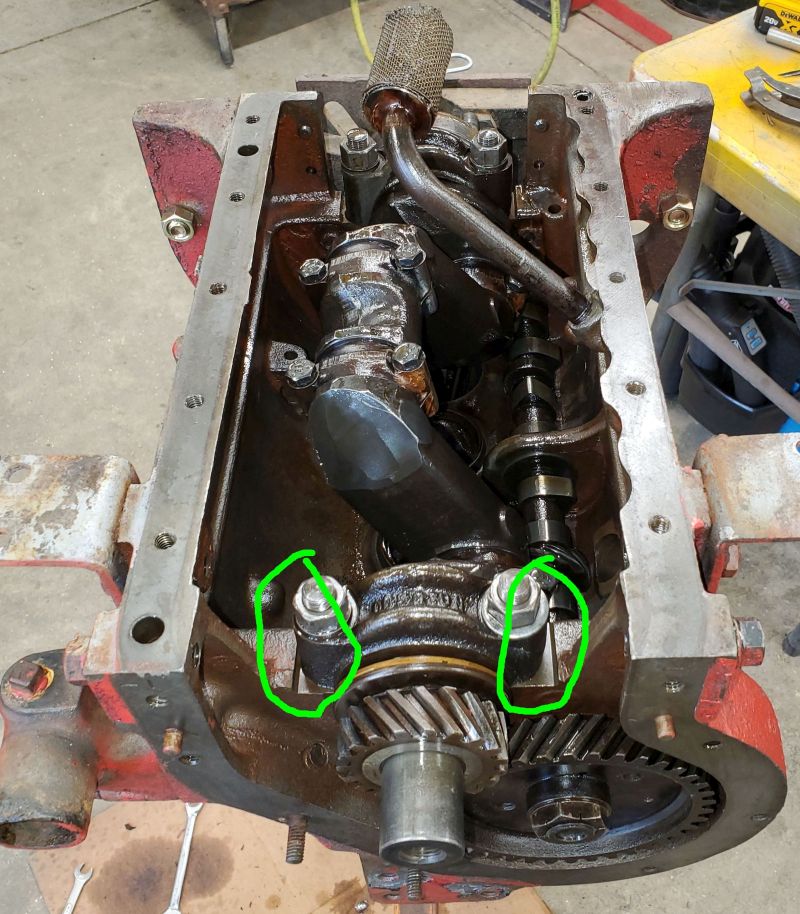

The main bearing caps on this little N62 don't seem to have any interference fit with the cylinder block. The caps are able to shift sideways on the 1/2 inch studs, because of the clearance holes in the caps.
The engine is at the machine shop and requires a line bore. The machinist doesn't feel comfortable because there seems to be no way to get the cap on off and back on in a repeatable manor.
Shouldn't there be an interference fit between the cap and the block? All other engines I've rebuilt have this. How would I install the cap and be sure it's centered? And be able to repeatably install the caps?
