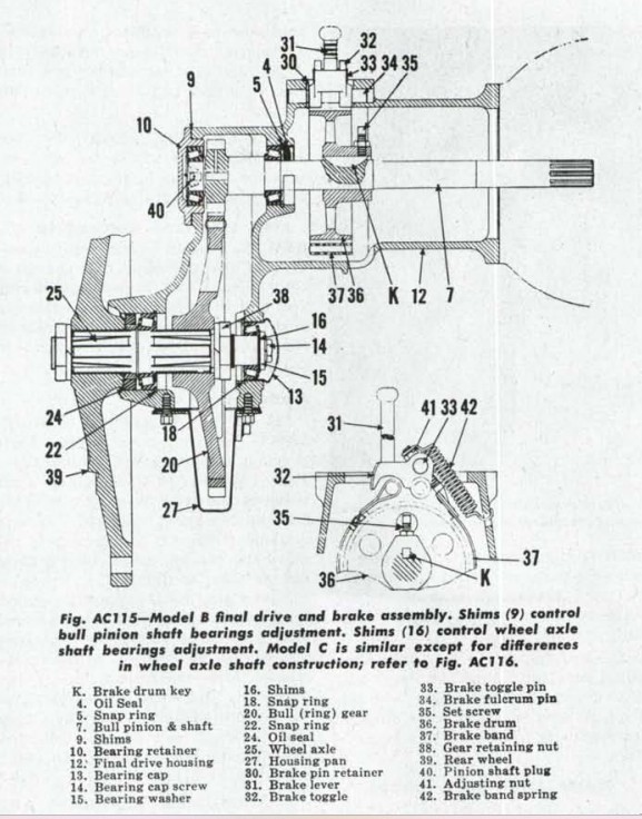

Does anyone have a pic of the RH drum showing the location of the locking setscrew? I cant find it with a flashlight. To the best of my ability, there is NO setscrew visible and accessible thru the bottom casting hole. Thank you!
Points: 90735
Post Options Post Options   Thanks (0) Thanks(0)   Quote steve(ill) Quote  Post ReplyReply Direct Link To This Post Posted: 09 May 2024 at 7:55am
Below is a picture of the B-C final drive and set screw on the brake hub... I ASSUMED the CA was the same, but the book does not mention a set screw and has no photo.. The removal is basically the same as the LARGER tractors... just "use a puller" according to the book.... press fit.
Edited by steve(ill) - 09 May 2024 at 7:57am

I had a CA opened up recently for hand clutch repair and don't recall a set screw for the brake hub.

  There is no locking set screw on the right brake drum that is part of the axle clutch, however there is a set screw in the Left brake drum. The left brake drum is the same part that is used in B & C Tractors.
