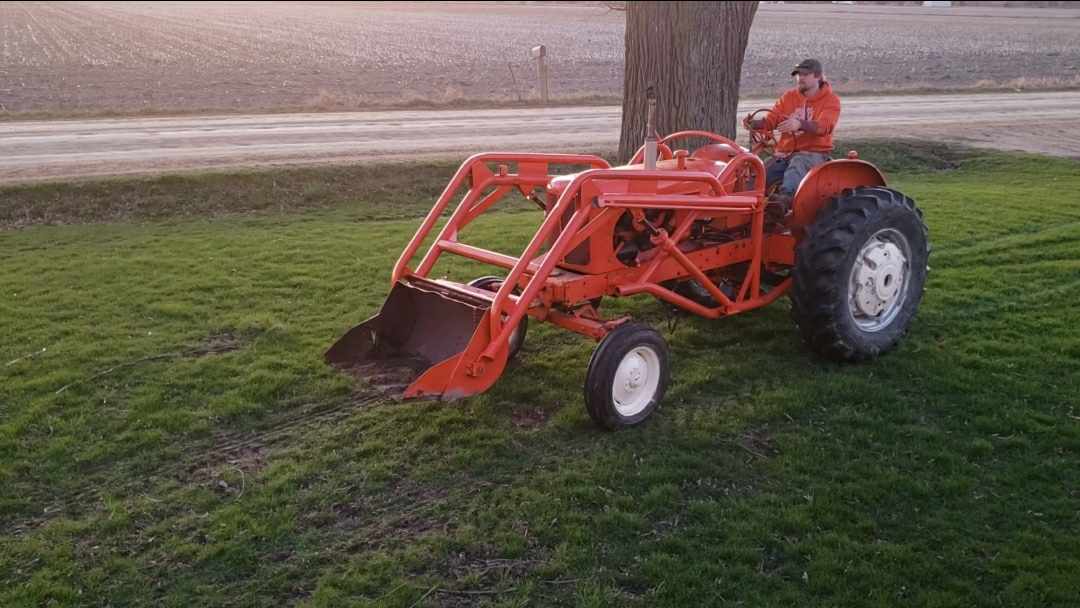

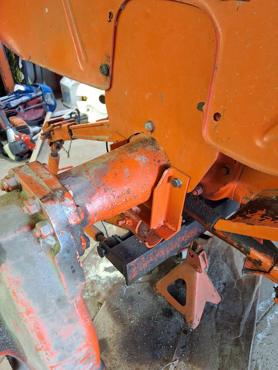

That hanger is for a pipe frame loader on a CA or D14. The smaller D series may have used it aswell.I just put a #17 loader on my WD45 this past weekend. It uses a similar hanger but the part that bolts to the axle is different. I will include pictures below. The axle brackets for the WD45 are the same for the D15 and D17.
Again I am unsure on the D14 and D12 etc.
Here is my loader and the axle bracket.

Thanks for the picture of the bracket.  I'll check for adaptability to my D17.  I also know where I can view a C and that will be interesting.

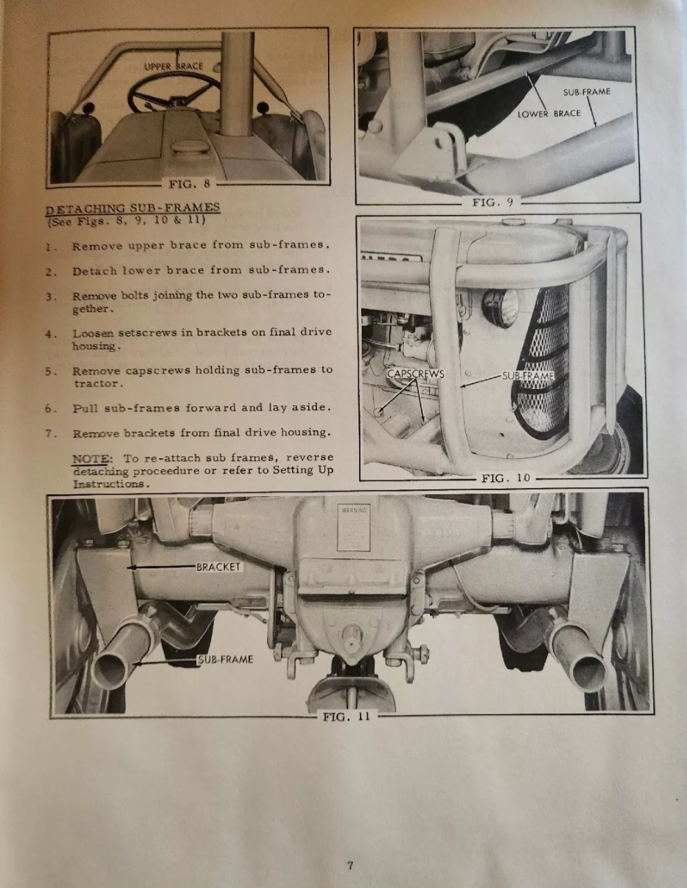

J, here is a photo from the #14 and #17 farm loader manual showing the brackets you have mounted on a D14. The brackets for the D17 are identical to mine shown in my previous photos and the overall loader is larger. A Facebook friend of mine in Gobles MI is pretty much the expert on these D series pipe frame loaders.
Accordong to him, there was a #14, #15, and #17. The #14 is the odd ball, as it is the smallest.
The #15 is the same overall size as the #17, however the width is narrower, so the brackets are set in more and the upper and lower cross braces are different.
The #17 loader is meant for the D17, but as shown above will fit a WD/WD45 with 2 extra holes in the tractor frame.
