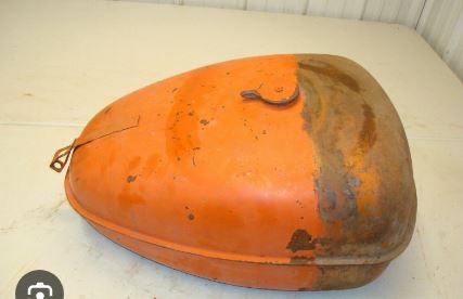

Secondly, I am wondering if any of you know what the purpose of the L-shaped bracket is that is mounted directly behind the fuel tank. I looked at pictures of restorations online and I see that some didn't have this piece, and some did have it, and some had some other variation of it, however, I never see anything mounted to it or it serving any purpose really.
Pics included in this post for visual reference.

The bracket at the rear of the fuel tank was for a "strap" used as an additional attachment for the fuel tank.  This changed through the run of the B, early models did not have this, later models (such as yours as a 52) did have it.  I am guessing at some point the tank was changed on yours, or possibly the strap was damaged or removed for repair and never reattached.  I don't have a picture handy, but think of your main strap on the front of the tank - cut the end off with a short tail of the strap and spot weld to the tank.  The bolt in the end of the strap would go through the bracket you have pictured.
