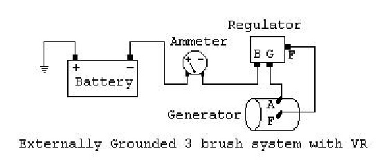

hi everybody have a electrical question. had generator rebuilt its 6 volt have 6 volt regulator a ammeter Battery reads 6.35 before starting but when running it reads 10.0 to 19.0. It bounces around. I believe I properly acclumated it to 6 volt. Battery to field. any suggestions
Points: 89986
Post Options Post Options   Thanks (0) Thanks(0)   Quote steve(ill) Quote  Post ReplyReply Direct Link To This Post Posted: 21 Mar 2024 at 12:53pm
"F" is the GROUND... not connected to battery...
if you run a 6 volt generator and it is not connected to a battery... You will get 12 - 18 v output... I have tested that......... so i assume you have no connection between the "A" terminal , thru the regulator, to the battery..... Did you connect pos or negative ground ?  Is your regulator setup for that polarity ?  Did you short the "G" and "B" terminals together for a quick spark prior to startup ?
Edited by steve(ill) - 21 Mar 2024 at 1:00pm

I will check this drawing with what I have. I forgot to mention the ammeter does not read anything. Thanks in advance
Points: 89986
Post Options Post Options   Thanks (0) Thanks(0)   Quote steve(ill) Quote  Post ReplyReply Direct Link To This Post Posted: 21 Mar 2024 at 1:40pm
yes... if the amp meter is bad... or the wire is not connected... you have NO PATH to the battery.. and the Generator will put out MAX VOLTAGE... 12- 18 v.

I'll try to explain this as best I can. Battery is pos. ground. Ground on battery goes to ammeter pos. side. Ammeter neg.side goes to Bat on regulator. A on generator goes to arm on regulator. F on generator goes to Field on regulator

I assume arm and G mean the same on generator
rilenz View Drop Down
Joined: 23 Dec 2022
Location: WI
Points: 87
Post Options Post Options   Thanks (0) Thanks(0)   Quote rilenz Quote  Post ReplyReply Direct Link To This Post Posted: 21 Mar 2024 at 2:54pm
I'm sorry I meant arm is same as G on regulator
Points: 89986
Post Options Post Options   Thanks (0) Thanks(0)   Quote steve(ill) Quote  Post ReplyReply Direct Link To This Post Posted: 21 Mar 2024 at 7:25pm
YES.... "A" and "G" are the same thing..
POS ground... so you mean the NEGATIVE terminal goes to the amp meter....other terminal to "BAT" on the regulator as you said...the drawing above is correct..
if your amp meter is BAD, or you think it is... just bypass and run the "BAT" terminal of the regulator to the NEG bat post.... for a test..
Edited by steve(ill) - 21 Mar 2024 at 7:26pm

Hi everyone I'm going to beat this charging problem one way or another but I need advice.   I have a 6 volt positive ground CA. I wired it like steve (ill) advised I put new 6 volt reg. on had my generator check out cleaned all grounds put new ammeter on but when I start it up it reads 0 then when I turn lights on it reads -15. I checked battery with volt meter before startup it was 6.22 when running it goes from 12 to 19 and eveything in between rapidly.

I do have the L connected to the light switch and kill switch. When I get time this week I will take loose all the wiring and start over. Not hooking power from L to switches and other things youse have said. Thanks for all your advise. Hope it works out I love this tractor

Originally posted by rilenz rilenz wrote:
I have a regulator that has lights, bat, field and on the other side Gen. It is 6 volt.
I am still pondering on this.
If a 12 volt regulator happened to be installed in a 6 volt system it seems to me that it might behave in a similar manner to your symptoms.
The regulator will see the 6 volt battery as being under-voltage and would then attempt to drive the generator to maximum voltage (and current). The voltage limiting relay would probably not reach its limit, but the current limiting relay probably will, causing it to break the field circuit, which will then cause the current to go to zero and the voltage will drop to ~6 volts.
The voltage coil will then see a perceived under-voltage situation and will close the field circuit, once again driving the generator to maximum output causing the current limiting coil to open the field circuit, etc. etc. etc. Thus rapidly cycling the voltage high-low-high-low-high-low.
A cheap digital meter will attempt to follow those fluctuations giving bewildering readings.
I dunno. Just speculating. Tongue
