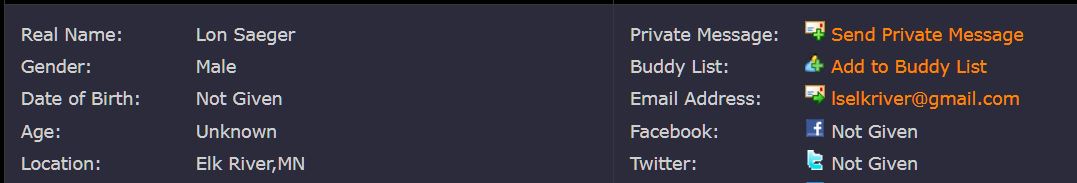

THere are several on this site who could sell you a GOOD crank... LON(MN) is one that should have several cranks.....e-mail below --- or send a PM.

Thank you Paul. I emailed Steve last night and he says he has some that are still at standard size. If what he has wont work I will get in touch with you.

That would be LON(MN) who got in touch with out about SEVERAL cranks he has in stock... I just passed along the info..
