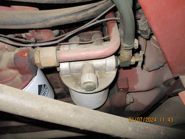

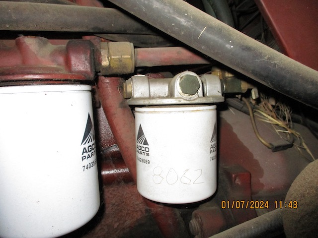

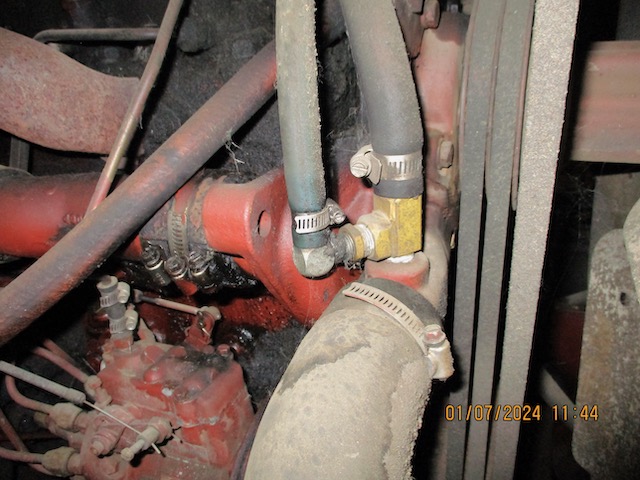

This is my 7000:
It was a little dark in the shed to see how it goes onto the filter base but if you need more I will take another look.

Post Options Post Options   Thanks (0) Thanks(0)   Quote CDN 400 Quote  Post ReplyReply Direct Link To This Post Posted: 06 Feb 2024 at 1:32pm
That's on the opposite side to my 7020 and mine has formed steel lines going to it.

Post Options Post Options   Thanks (0) Thanks(0)   Quote Ron(AB) Quote  Post ReplyReply Direct Link To This Post Posted: 06 Feb 2024 at 3:03pm
Allis/Agco used to have kit with steel lines for these tractors but as supply ran out you were lucky to just get the base and hook up your own hoses instead.
Now, you might have to go to a filter supplier for a WIX base or similar and go from there.

Post Options Post Options   Thanks (0) Thanks(0)   Quote Leon B MO Quote  Post ReplyReply Direct Link To This Post Posted: 07 Feb 2024 at 7:23am
Thanks for the pics. I got a filter base from salvage yard, just have to get some fittings and install.
