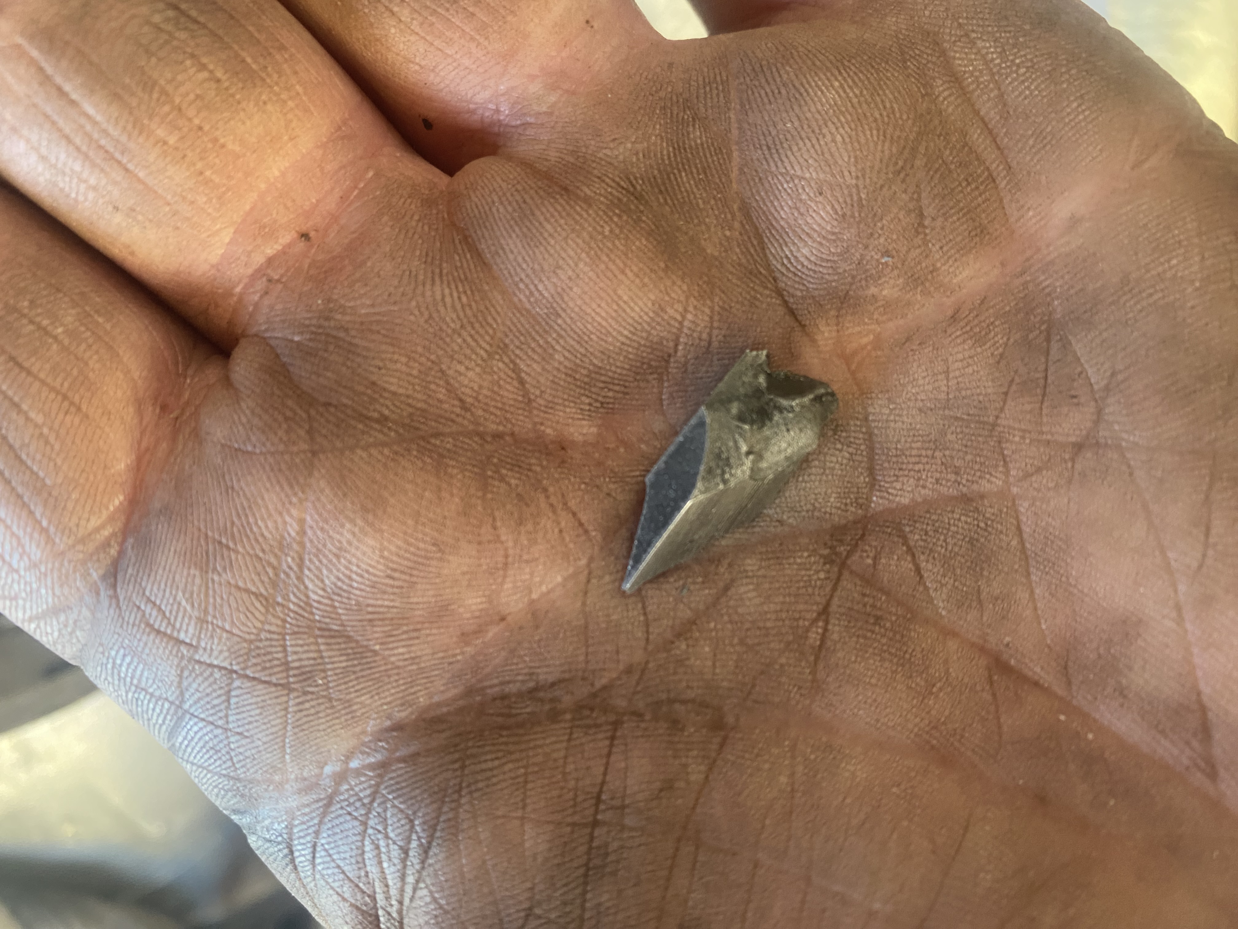

Thanks, when draining the fluid in the rear end I found a small amount of metal flakes and a small piece of what I think is a gear tooth. This tractor is new to me and I’m trying to figure out how to inspect what maybe wrong without taking the whole thing apart yet. The tractor operated fine and didn’t seem to make any odd noises.

Post Options Post Options   Thanks (0) Thanks(0)   Quote DrAllis Quote  Post ReplyReply Direct Link To This Post Posted: 05 Feb 2024 at 9:19am
WHICH DRAIN PLUG ???? THERE ARE THREE...
Gleaner52 View Drop Down
Joined: 15 Dec 2023
Location: Illinois
Points: 20
Post Options Post Options   Thanks (0) Thanks(0)   Quote Gleaner52 Quote  Post ReplyReply Direct Link To This Post Posted: 05 Feb 2024 at 10:26am
The center plug and some on the right hand plug.
Points: 22799
Post Options Post Options   Thanks (0) Thanks(0)   Quote DrAllis Quote  Post ReplyReply Direct Link To This Post Posted: 05 Feb 2024 at 10:44am
There are people that get kind of anal about finding cuttings on drain plugs when maybe the drain plug hasn't been cleaned in the last 20 years. You can go searching for the needle in the haystack if you want, but will probably come up empty. Change the oil and filters (AGCO filters) and clean the drain plugs. Run it for a year and check the drain plugs again and I'll bet they will be just fine.

Post Options Post Options   Thanks (0) Thanks(0)   Quote Gleaner52 Quote  Post ReplyReply Direct Link To This Post Posted: 05 Feb 2024 at 10:53am
I agree, but there is a piece of gear tooth that is more substantial than “cuttings”.
Points: 22799
Post Options Post Options   Thanks (0) Thanks(0)   Quote DrAllis Quote  Post ReplyReply Direct Link To This Post Posted: 05 Feb 2024 at 11:09am
A sliver of a gear tooth isn't common, but not uncommon. I know of a 7020 that had a planetary final drive "sliver" of a gear tooth in an oil change and that was 27 years ago. Tractor still running without ANY issue. Like I say...give it a year and recheck.

Post Options Post Options   Thanks (0) Thanks(0)   Quote Ed (Ont) Quote  Post ReplyReply Direct Link To This Post Posted: 05 Feb 2024 at 11:18am
Run it for a few weeks.Buy an extra plug and swap quickly one at a time. Then check each plug. Should be able to do all 3 and not lose much oil. May give you some more info.

Post Options Post Options   Thanks (0) Thanks(0)   Quote Ron(AB) Quote  Post ReplyReply Direct Link To This Post Posted: 05 Feb 2024 at 1:27pm
If a broken gear tooth came out of the transmission drain I would stop running the tractor and pull the trans apart.
I had to split my 8070 and change two gears...The broken piece that came out during an oil change only was a fraction of what was damaged.
Try getting a look at it if possible.

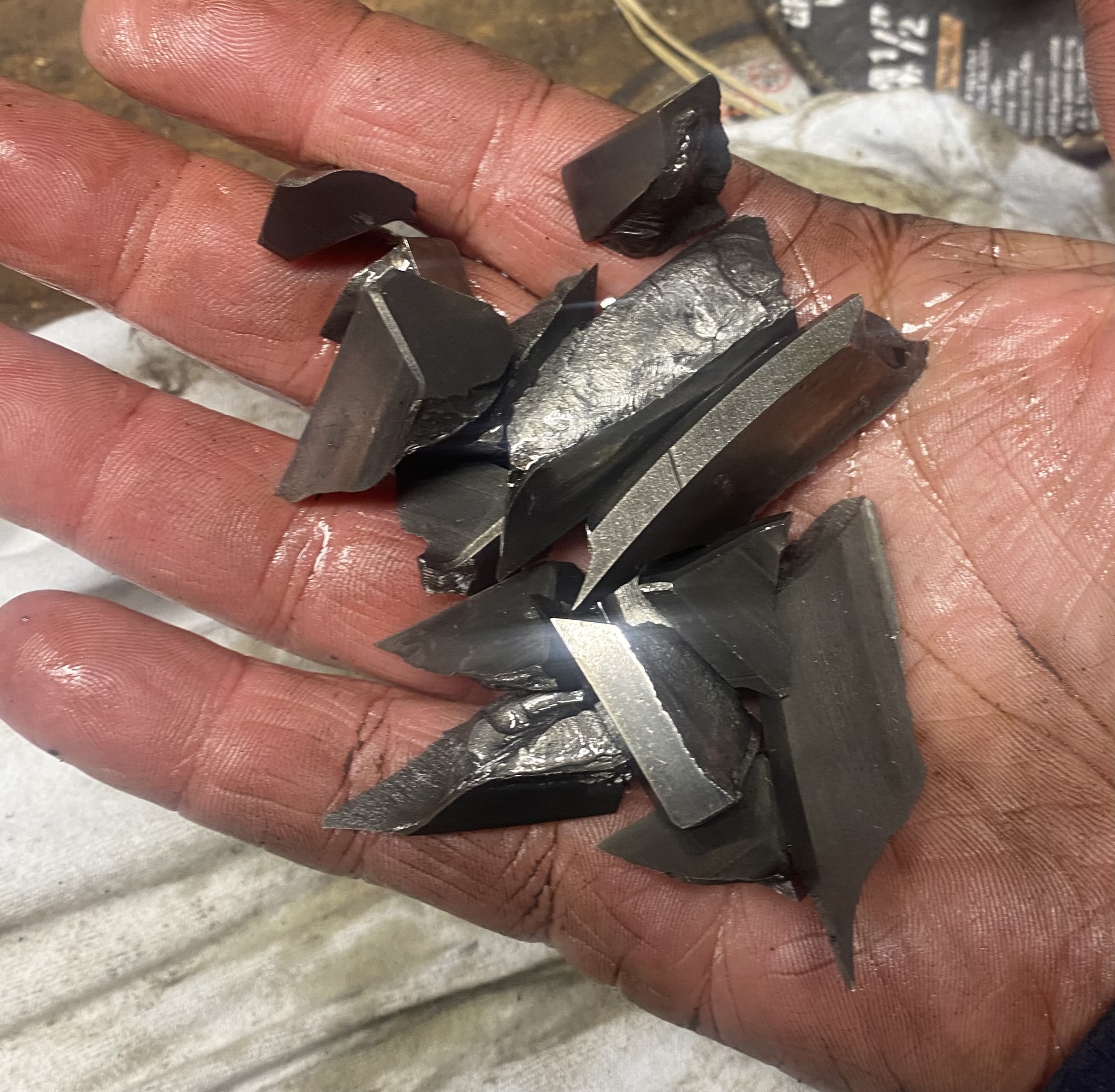

Post Options Post Options   Thanks (0) Thanks(0)   Quote Ed (Ont) Quote  Post ReplyReply Direct Link To This Post Posted: 06 Feb 2024 at 5:04pm
Ouch. That is not looking good! How long have you had the tractor? Any chance that someone has been in there before??

Post Options Post Options   Thanks (0) Thanks(0)   Quote Gleaner52 Quote  Post ReplyReply Direct Link To This Post Posted: 06 Feb 2024 at 5:21pm
Dug into it further, ring gear is shot.

Post Options Post Options   Thanks (0) Thanks(0)   Quote Gleaner52 Quote  Post ReplyReply Direct Link To This Post Posted: 06 Feb 2024 at 5:23pm
Haven’t had it long, auction buy. Glad I found the issues before it let me down in the field. Now to try and get it repaired.

Post Options Post Options   Thanks (0) Thanks(0)   Quote DrAllis Quote  Post ReplyReply Direct Link To This Post Posted: 06 Feb 2024 at 5:37pm
Ring gear piece ?? What's the pinion look like ??

Post Options Post Options   Thanks (0) Thanks(0)   Quote Gleaner52 Quote  Post ReplyReply Direct Link To This Post Posted: 06 Feb 2024 at 5:42pm
From what I can see it looks fine.
