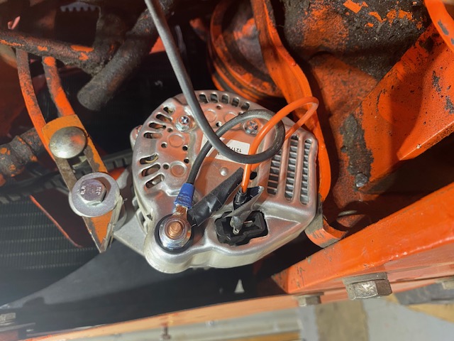

This charges great but draws the battery down when shut off if I forget to use the batts ground disconnect)
As you can see, below the big terminal on this Denso alt on my 17 III are 2 terminals forming a “T”. The top of the T I have jumping to the big terminal. Am I correct in wanting to run a wire from the other terminal of the “T” to a dash light and then onto the + side of coil? It seems the light and coil would only be energized with engine running? Will this prevent drawing the batt down if I forget to isolate batt ground? Thanks as usual! Capn D

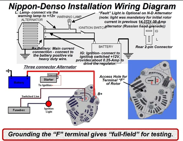

On the DENSO the two small wires are HOT and SIGNAL, just like on the DELCO.. The DIFFRENCE is the HOT can not be directly connected to the BIG LUG.. It should be switched on and off just like the SIGNAL wire... but the SIGNAL also has the light bulb/ resistor in the circut..

Just curious Captain Dana, if you disconnect jumper wire (the IG wire as in Steve's wiring diagram), will the battery be drained if you leave the bat ground disconnect connected?

Ok Steve I see it on your diagram thanks again.

Captain... "normally" you dont expect to have a voltage "LEAK" when you jumper the #2 terminal to the BIG LUG... That works 99% of the time on a DELCO... It FAILS about 90% of the time on a DENSO ... Thats why they recommend using the SWITCH to turn BOTH terminals ON and OFF.
The NEXT test will be to power the coil from the switch also.. "NORMALLY" the same terminal that powers the two alternator spade terminals... See if that works and when you turn the key OFF, that the alternator does not backfeed thru the #2 spade and feed power to the coil for RUN ON.....
If that happens, then you need a pressure switch or relay that the IGN SWITCH can energize and that turns the alternator on..

This is how I did mine, the plug in diode is available from Steiners.

Dave .... you put the Diode in the IG line ( to stop feed back ?)... and NO LIGHT / signal wire used ??

Post Options Post Options   Thanks (0) Thanks(0)   Quote Dave76 Quote  Post ReplyReply Direct Link To This Post Posted: 16 Dec 2023 at 9:31pm
That wire goes to the ignition switch, hot with the switch on, been that way for five years now and has been flawless. The tractor sits for three or four months in the winter and I never unhook the battery and fires right up.

Post Options Post Options   Thanks (0) Thanks(0)   Quote Dave76 Quote  Post ReplyReply Direct Link To This Post Posted: 16 Dec 2023 at 9:34pm
The diode is to stop feed back and draining battery.

OK.... so the LIGHT/ RESISTOR is not needed on the NEWER VERSION of the DENSO...  Good to know !
And the DIODE prevents the alternator feeding back to the switch and then to the coil after you shut down.... Good idea... better than a relay or pressure switch !
