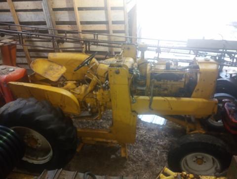

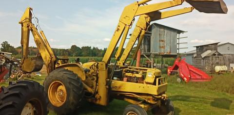

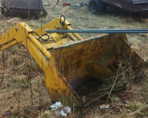

Finally got a d17 industrial. It has the TS1000 loader but it's in tough shape .Did the d17 industrial ever come with the TS500 loader like the d15? Just wondering if I can put a TS500 loader on the d17 industrial? If so how hard is it to do?

Here is some pictures of the d17 with ts1000, plus ts500.
(With my son proudly "driving", he loves it so much he cried when he had to get off ).
Yes, I know there is 6" difference in width between the two loaders, but I want to put the loader and mounting brackets from the d15 onto the d17 if possible. Not planning on putting backhoe back on.

Post Options Post Options   Thanks (0) Thanks(0)   Quote DrAllis Quote  Post ReplyReply Direct Link To This Post Posted: 03 Dec 2023 at 12:52am
Can't directly answer your question. But this I do know: the tractors side frame width between a D-15 and D-17 and D-19 are all exactly the same. D-14's are narrower. So, now all you are dealing with is the length to the axle housing and out the front where the pump drive is. Pretty easy to measure that up.
