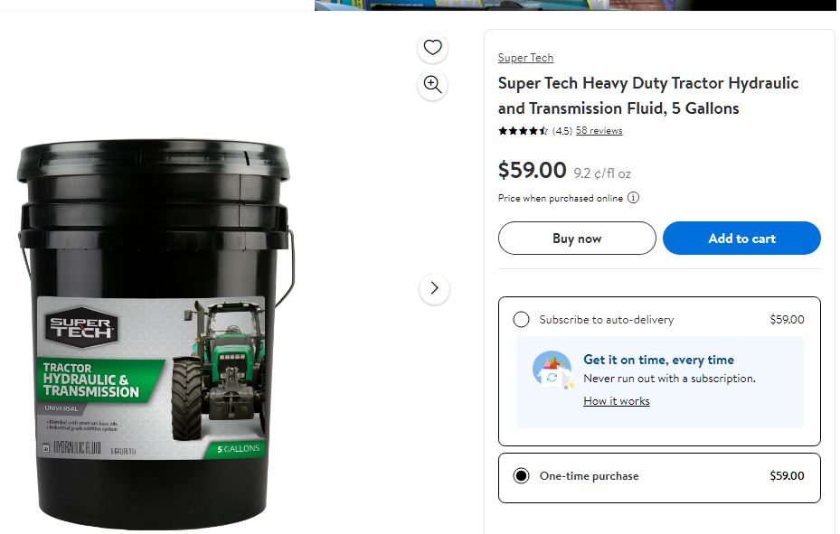

I have pretty good "going easy on stuff" judgement. If anything I tend to go too easy.
So...a fluid like this is okay for all the transmission stuff? Nobody around here sells straight 20W.

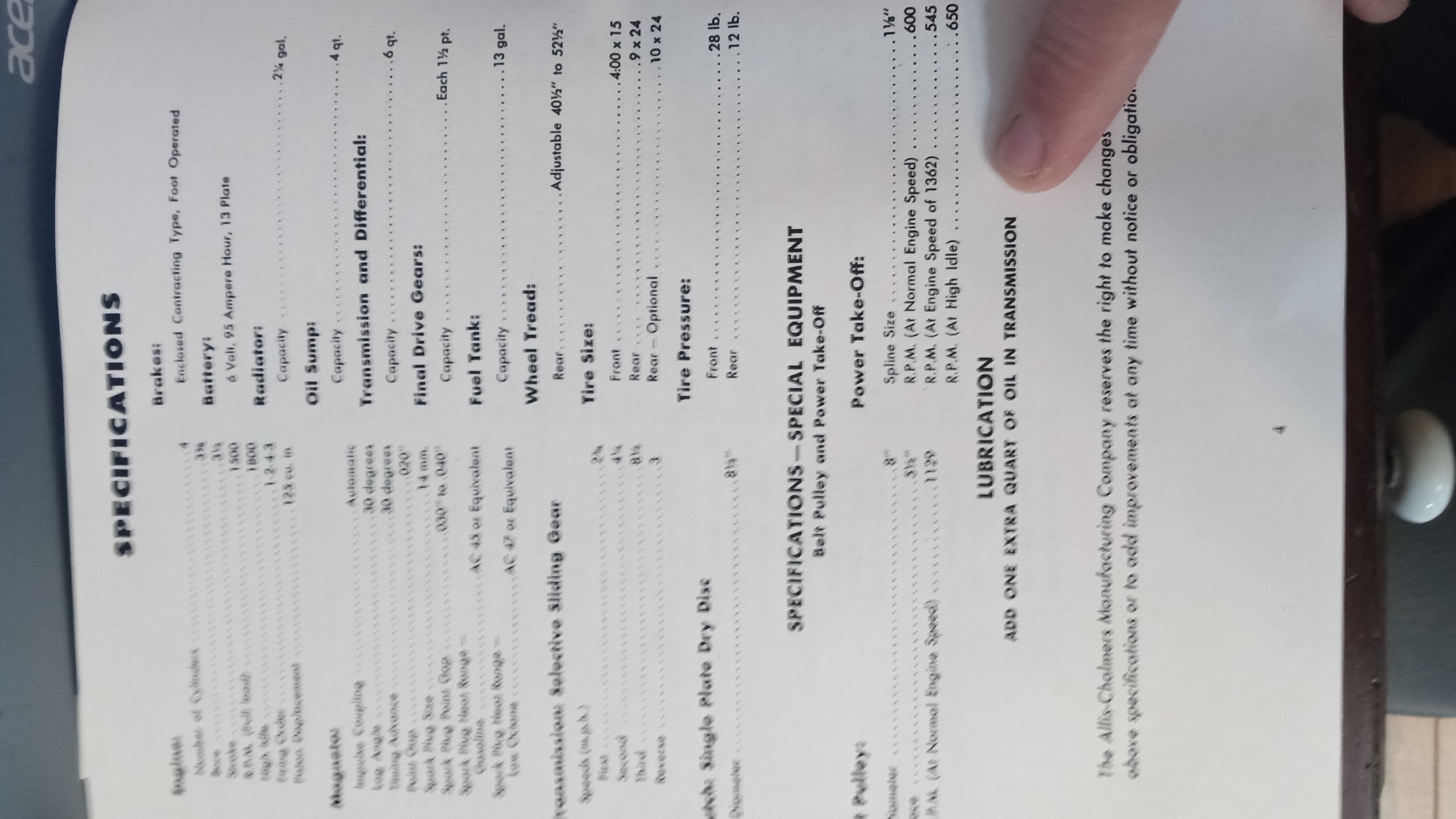

So, you're going to hate me for still overthinking...but it says to add one extra quart of oil to the transmission (where I'm pointing) in the dealer manual. I'm assuming that's only for using the PTO. The sickle mower uses it, I think, so how do you add an extra quart? The manual says to keep the transmission topped off to the drain plug. Obviously you can't add more because it'll just run back out.
And apologies for the terrible cell phone photo. I dropped my phone in three feet of mud and it's never quite been the same.

Points: 90763
Post Options Post Options   Thanks (0) Thanks(0)   Quote steve(ill) Quote  Post ReplyReply Direct Link To This Post Posted: 16 Nov 2023 at 1:28pm
Yes, that is fine... you might get a better deal on a 5 gallon bucket at the local Farm Store or Wal Mart...
Points: 90763
Post Options Post Options   Thanks (0) Thanks(0)   Quote steve(ill) Quote  Post ReplyReply Direct Link To This Post Posted: 16 Nov 2023 at 1:31pm

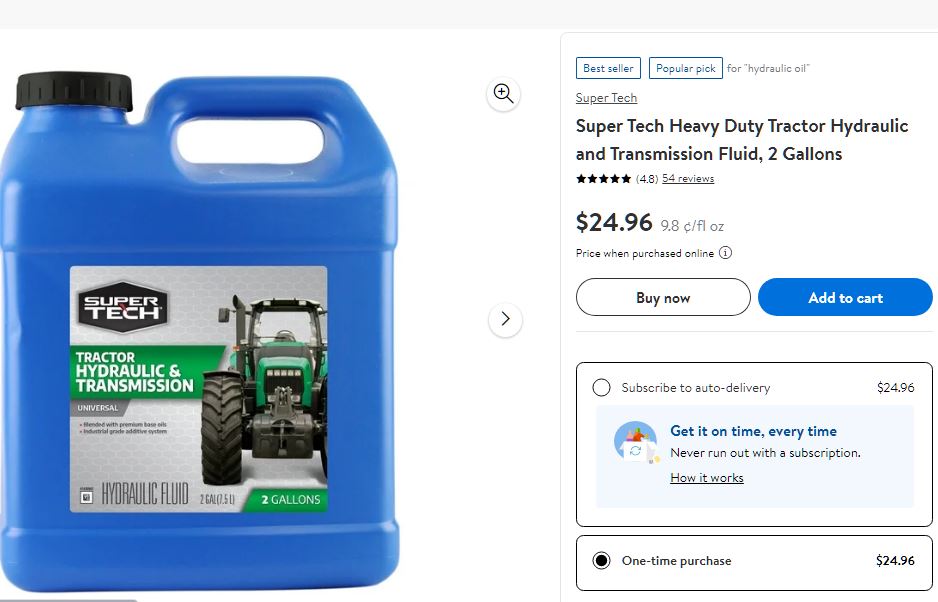

when you add HYDRAULICS to the tractor, you get a hydraulic pump / valve / cylinder... and that will take an extra quart.... EIther way, you fill the 1 inch pipe plug by your left foot to the bottom of the thread....
I think Wal Mart also sells 2.5 gallon ( 10 quart) jugs... if you dont want to have much left over setting around.

Thanks, I won't worry about extra fluid, then.
Damn...that is half the price of NAPA and significantly less than O'Reilly's (which is not surprising). Clap It doesn't say what viscosity it is. The NAPA one says 10w-20 and O'Reilly's brand is straight 30WT. Probably doesn't matter. Overthinking!
Points: 90763
Post Options Post Options   Thanks (0) Thanks(0)   Quote steve(ill) Quote  Post ReplyReply Direct Link To This Post Posted: 16 Nov 2023 at 4:48pm
viscosity does not matter much in this application... Some os 20, some is 30, some is 10w30.... all OK..
