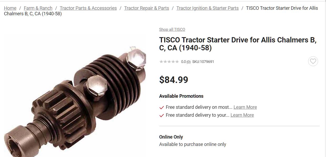

Ideally the spacing of the teeth on the starter should match the spacing of the teeth on the ring gear but there may be enough tolerance for either one to work. I thought the B, C and CA would interchange.
Points: 90778
Post Options Post Options   Thanks (0) Thanks(0)   Quote steve(ill) Quote  Post ReplyReply Direct Link To This Post Posted: 11 Nov 2023 at 7:09pm
Where can you buy a 12 tooth bendix for a B, C, CA starter ?  .... Im sure there are 12 tooth units, but maybe NOT for the CA ??  .... Lots of companies used DELCO starters.
