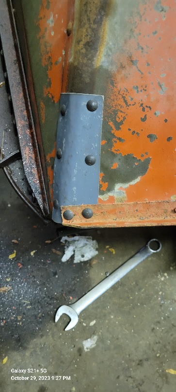

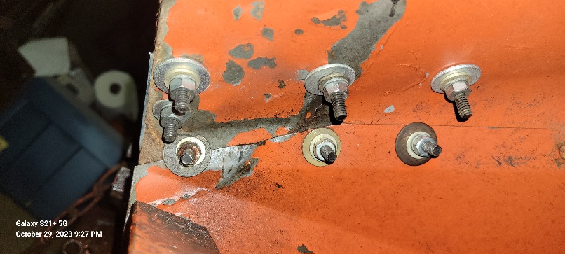

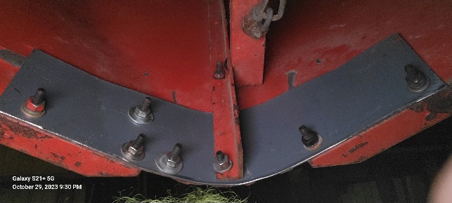

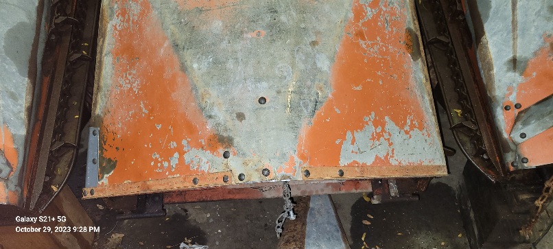

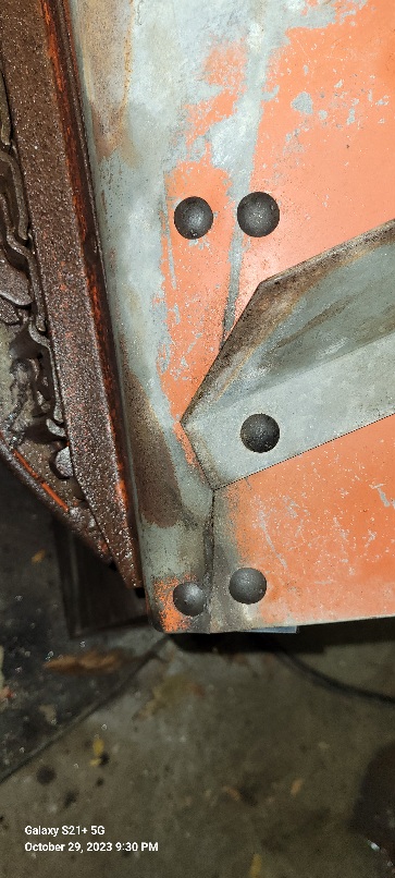

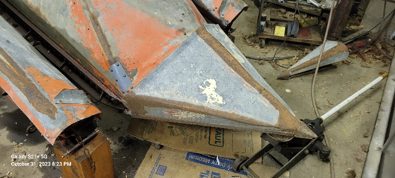

40 hours labor into making this 150 functional.
Current status. Still working off checklist.
Currently: Removed snouts,
Installed a few doublers, straightened rotating pins and antisezed pins before re-installtion.
Drained power steering fluid, found nice bright red "thin" fluid in it.
Serviced with appropriate fluid. PS works much better now.
Recieved new roll of chain and master links. For use to drive rear elevator and blower.
However, as recomended by one of our forum members. I will operate/functional check picker "in the corn field" without rear shoot attached.
Photos to come.
