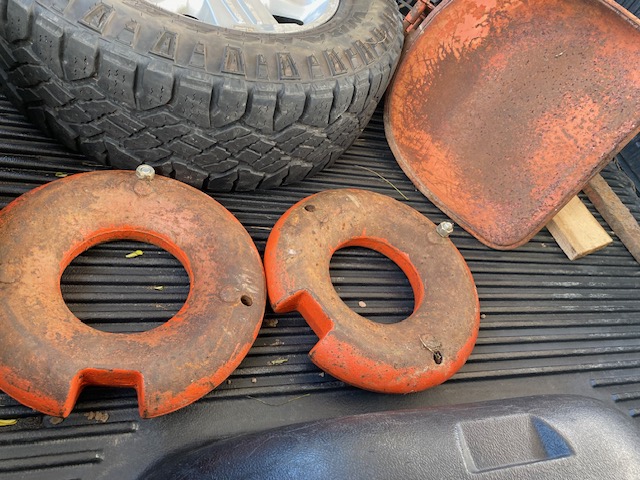

What kind of bolts do I need??

So I’m thinking these have a special head to fit in the slots of where the dish meets the rim?

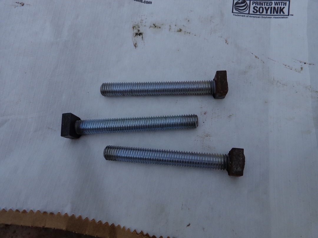

Dana, I made mine out of all-thread and flat stock. Might have an extra set around here if you can't find any closer to home.

Dana, mine are 1/2-13x4".

Figures the square headed bolts I was thinking of are 3” and 4-1/2” long.
Here’s a real bolt. Measures 3-3/4” long.

I sat tire and rim between 2 milk crates and set weight onto rim, reached under and fed the ground off carriage bolts up through.
