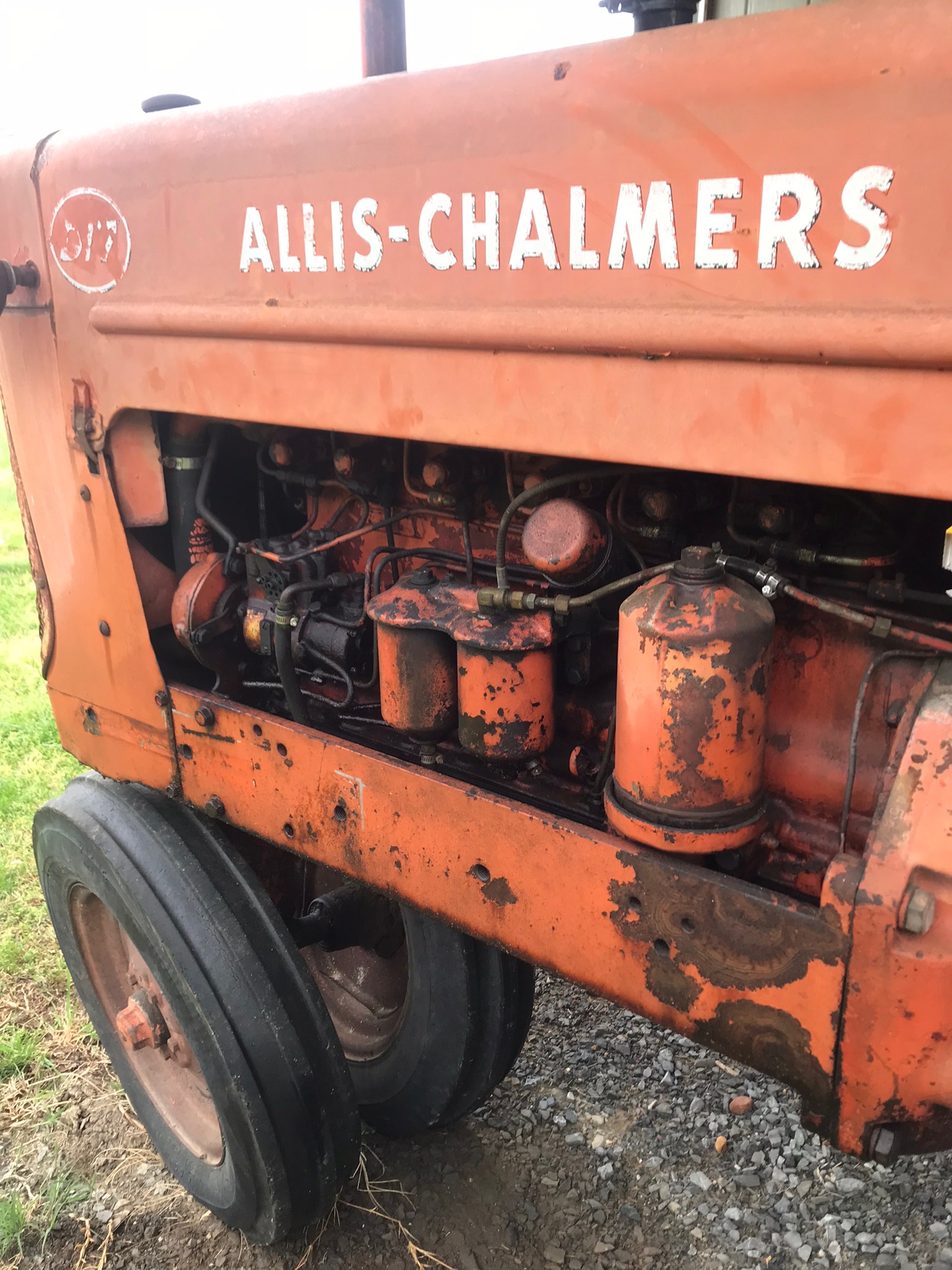

I’ve been repairing this D17 for the past 6 months and searching for correct parts for the past year. Over the years the previous owner changed out the shroud and grill due to damage to the original so my search for the correct shroud and grill began. Luckily a forum member was parting out his 59 diesel and had what I needed and it was in really nice shape. A few dents but no rust, grill only had one small damaged area, and the correct head lights. Really pleased and lucky to find the shroud let alone a grill and head lights. Also purchased another new grill from Don Snow. He makes a beautiful replica which will be on my D17 after I get it painted. The other grill has knock outs removed in case I want to add my grill guard.
I want to thank everyone that responded to my questions on here as I was in new territory since I’ve never owned a D17 or a Buda diesel. Similar to our D15 gas in some ways so being familiar helped. Also want to thank Steve at B&B Custom Circuits for the generator rebuild and great wiring harness. And to Ed Guenther of Guenther Heritage diesel for rebuilding my leaky pump. Both of these guys back up their work and always answered my questions. I’ve dealt with them both in the past so it was no doubt who I was going to for my repairs.
I started using the tractor late last spring after I purchased it, summer, and fall mainly with my 82 S sickle mower that I removed from my WD. Luckily found the necessary belt pulley mount for it and had my local machine shop make the support bracket from the pto drive to the drop housing. It’s a great mowing tractor with the 82 S and much safer than my WD. I had a pretty good idea of all the things that needed to be repaired when I purchased it but of course found other things along the way as well. It already had a new clutch and throw out bearing which was good news. Brakes were in need to be replaced, gauges were crap, and although the tach worked the hours were almost unreadable. I could tell it the first digit was a 5 so it had a lot of hours on it which looking at the pedals I would agree with. After Haim rebuilt the tach it had 5,584 hrs on it. I bought it for a good price preparing myself to put some money into it. I finally found a 59 black bar D17 that I had been looking for. After using it I repaired some things when time allowed and then got serious back in February. After delays of all sorts, she is almost complete. It’s not a show tractor, isn’t meant to be. It will be used on the farm just like the rest of our AC’s. It just looks better, drives better, and runs smoother than when I purchased it. A lot of my own choices such as color that may not make everyone happy but that’s ok. Lots of pictures to follow over the next few days, hope you enjoy.

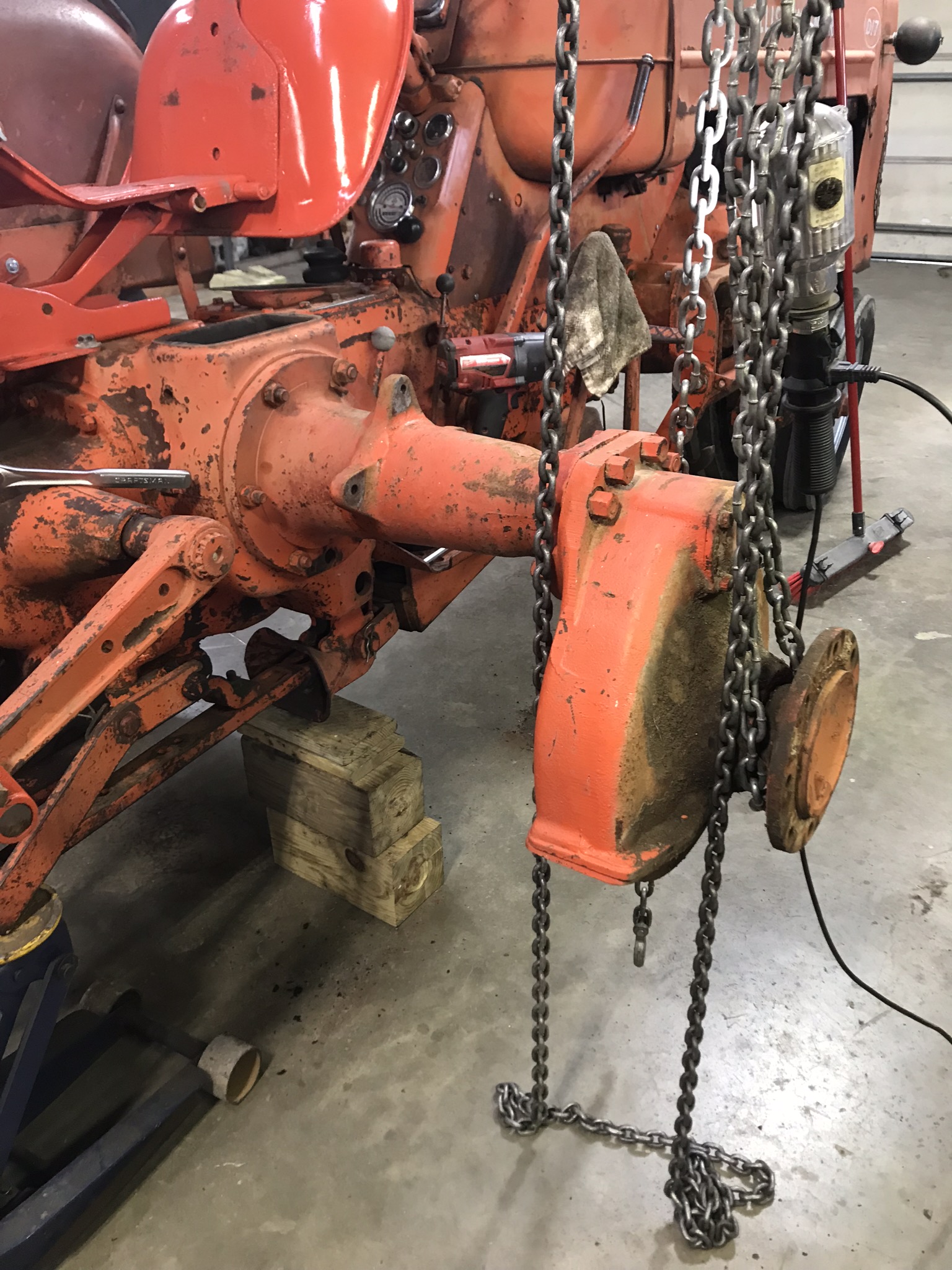

Right side brake drum had to be replaced. New brakes, pinion seals, axle seals, bull gear pan gaskets were all replaced. 2 day job for me and my buddy Mutt. Not a fun job but I have great brakes now!

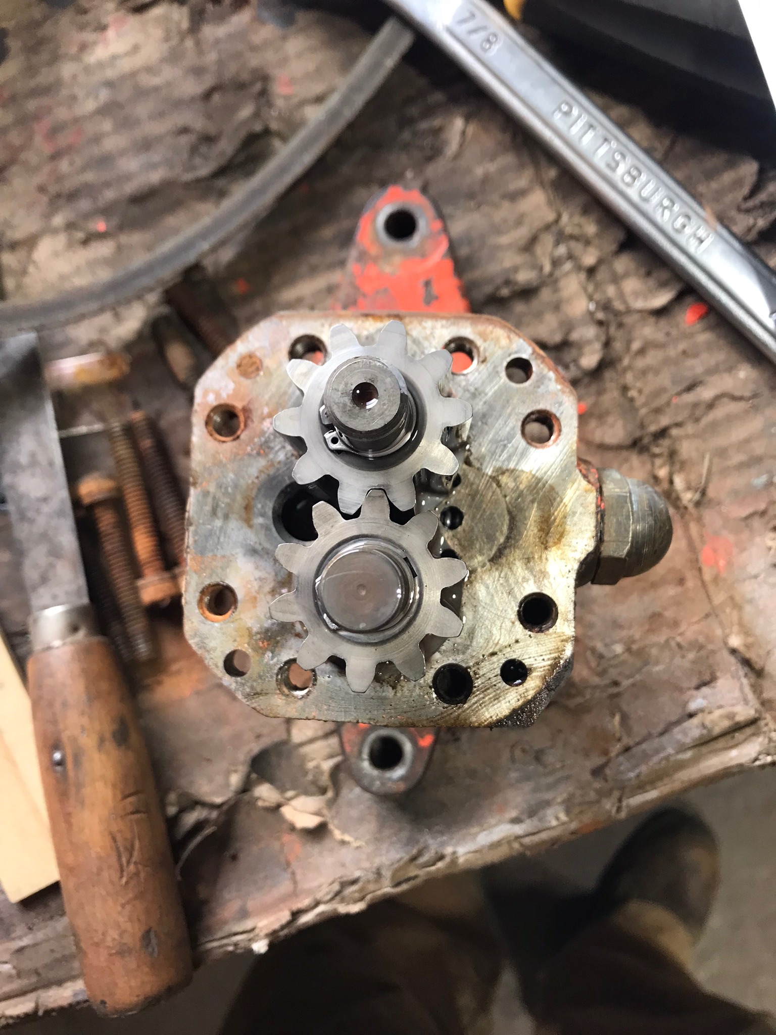

I’m sorry for the double picture. Power steering worked but not that well plus oil was dripping and running down the pedestal. Seamed like leaks everywhere. Power steering was erratic so I began by rebuilding the pump. Replaced seals and gaskets in the control valve body and the front support. The pump intake hose fitting that has a elbow that screws into the bolster was also leaking and would not tighten due to wear. NLA is a abbreviation I heard quite a bit. My local Carquest store came up with a solution that really does work well and still looks very similar to what came from the factory.
