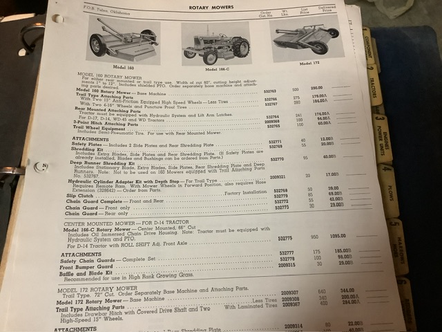

Post Options Post Options   Thanks (0) Thanks(0)   Quote Mikez Quote  Post ReplyReply Direct Link To This Post Posted: 13 Sep 2023 at 8:40pm
Not woods but when seen this post I remember seeing this price sheet with D14 belly mower
Edited by Mikez - 13 Sep 2023 at 8:42pm

Post Options Post Options   Thanks (0) Thanks(0)   Quote captaindana Quote  Post ReplyReply Direct Link To This Post Posted: 14 Sep 2023 at 5:26am
Wow!
