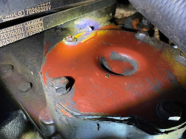

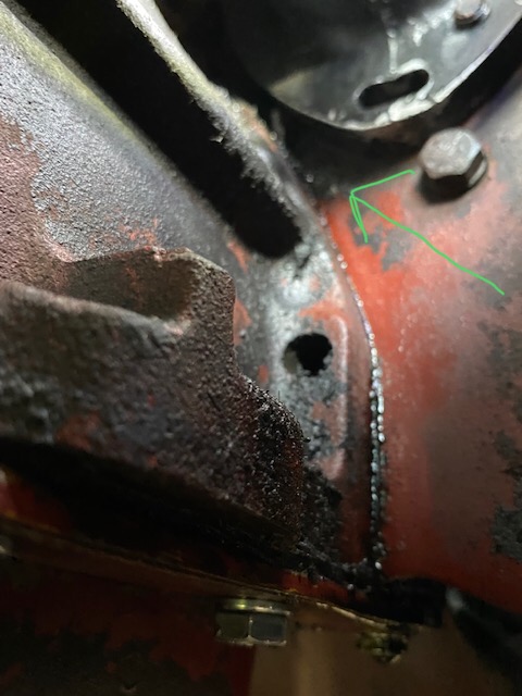

I’ve had this oil leak since I bought the tractor a year and a half ago. It comes down that crack where my green arrow is.
On the front side timing gear inspection cover it appears prior guy snapped off a fastener. I really can’t tell if that’s where the oil is coming from, but I am assuming with the big fan right there if it did leak, it would blow it back to where I see it. What do all of you experts think?

Gasket between the block and the front plate. Kind of a big job.

Looks like the dowel pin is missing too.

In your first pic, under the injection pump you can see an empty hole in the block ear. There should be a 1/2" line-up dowel in that hole and it has worked out and is GONE. This dowel is what positions the front engine plate and front timing cover onto the block to keep them centered and from ever moving around. The timing cover bolts then just squeeze things together. When the dowel is missing the injection pump can potentially seize due to misalignment to the timing gear train. Can happen when the front axle bottoms out when oscillating. Seen it before and it was manure loader related hanging on those side frames. A big repair to say the least. Don't make it worse by seizing an injection pump head too.

Since the dowel pin worked its way out, can you just put a locking agent on a new dowel pin and slide it in there ?

Might be worth a try to stick a new pin in clean hole with loctite. Nothing to lose.

The dowel pin must be press fit in block and push fit in front plate. Front plate needs replaced or rebuilt.                         MACK

I had a similar problem with a 426 in our 8050, front plate gasket failure. But my front plate was egg shaped around dowel pins. Took plate, front cover and dowels to a machine shop. He machined bushings in the front plate to keep dowels tight in front plate. No leaks for 2 years now. But yes it takes several service hours to repair. On the plus side, it's a good time to replace the rod and all but one cam bearings. Good luck.

I would think that, unless the machinist had a good front plate to measure from, being just a few thousands of an inch off, could make too much stress on the injections pump.

In theory, they should be able to use the front timing cover (aluminum cover) to get their hole measurements from, since the holes on it are concentric with many of the bolt holes and both dowel holes on the plate/block.  I'll find out one of these days.  I have the same issue on my 7000.  The frame rails just aren't quite stiff enough to hold things together once those dowel holes start to loosen up...
