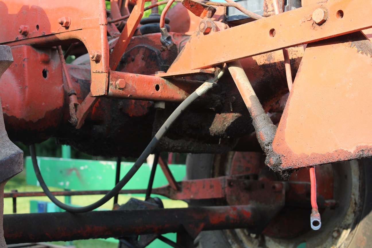

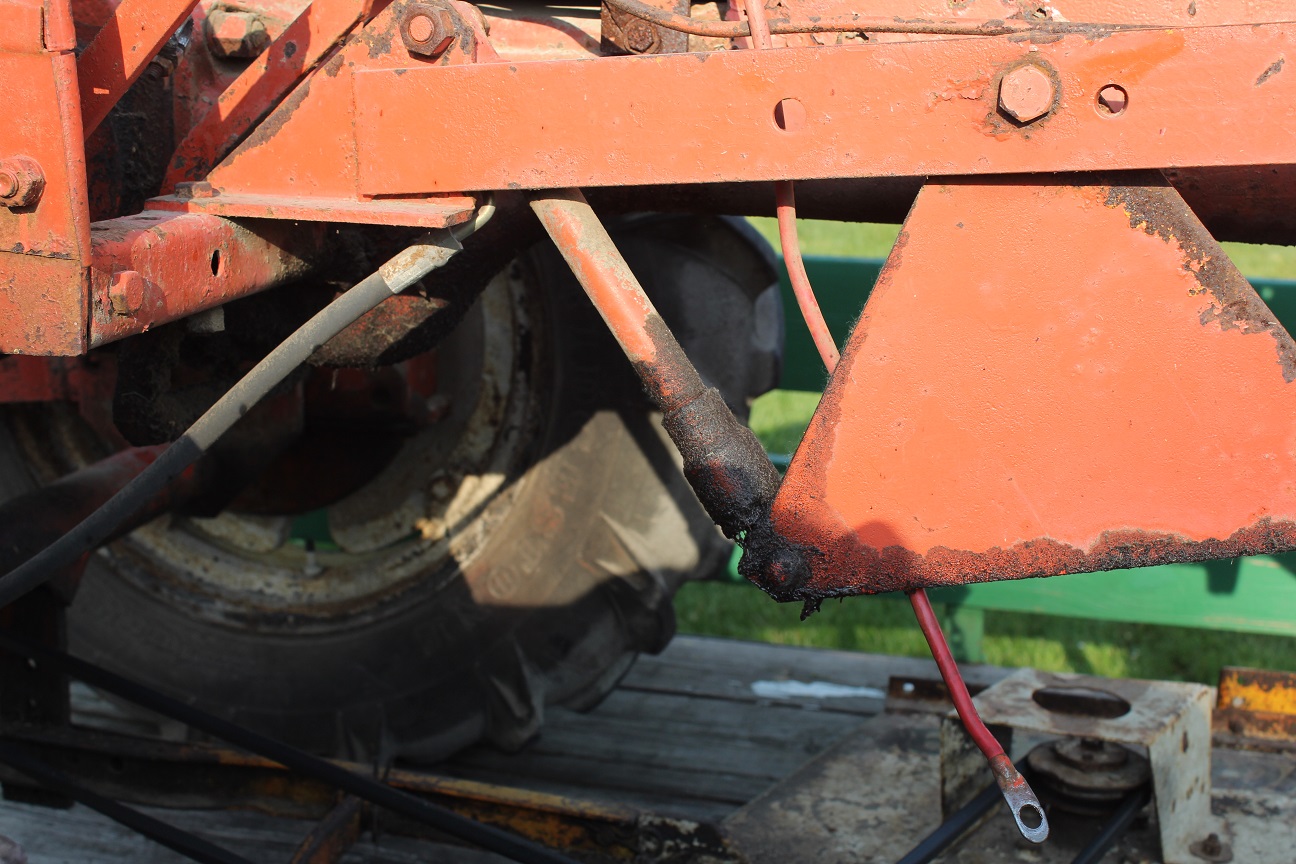

Post Options Post Options   Thanks (0) Thanks(0)   Quote pcheffernan Quote  Post ReplyReply Direct Link To This Post Posted: 03 Jun 2023 at 7:23am
ActuatorActuator.

Post Options Post Options   Thanks (0) Thanks(0)   Quote pcheffernan Quote  Post ReplyReply Direct Link To This Post Posted: 03 Jun 2023 at 7:25am
I just posted a couple photos of what my actuator looks like. I'm struggling trying to post photos and put text together as I'm new to this. Sorry.

Post Options Post Options   Thanks (0) Thanks(0)   Quote steve(ill) Quote  Post ReplyReply Direct Link To This Post Posted: 03 Jun 2023 at 8:50am
the CYLINDER is made by Allis Chalmers.. It is not part of the WOODS system.  You need packing for an ALLIS cylinder... You can use the old leather type, or you can use newer plastic VEE packing... Note that many of the ON LINE vendors list a larger size packing (WD 45 size) for the B and C... Yours has a smaller rod... check that ... 3/4  dia... Not 1-1/4 inch..
