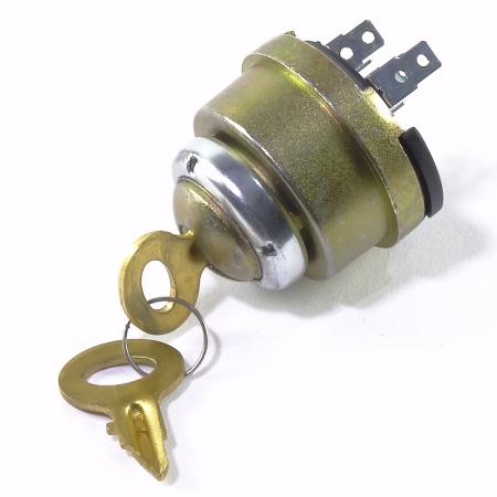

I'm not looking in the parts book right now, however the early D10/12 tractors used the Delco switch during production. This is the funny looking key that was also used on Oliver's for many years. I'm guessing that you are trying to retrofit the newer INDAK switch into a tractor that should have the Delco switch. Use the Delco switch and no adapter washer needed.
The Delco switch is available from Brillman.com  Part Number B5003-005 Currently $39.95. I may cost a few bucks more than the Indak switch. Because it is a better quality switch.

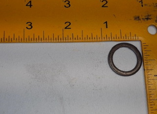

Is this the washer 227195
Edited by Mikez - 19 May 2023 at 12:40am
