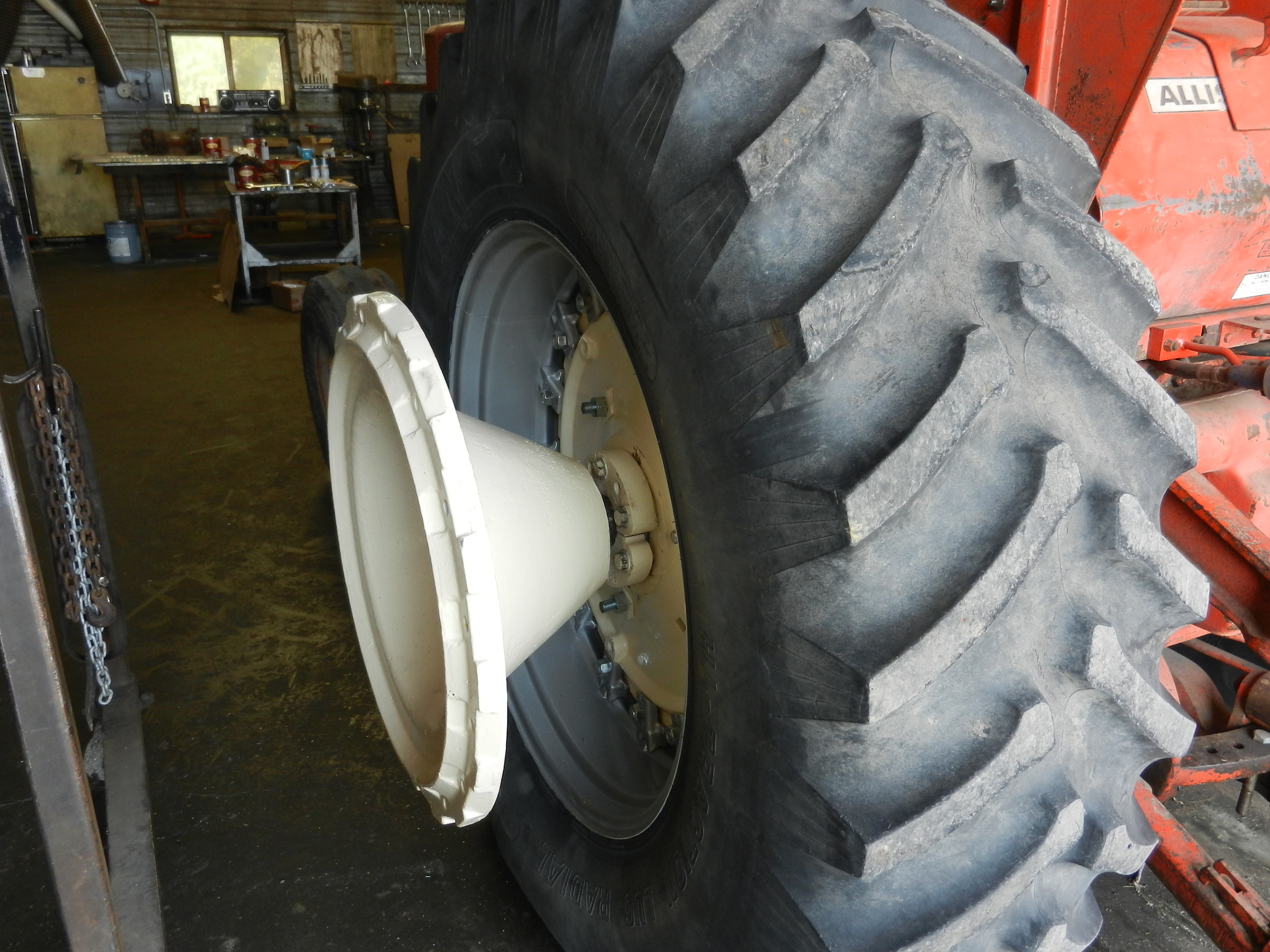

Post Options Post Options   Thanks (0) Thanks(0)   Quote Calvin Schmidt Quote  Post ReplyReply Direct Link To This Post Posted: 18 Jan 2023 at 8:45am
I have axle duals on my 220 with 20.8 R x 38 tires. Have exactly the same setup as Kevin has on his 8070 using "Mexican Hat" dished cast centers and power shift rims on the duals. All 220's have short axles

Calvin Schmidt View Drop Down

Post Options Post Options   Thanks (0) Thanks(0)   Quote Calvin Schmidt Quote  Post ReplyReply Direct Link To This Post Posted: 19 Jan 2023 at 9:15am
Location: Ontario Can.
Points: 4540
Post Options Post Options   Thanks (0) Thanks(0)   Quote Calvin Schmidt Quote  Post ReplyReply Direct Link To This Post Posted: 19 Jan 2023 at 10:19am
It is a tough 220. I call it a 220 XT. Not the original engine
