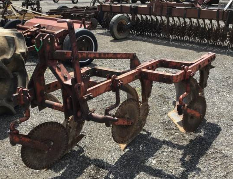

Is the lever on this plow to adjust depth?  If so, wouldnt that be a hard bugger to move?
Points: 22166
Post Options Post Options   Thanks (0) Thanks(0)   Quote DrAllis Quote  Post ReplyReply Direct Link To This Post Posted: 11 Jan 2023 at 6:51am
That lever steers the plow. If the plow wants to pull left or right, you use that lever to correct the draft.

So "winging" the plow is auto done by the nature of the bottom lift links being offest from each other?  Or is there an adjustment for that too?
Points: 22166
Post Options Post Options   Thanks (0) Thanks(0)   Quote DrAllis Quote  Post ReplyReply Direct Link To This Post Posted: 11 Jan 2023 at 8:02am
Side to side leveling is done with the cranks on your lift arms. What I see in the pictures looks like the landsides are worn out, which makes the plow pull to the left and causes the tractors nose to always want to pull towards plowed ground.

Tom, I would be interested in seeing more pictures of this plow. Curious what model it is.
Points: 22166
Post Options Post Options   Thanks (0) Thanks(0)   Quote DrAllis Quote  Post ReplyReply Direct Link To This Post Posted: 12 Jan 2023 at 10:00am
Plow pictured is a 73 model set up for 14 inch cut.
