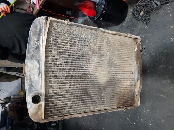

Post Options Post Options   Thanks (0) Thanks(0)   Quote Larry O F Quote  Post ReplyReply Direct Link To This Post Posted: 03 Dec 2022 at 11:39am
uploads/22264/radiator_2.jpg
Here is a picture of the radiator.

Post Options Post Options   Thanks (0) Thanks(0)   Quote DMiller Quote  Post ReplyReply Direct Link To This Post Posted: 03 Dec 2022 at 1:06pm
Not even for a G-b, that is a 7G series radiator,  G-b had squared off tanks top and bottom, BOLTED to core, same size and mount configuration essentially as a 7G.

Post Options Post Options   Thanks (0) Thanks(0)   Quote Larry O F Quote  Post ReplyReply Direct Link To This Post Posted: 03 Dec 2022 at 2:06pm
That is what I need a radiator for a 7gb track loader. This is the radiator I took of my 7gb track loader.

Post Options Post Options   Thanks (0) Thanks(0)   Quote Codger Quote  Post ReplyReply Direct Link To This Post Posted: 03 Dec 2022 at 3:40pm
That radiator is older than your machine and quite fragile from the looks of it. Soldered tanks too so kinda hard to adapt another used core to it. I'll pass the information and forward recommendations.

Post Options Post Options   Thanks (0) Thanks(0)   Quote DMiller Quote  Post ReplyReply Direct Link To This Post Posted: 03 Dec 2022 at 3:47pm
Had mine cleaned, both the Donor tractor and the one out of the original tractor, those are Soldered STEEL Tanks.  Bad coolant or not keeping up with additives and internal corrosion will destroy on inside out.

Post Options Post Options   Thanks (0) Thanks(0)   Quote Codger Quote  Post ReplyReply Direct Link To This Post Posted: 04 Dec 2022 at 6:29am
Would you PM me some close up photos of that core and the tank to core joining flanges?

Post Options Post Options   Thanks (0) Thanks(0)   Quote DMiller Quote  Post ReplyReply Direct Link To This Post Posted: 04 Dec 2022 at 6:04pm
Correct Radiator assembly is a Bolted Tank unit, Allis P/N 70675925.  If could find a used one, that could get away with a replacement Core and reuse tanks.  Every radiator shop around here wants NOTHING to do with Soldered Steel tank radiators.

Post Options Post Options   Thanks (0) Thanks(0)   Quote Larry O F Quote  Post ReplyReply Direct Link To This Post Posted: 04 Dec 2022 at 8:21pm
My tractor serial number is as follows 28815.My parts book shows the radiator to be part number 70667966 prior to SN 29390. After SN 29390 to be part number70675925. I don't know what the difference is between the two part numbers.
Points: 35266
Post Options Post Options   Thanks (0) Thanks(0)   Quote DMiller Quote  Post ReplyReply Direct Link To This Post Posted: 05 Dec 2022 at 4:07am
One is soldered tank, the other bolted. Both configured same dimensions one serviceable one not so much.

Post Options Post Options   Thanks (0) Thanks(0)   Quote DMiller Quote  Post ReplyReply Direct Link To This Post Posted: 05 Dec 2022 at 5:09am
Point made, early G-b series used a lot of the earlier Plain G series parts, i fall back to you need to locate the later radiator. Mount and dimensions exact but can recore simpler as bolted. I noted radiator shops are currently dropping soldered tank repairs as cannot deal with the EPA rules regarding those. Can unbolt tanks to repair or block corroded tubes or bad solder joints to tubes minimizing lead and acids exposures.

Post Options Post Options   Thanks (0) Thanks(0)   Quote Larry O F Quote  Post ReplyReply Direct Link To This Post Posted: 05 Dec 2022 at 10:31am
Either type would be acceptable. Mine is soldered and because it tore the bottom loose from the core they could not repair it without blocking off a number of tubes.  That would result in lost cooling.
