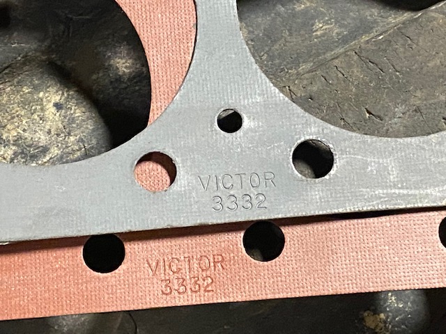

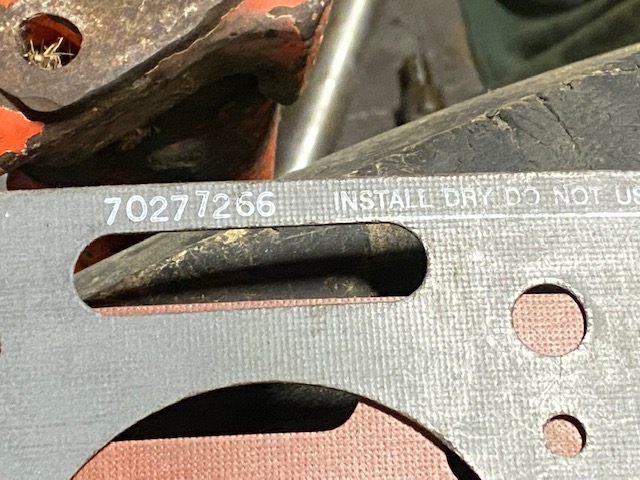

On first rebuild, we used the head gasket supplied by Reliance with rebuild kit. Don't remember brand, but it had a fire ring. Installed that using a spray on copper gasket sealer. Torqued down bolts, filled block with water and let it sit overnight. By next morning, had water dripping out of oil pan......so that head gasket failed.
Ordered a new one from local supplier, and when that showed up, it was a Victor 3332.....no fire ring. Meanwhile, found a NOS Fel-Pro with fire ring, installed that dry, as per instructions, and it held fine until recently when the valve failed and we took it down again.
Now need a new head gasket. We have the Victor 3332......no fire ring. In fact, two of them. One red.......one gray.
Does anyone know the number of the comparable Victor, with fire ring? And a source for it?

To get one with fire ring, I believe you have to go to the D14 head gasket. A-C # 227577 or 277276.

No, they are not the same. The D15 factory head gasket doesn't have the fire rings.

Installed the AGCO one(no fire rings) in my tractor during a fresh overhaul, installed it dry as stated on the gasket.  Leaked within the first year. Replaced with another AGCO gasket but put on a thin coat of permetex gasket eliminator.  Has held for 22 years, kicks out factory 46 HP on the dyno.

Have heard a nasty rumor that the gaskets AGCO currently sells is same as in Reliance overhaul kits. We tried that and it didn't last 24 hours before it leaked.
Local AGCO dealer didn't have one anyway, and if I heard what I think I heard him say, price was over 2X what Victor is from Amazon. Fire ring unknown.
We talked to Reliance about failed gasket and they gave us $83 credit for it. 2X the cost for something that doesn't work does not impress me much.
