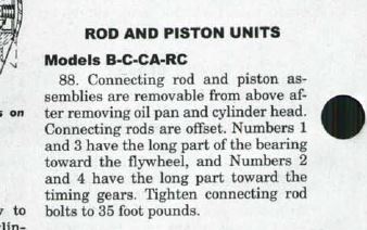

also note that the connecting rods dont all go in the same way.. Two face the cam and the other two the opposite way... Bearing on the rod is OFFSET one way to get clearance by the center Main Bearing.
#1 MAIN has a thrust built into the bearing.. You might check END SHAKE of the crank and make sure it is not excessive... suppose to be around .005 inch.
I kept them all facing the direction they were when the came out of the engine.  However I think the front one may have been in backwards.  All the pistons have a small notch in the skirt and on the rear three that notch was facing the front.  On the front piston it was facing the rear.  I don't know if that notch is supposed to be lined up in a specific direction(I know a similar notch matters on two cycle engines)
