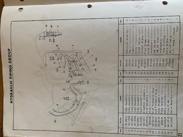

Ok.....Man you guys are making me work hard here!!!...Dug through our archives and library and did find this Garwood book. They did make a hydraulic blade set up for all the dozers at the time. Cal's right that the cable blades and units seem to be more popular then. Also as he says...the HYDRECO pump was the main player then.....the pump in your picture I'm sure is  a HYDRECO.  I'm also sure the whole hardnose assembly is Garwood with maybe some modifications.  The parts book of course does not mention HYDRECO by name.  If I get them posted right the last picture....albeit disappointing...does not show getting the yoke of the pulley.  I'll look at a HD 9 tractor tomorrow that might give us some help. Don't break anything ....cause yes..you should be able to build one.
CAL(KS) View Drop Down
Joined: 18 Sep 2009
Location: Chapman, KS
Points: 3804
Post Options Post Options   Thanks (0) Thanks(0)   Quote CAL(KS) Quote  Post ReplyReply Direct Link To This Post Posted: 17 Aug 2022 at 7:28am
Mel to the rescue.  Those are the books that are indispensable because unlike the tractor books, most can not be found online @ minnpar, and who knows how longs those will last.
