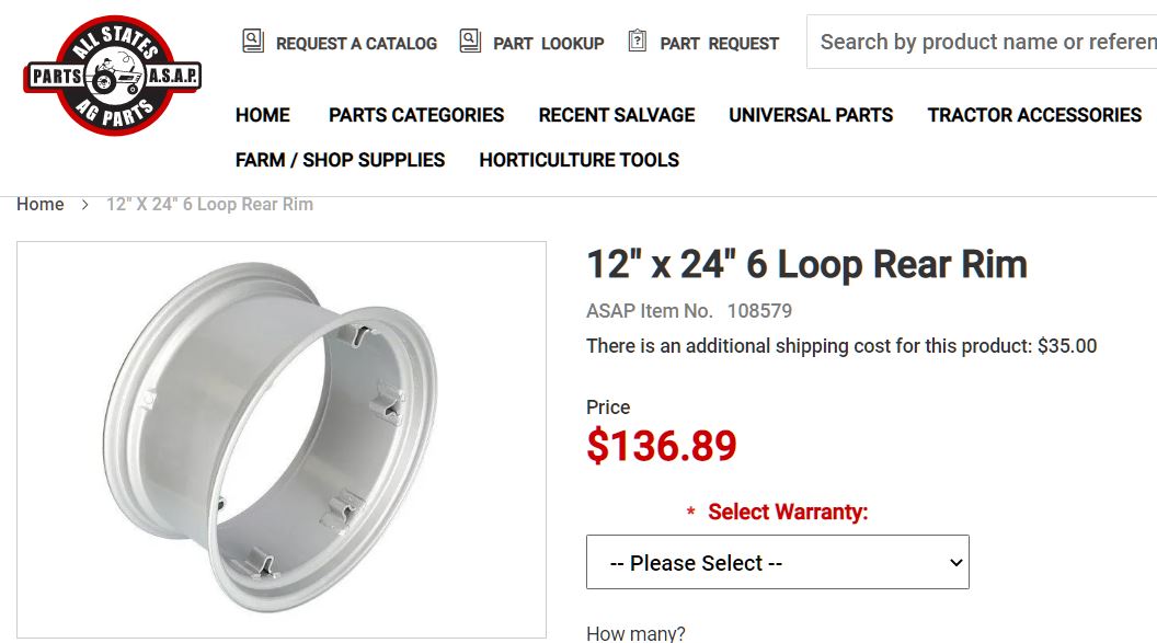

Charlie, would it be possible to use a 4 LOOP  , or modify a 6 loop to fit a D12 ? ... I know the 4 loops will fit the older B and C tractors.

Points: 90832
Post Options Post Options   Thanks (0) Thanks(0)   Quote steve(ill) Quote  Post ReplyReply Direct Link To This Post Posted: 26 Jul 2022 at 1:13pm
All State has the 6 loop rim... Cut off 4 of them, the other two will be OK... reinstall 2 of the 4 that were removed ???
Charlie175 View Drop Down
Location: Shenandoah, VA
Points: 6369
Post Options Post Options   Thanks (0) Thanks(0)   Quote Charlie175 Quote  Post ReplyReply Direct Link To This Post Posted: 26 Jul 2022 at 1:35pm
Do you know if someone makes the loops as a separate item? Then I could use a blank rim and install them as needed
Charlie
