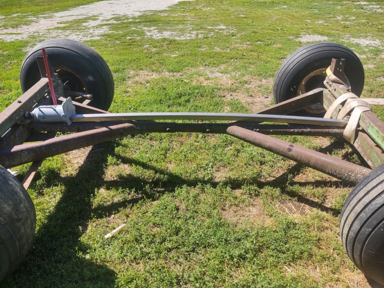

Not Allis equipment but I thought someone on here might have encountered this problem and have a trick to removing the pipe that connects the two halves.  20 ton jack and stainless steel cheater bar is not getting it done.   I also tried hooking tractor on each end but that broke the strap.  I have tapped it with a sledge hoping to break the rust free.   I am just trying to make another hay wagon.  Thanks for any ideas.

Put smaller bolts in it, to keep it from coming apart down the road.. Soak it with Kroil. Hook it to a vehicle and pull it over rough ground. Weigh on it will help it twist and star to move some, twisting it will help more than a straight line push. HTH Tracy

Get it on some uneven ground, like crossing a ditch on a 45 degree angle, and invite some fat cousins over to play on your new see-saw.  X2 on the kroil, may take heat (rosebud torch) and fat cousins...Wink

leave the jack on it... soak with oil... pickup one wheel with a loader to Twist it.

Since the bolsters look like they are in good shape, I would load some saw logs on it and drive across some dead furrows or across a swale, off the road or down a not-too-steep ditch into a field--anything to get that coupling pole to start to twist and turn and move.  This could be a patience builder until it breaks free.  R. Musgrave

Cut it into in middle, slide small pipe inside and bolt back together where you want it.                 MACK

Do you have the set screws out?

Thanks for all of the ideas.  I did remove the set screws and other screws but it is really rusty.  I soaked it with penetrating oil (didn't have any kroil though).  I drove it down the road although most of the roads around me are fairly smooth but I found some dips and bridges.  Didn't faze it though.  I also took the front loader and raised it with one tire but didn't faze it either.   I think this thing is really seized up from what I can tell.   I think I like the idea of cutting it in middle and redrilling holes.  I need to put a 7 foot pipe extension in it to make an 18 foot  hay wagon.  If I do that then I won't need as long as a piece of pipe.  2.5 inch pipe is crazy expensive now days.  I also found out some of the holes for the tire bolts are stripped on one hub so I have to use regular bolts.  Steering is a little tight too but I an working on loosening it.  I will report back after cutting it in half.
