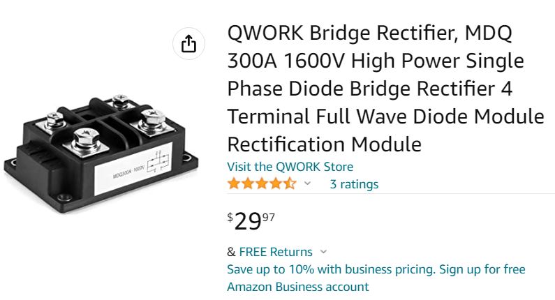

https://www.youtube.com/watch?v=_VL_ggERQjU

That rectifier shown above by Steve (ill) looks like a nice, easy option.

nella, i have not converted an AC machine, but have thought about trying it on an old BUZZBOX..... My daily machine is a AC/DC MILLER 200 amp..
Looking on  "THE NET" it appears most will use the combination DIODE set i posted above.. You need the 300 amp size or so... there are 100 amp and 200 amp models also.. surely the 100 amp would be minimal size.
It is a good idea to buy an aluminum heat sink and bolt to the back of the DIODE set to get rid of the heat.
The diode gives you a PULSE DC output.. You want a somewhat CONSTANT DC so one way to do that is to add a BIG CAPACITOR... Something in the 50 - 100,000 uf size rated at 50 -63 volt range....
Some of the sites talk about using a "CHOKE" which is a coil of welding lead around an iron core.... but some do not use that.
