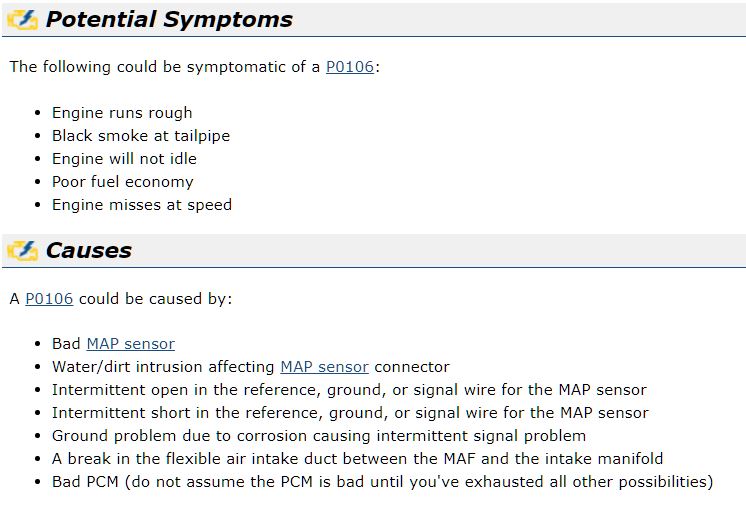

Post Options Post Options   Thanks (0) Thanks(0)   Quote steve(ill) Quote  Post ReplyReply Direct Link To This Post Posted: 14 May 2022 at 9:17am
Ii dont know what "CODE" was shown, but lets ASSUME it was P0106... this is the GENERIC answer... There could be SPECIFIC items related to a Chevy car..... changing the MAP sensor might work 50% of the time... but there COULD be other problems.
