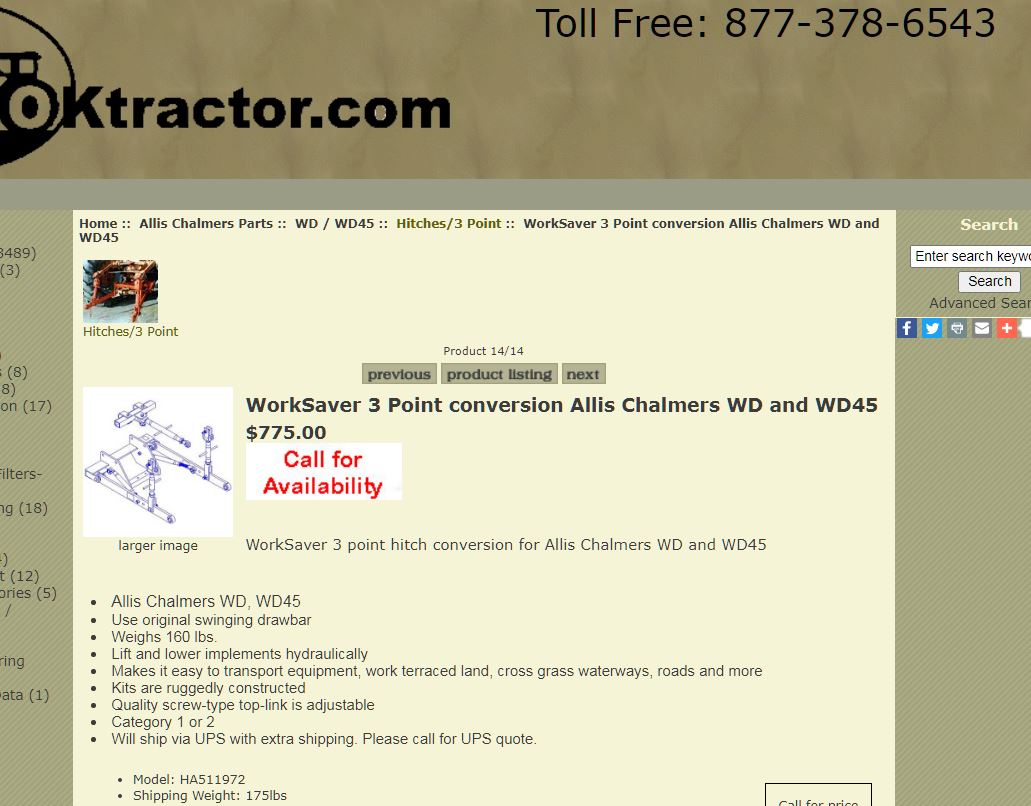

with all the ordering i do each day keeping parts  here and ones i sell  as soon as it  says  call for avaiblity  or low stock it means  you aint going to to get it this year or its substituded with some thing like it .  but really do not mind welding up my own like in the one picture only with sway blocks instead of the sway arms  but its allways nice to start with some pictures or measurements so that a guy doesnt have to spend so much time figuring out all the geomentry so that thing s operate good .    lets see some pictures  if any one has  time for some

worksaver no longer makes 3 point hitch kits... You go to their site and all gone.. but if you sneak in the back door you can find the "obsolete manual" for the WD45 and others.
https://www.worksaver.com/discontinued-product-manuals

thats what i gathered thats why i  am looking for some ones on a tractor "pictures" so i can build my own i like that design the best,  not many pictures on the internet
