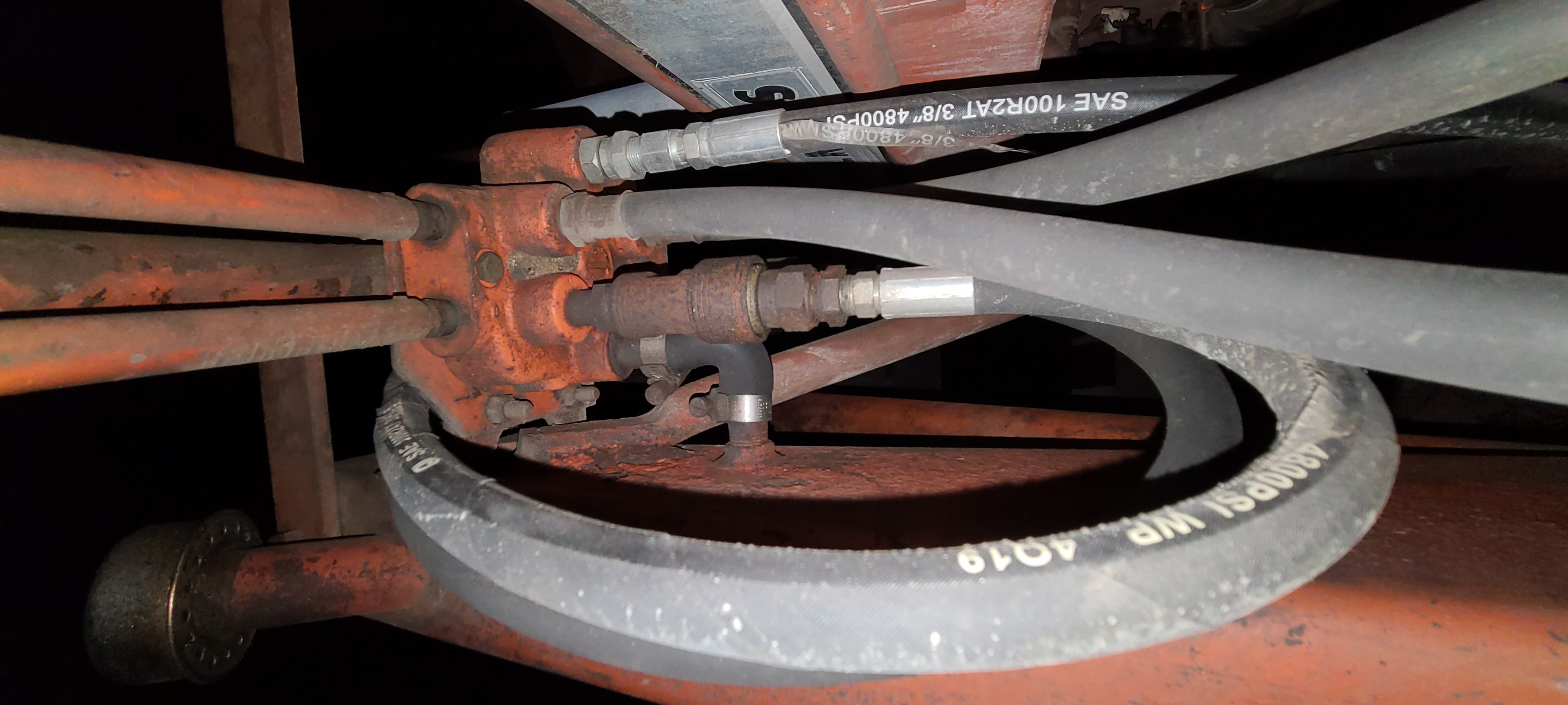

Post Options Post Options   Thanks (0) Thanks(0)   Quote WatsonWarrior Quote  Post ReplyReply Direct Link To This Post Posted: 20 Apr 2022 at 5:13am
WatsonWarrior View Drop Down
Joined: 19 Apr 2022
Location: Illinois
Points: 5

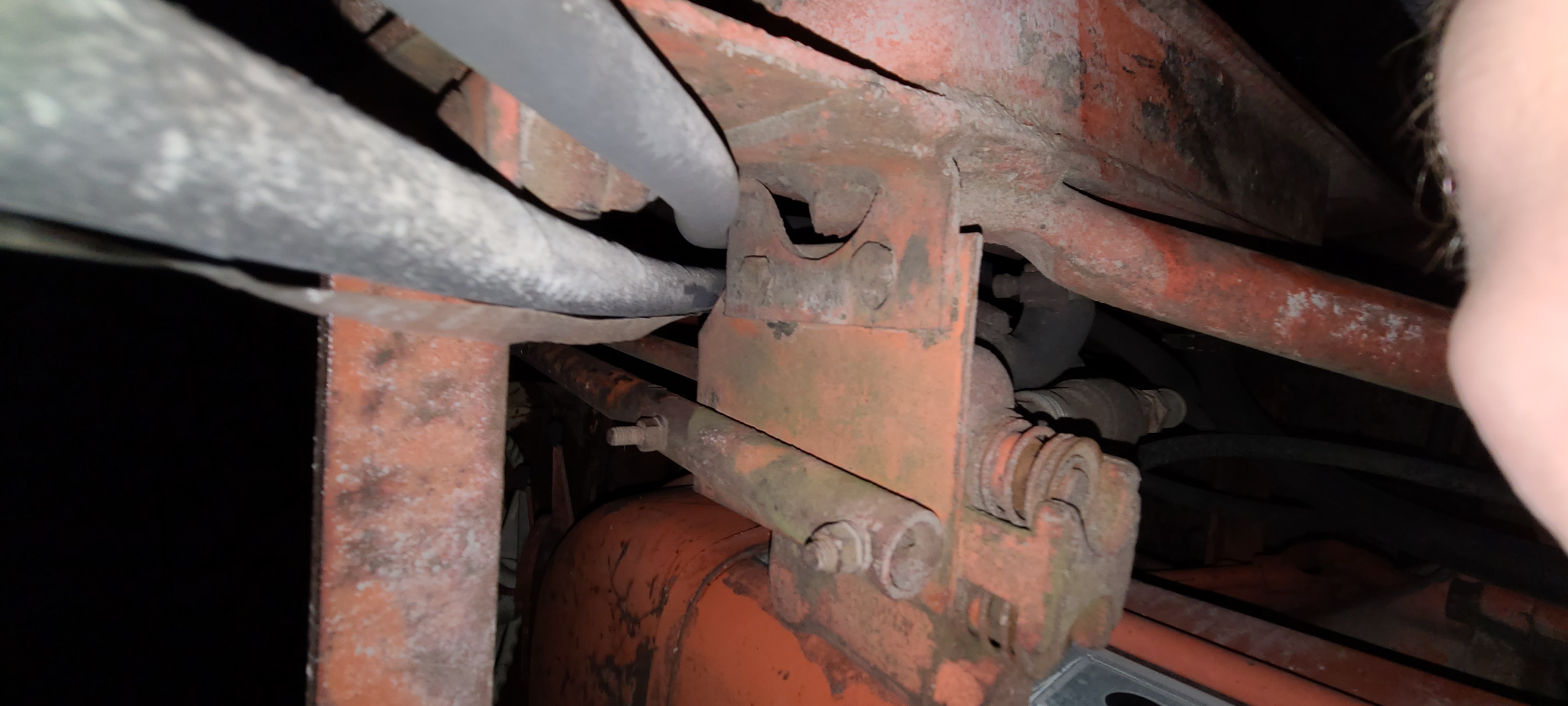

Post Options Post Options   Thanks (0) Thanks(0)   Quote WatsonWarrior Quote  Post ReplyReply Direct Link To This Post Posted: 20 Apr 2022 at 5:14am
I am not sure why the first one posted. I made the second two smaller...I posted because I have no idea about the hydraulic system type....
Points: 22834
Post Options Post Options   Thanks (1) Thanks(1)   Quote DrAllis Quote  Post ReplyReply Direct Link To This Post Posted: 20 Apr 2022 at 6:29am
Your loader is a 2000 to 2,200 psi system. Nothing to do with the rear outlet on the tractor.
