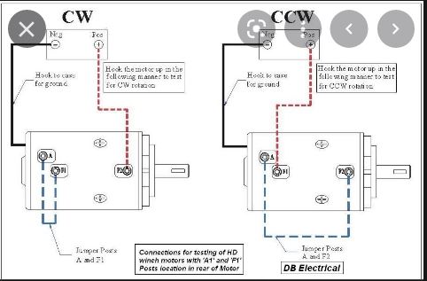

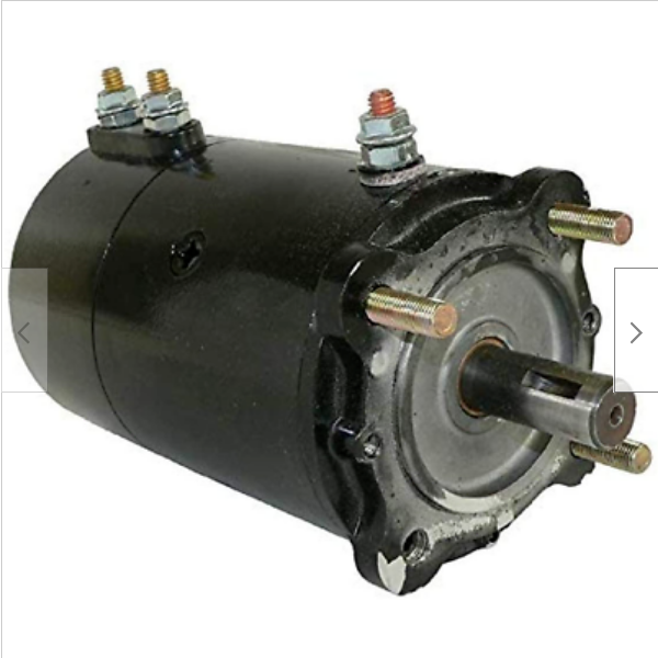

 The second one is a 9000# Ramsey that I was gonna rob the motor for use on a 12,000 # Pierce I rebuilt for my car hauler trailer but the Ramsey motor does not have any wires nor controller hooked up on the motor. The motor has 3 bolt connectors across the top but I have No idea what to where,,,,?
 I'ma try to post a pic of the terminals ,,see if someone can chime in,,,,Clap
Points: 90999
Post Options Post Options   Thanks (0) Thanks(0)   Quote steve(ill) Quote  Post ReplyReply Direct Link To This Post Posted: 20 Mar 2022 at 8:18pm

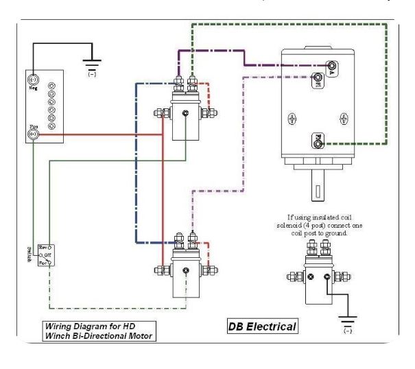

Joe... the three terminals are to make it run forward and reverse... Below are two diagrams.. one is how to connect it with two SOLENOIDS for permanent installation... the other shows a couple JUMPERS you and use to TEST to make sure it works..... Hopefully there are a couple numbers or letters STAMPED in the motor case.
Points: 90999
Post Options Post Options   Thanks (0) Thanks(0)   Quote steve(ill) Quote  Post ReplyReply Direct Link To This Post Posted: 20 Mar 2022 at 8:20pm
There show the terminals as A and F1, F2.... POWER goes to either F1 or F2... the OTHER F(.) jumpers to the A .... the case is grounded.
