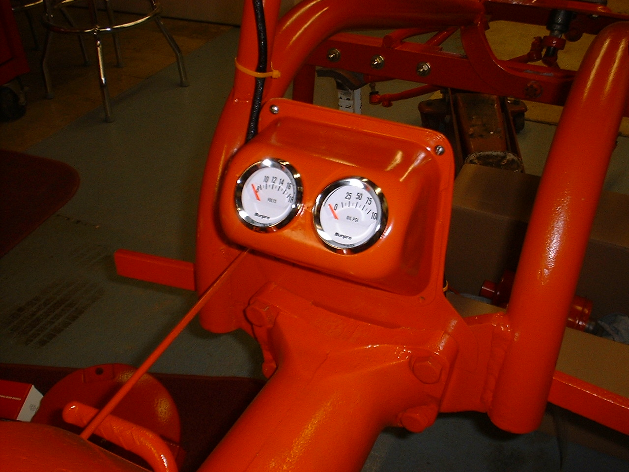

Post Options Post Options   Thanks (0) Thanks(0)   Quote Steve in NJ Quote  Post ReplyReply Direct Link To This Post Posted: 09 Mar 2022 at 8:20am
Here was my remedy for that. Ya just havta' improvise that's all...
