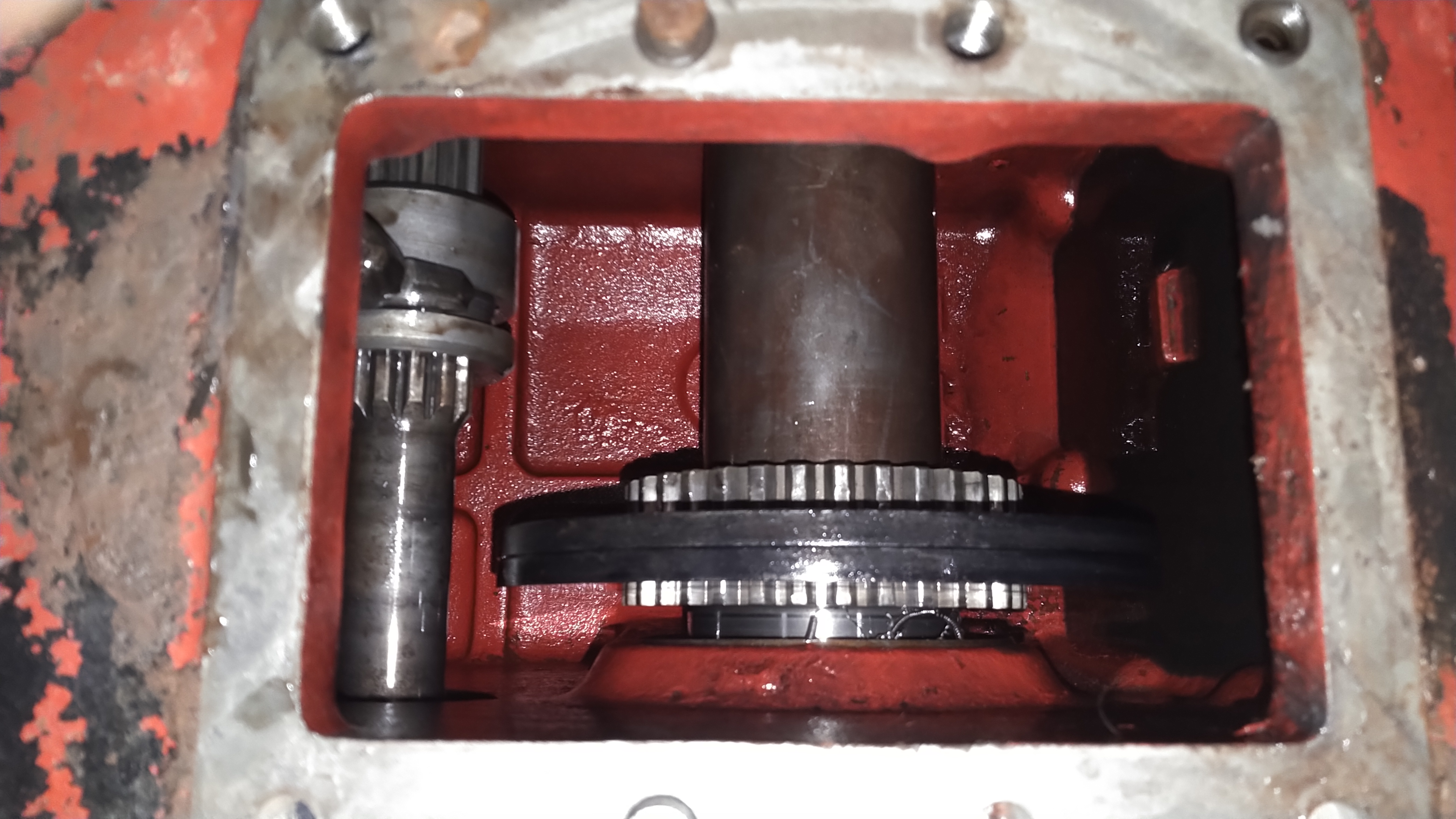

Post Options Post Options   Thanks (0) Thanks(0)   Quote ssefick Quote  Post ReplyReply Direct Link To This Post Posted: 26 Feb 2022 at 8:18pm
This is a picture of the inside after the parking break cover comes off. I wanted to post this in case someone else wants to see this at some point in the future.
The parking break assembly is tricky to put back in.
The parking break ok ever does not move very much. Is that normal?

Post Options Post Options   Thanks (0) Thanks(0)   Quote AC720Man Quote  Post ReplyReply Direct Link To This Post Posted: 26 Feb 2022 at 8:39pm
Thanks for posting that picture. Always wanted to know what it looked like inside, thankfully we have never had to open it to see. I was interested in a really nice 6060 that a local farmer and friend had for sale. I found out that they had loaned the tractor to someone whom forgot to release the hand brake. Yeah I know, big red light on the dash should have prevented him from leaving it pulled. Regardless of what happed I wonder what damages it caused and became gun shy to what damage it may have done. They were asking $9k for a otherwise very nice barn kept 4,000 hr 6060. Not sure how hard that repair would have been.

Post Options Post Options   Thanks (0) Thanks(0)   Quote ssefick Quote  Post ReplyReply Direct Link To This Post Posted: 27 Feb 2022 at 6:30am
Sorry, yes the coupler was laying dead center bottom of that bay.
I moved the lever until I could get the paddle back in, put the paddle back into the pto coupler, tested a couple of times, and put the parking break back on.
I will fill back up today.

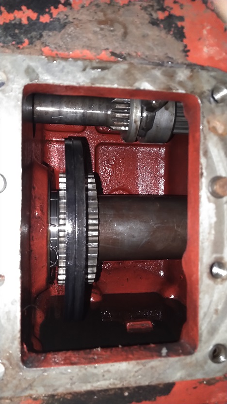

Post Options Post Options   Thanks (0) Thanks(0)   Quote Dave(inMA) Quote  Post ReplyReply Direct Link To This Post Posted: 27 Feb 2022 at 10:48am
Here's a resized image....easier to view.

Post Options Post Options   Thanks (0) Thanks(0)   Quote ssefick Quote  Post ReplyReply Direct Link To This Post Posted: 28 Feb 2022 at 6:19pm
Thanks for the resized picture.
The pto works now. I now need to adjust the pto clutch as it does not seem to be doing a thing.
On a positive note the parking brake works now.
