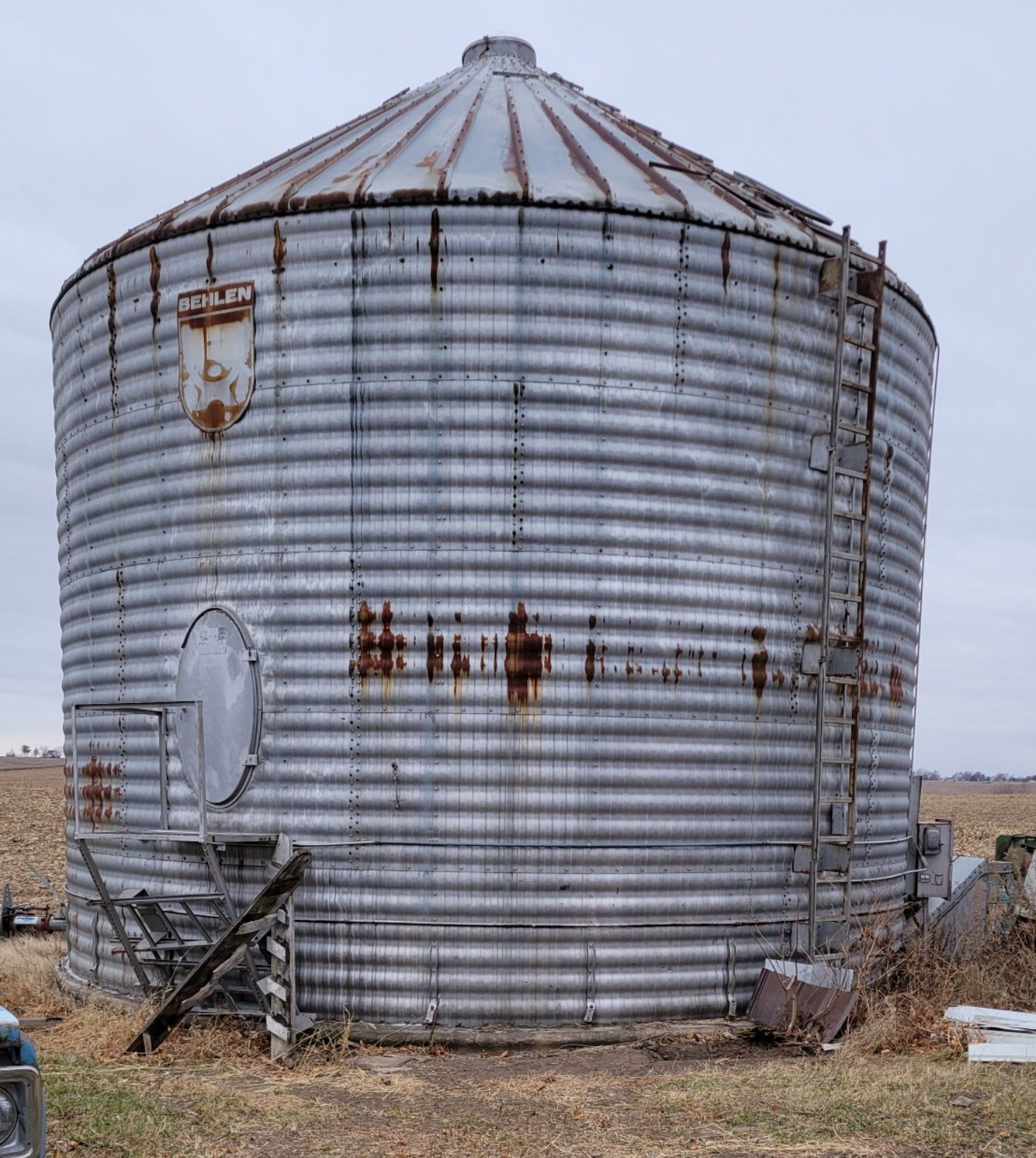

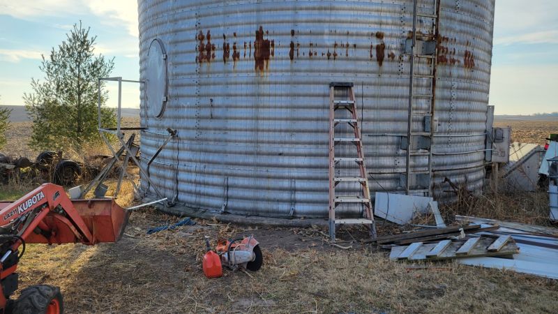

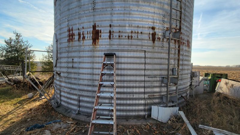

So here's a new flavor of "Shop Talk".  I've been considering this for quite some time, and a variety of circumstances prevented me from making this move, but opportunity and circumstance presented itself, and I jumped in...
INterestingly enough, I had very little to go on... I'm certain other guys have done this, but the number of detailed writeups is basically nil.

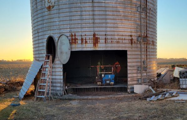

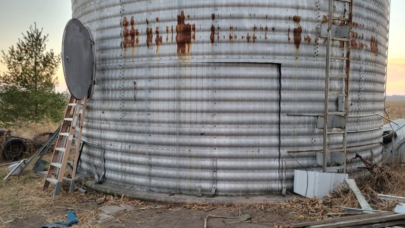

I have a grain-drying bin that is no longer economical to continue using for grain drying.  It's a Behlen bin, was built around 1963 or so.  It is 27ft in diameter, 20ft tall side walls (5 rings) and about another four feet to the top of the crown.  It has four oval-shaped hatches in the top  It was fitted with a louvered drying floor on wire zig-zag risers, a 10hp blower and propane burner.  There's an extraction auger to withdraw the contents, a sweep-auger to push contents towards the extraction auger.  Hanging from the ceiling is a twin-auger stirrator, and up top is a Scattergrain receiving spinner.  The access door is oval, center elevated about 7ft above the slab.
The bin has a 100A service fed from my main property utility pole, and there's a disconnected and capped, but still intact 1" liquid propane line going to my tank farm.
The access stairway is shot, and from the outside, it shows all the typical corrosion gremlins.  Most of the bottom ring is in surprisingly good condition, with exception of the area immediately surrounding the drying blower duct... there's some missing metal in that area, and the gap is one of many reasons why it was retired from duty.
It DOES, however, have good structural integrity otherwise, the concrete floor appeared to be uncracked, and it is sufficient in size to serve as a automotive and tractor workshop area.

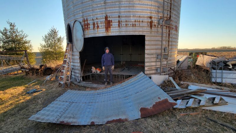

Now, when a guy does this kind of thing, it's important to get stuff out of the way.  I found that out... after I did a bunch of the work, because I hadn't done this before, and didn't see anyone else's instructions on it... LOL
But here it is, getting introduced to the Stihl TS-4xx Cutquik, with an abrasive blade:
DaveKamp View Drop Down
Joined: 12 Apr 2010
Location: LeClaire, Ia
Points: 6126
Post Options Post Options   Thanks (0) Thanks(0)   Quote DaveKamp Quote  Post ReplyReply Direct Link To This Post Posted: 23 Jan 2022 at 1:50am
And a little persuasion...
And some combined force between my son and I:
Now, for darned little of this, did I actually have any help... Nick was home over Christmas Break, and had a few minutes to help me, other than that, I was on my own...

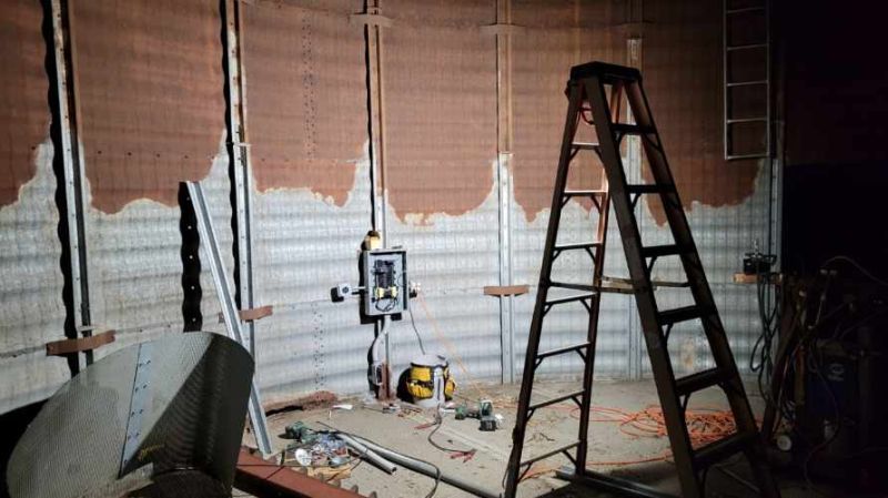

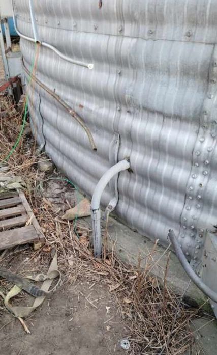

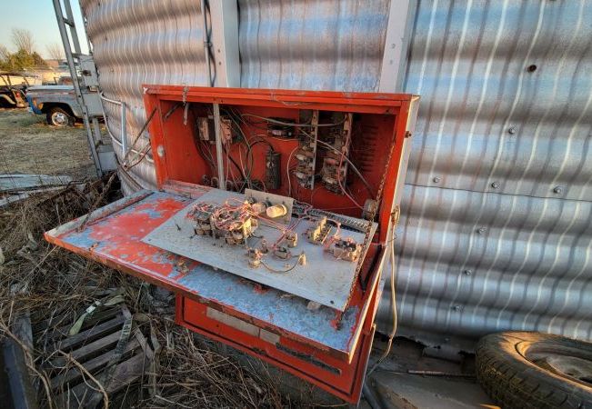

Next, get it fitted up with electricity, because daylight is darned short up here, and temperature ain't warm...
Here's the old drying controls.  I disconnected it's 100A main (after locking out the feeder from the main  pole) unthreaded the conduit, then lifted the cabinet off.
Then I re-piped the conduit into the bin with Schedule 80 PVC:

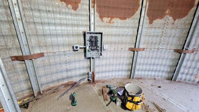

Then it was time to preassemble a breaker panel with two receptacle plugs (a 120v quad, and a 240/50A)...
and then hook it up:

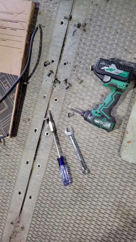

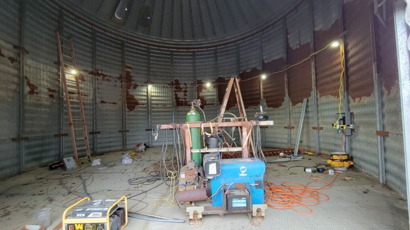

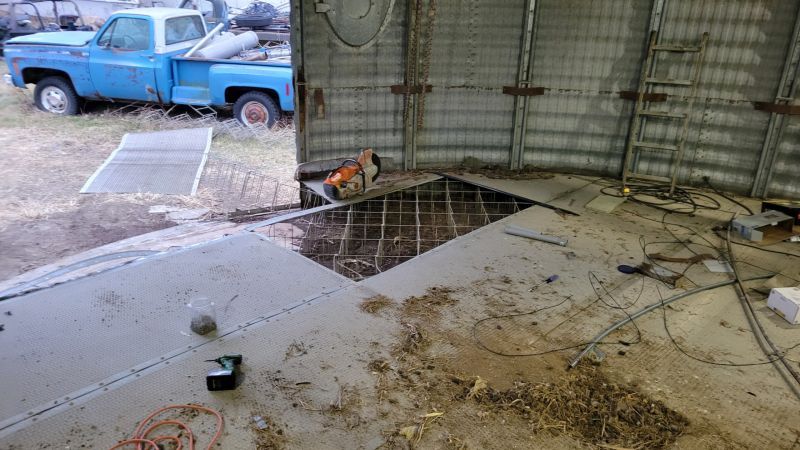

Next, is to start removing the grain-drying floor.

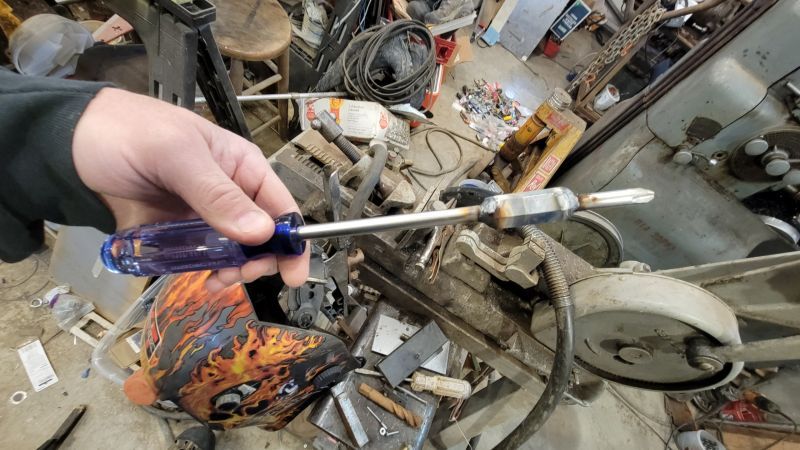

It takes a special screwdriver to take out all the metal... a #4 phillips, but with tool flats...
As you can see from the discoloration, I just welded a coupling nut to the shank... with an adjustable wrench on this one, taking out the screws is easy.  I broke them loose with this, then zipped 'em out with a 1/4" impact driver.

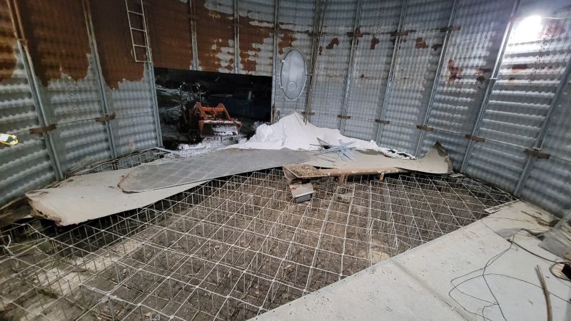

Pulling out the zillion screws holding the sheeting down was somewhat tedious.  I used the big screwdriver with an open-end wrench to break them loose, then used my impact driver to back them rest of the way out, and a bucket for all the fasteners.  They're big sheet-metal screws, and beneath the seam, is a strip of sheet metal about 4ft long, so I've got lots of strips to go with this perforated sheeting...
And while I was working away, we got a little snow...
But with daylight, I was able to drag most of the sheets out.  They're somewhat of a bear to wrestle, as the edges along the radius are fixed to the wall with tiny rusted-out sheet metal screws and fine wire mesh, those screws don't back out, the mesh has to be ripped off.  Once pulled out, the remains of the screws snag on the wire support.

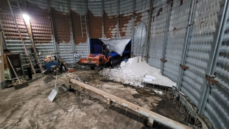

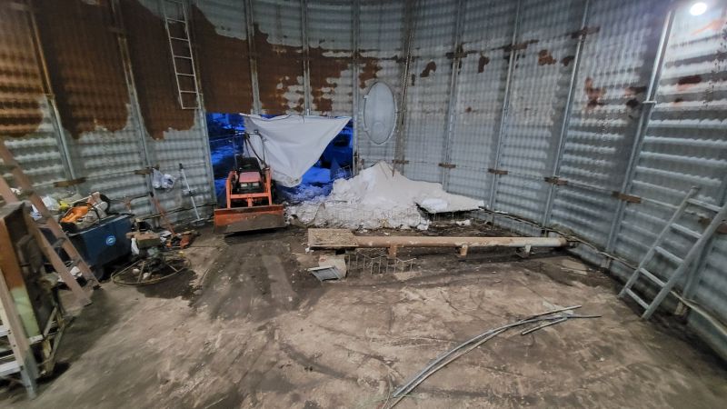

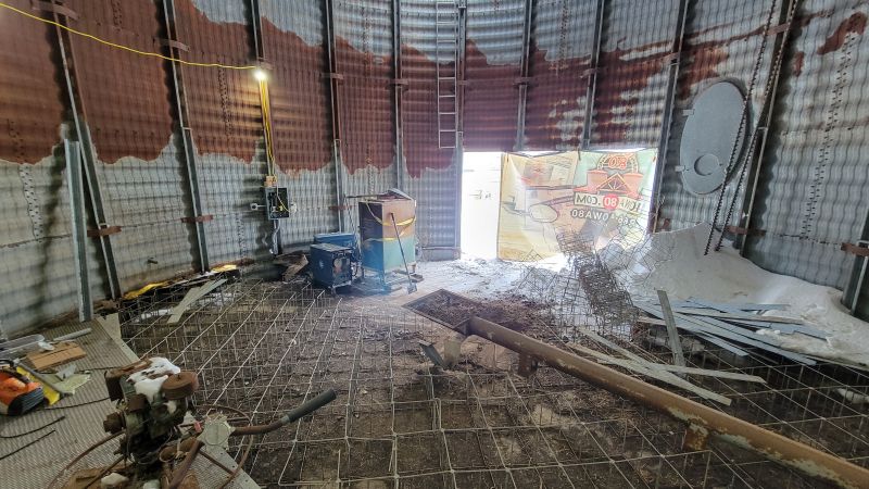

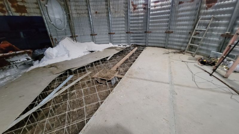

Eventually, it's clear enough to make other things happen.  The wire supports are clipped together at the top by little metal straps.  I found the best way to disengage those clips, is with a 1-1/4" wrench about 20" long... just hook between the sides, and pry down, the clip deforms and releases (mostly.... usually...)  and sometimes, it leaves at an enthusiastic velocity... straight up...
Now, bein's that there was lots of snow showing up, I scrambled to move several things that either needed to be in this space for future OR... needed to be out of my way somewhere else, to get this done.  The power trowel and welding supplies being in the latter category, the woodburning furnace being in the former.  More on them later.  I'm gradually working my way towards the far side, pulling sheet, unclipping wire.. and working around the extraction auger blocking the middle of the floor...
And this part is kinda like eating an elephant... one bite at a time...
Joined: 12 Apr 2010
Points: 6126
Post Options Post Options   Thanks (0) Thanks(0)   Quote DaveKamp Quote  Post ReplyReply Direct Link To This Post Posted: 23 Jan 2022 at 8:58am
The wire is piling up, because my access from outside is somewhat arctic in landscape.
But at this point, I DID find a lovely piece of material and some clamps to cover most of that big hole to keep the snow on the other side (sorta).
At this point, you'll notice that the woodburning furnace is now in a general location where the dryer ductwork comes in.  There's electricity conveniently near, and a concrete pad out there on the other side of the tin wall, more on that later... but for now, if I can get this old bugger to host a fire, it should make my work here more tolerable...

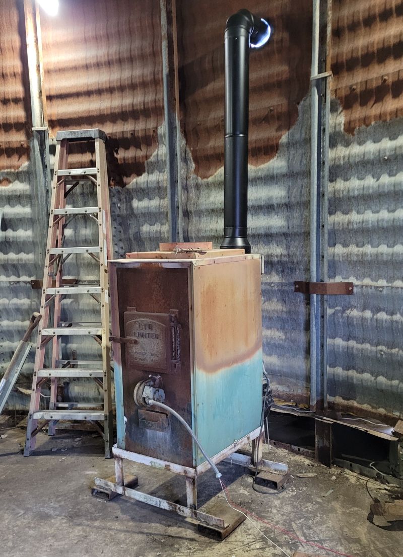

Here's the furnace:
It's nothing particularly special... I acquired it at my favorite price from a friend who bought a house that it was in... and his insurance company didn't like it.  My outlay was  a half-our each way, and time, tools, and muscle required to extract it from the basement of a victorian-era river captain's house...
(which I find quite amusing, because the house had a functional coal chute feeding the coal room next to the furnace room that housed the then-state-of-the-art gravity furnace... that burned...   wood and coal... with only two things about this one being different... this one is square, and has both a forced air blower (rather than just convection) and an electric blower for induction air)
It seemed a daunting and dangerous task for most, I extracted it with an appliance dolly, a strap-type come-along, and two pieces of 2x4 screwed togeter, with carpet scrap stapled tight around it...  it came right up the stairs, all by myself... no prob.  I made the steel frame beneath 1) so I could move it around with pallet forks and 2) so that I wouldn't have to bend over to stoke or clean it.
It had been sitting for a while, so I DID have to take apart the blowers, oil the motors, and break the stuck shafts free 'till they'd spin up and motor on their own... and currently the control scheme is 'plug it in'...  but I'll get to that later.

With the paint burned off I can understand the Insurance Company stand.
I have installed furnaces part time for many years, and was licensed to do so.

The paint burn wasn't their doing.  It was still shiny new when I got it... it sat for about six months in my pole barn, and a neighbor needed some heat in one of his buildings for the winter.  I'm not certain what he fed it, but I don't think he had the blowers plugged in when he did.

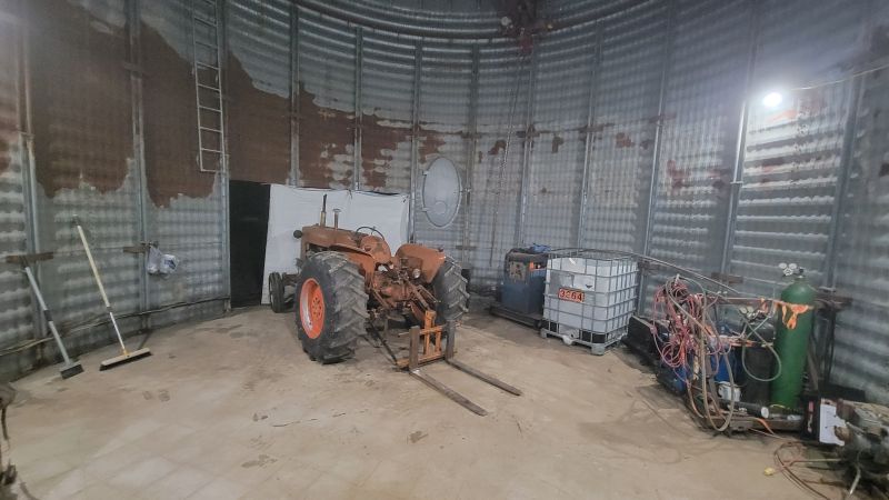

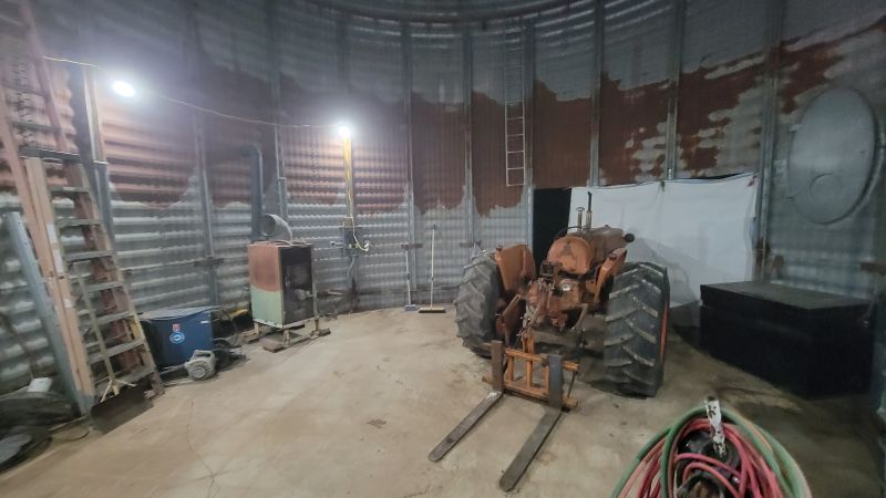

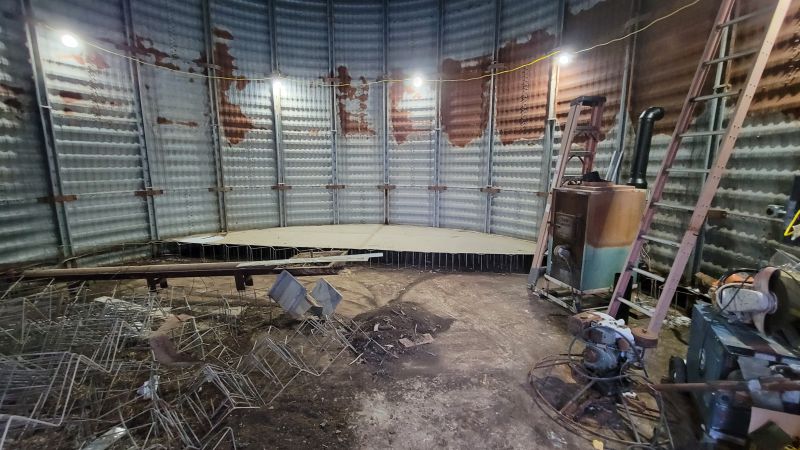

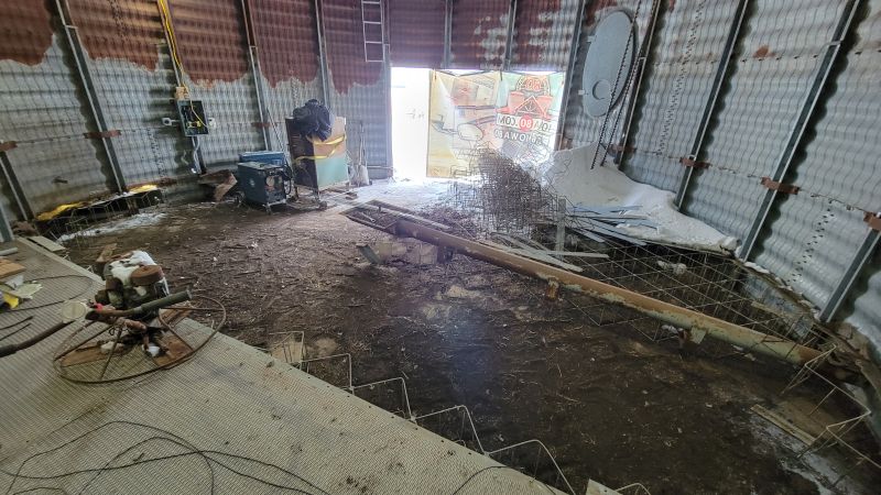

So, after a couple of weekends of grunty-work, and a few hours of this, that, and the other thing, it picked up rapidly this weekend, and all came together quickly.  I even got my big TIG moved out of the heated garage and into the bin (need space in the garage!) and decided that since the D17 did the hard work, and the floor space was open, there's no reason to make her sleep outside tonight...
Now if I can get the Hyster started, I'll lift the combine tires/wheels unloaded from the trailer, and set 'em in here, get the WD ready to move in, so it can get fitted with some new shoes...  (after I replace the U-joints in my daughter's car)
