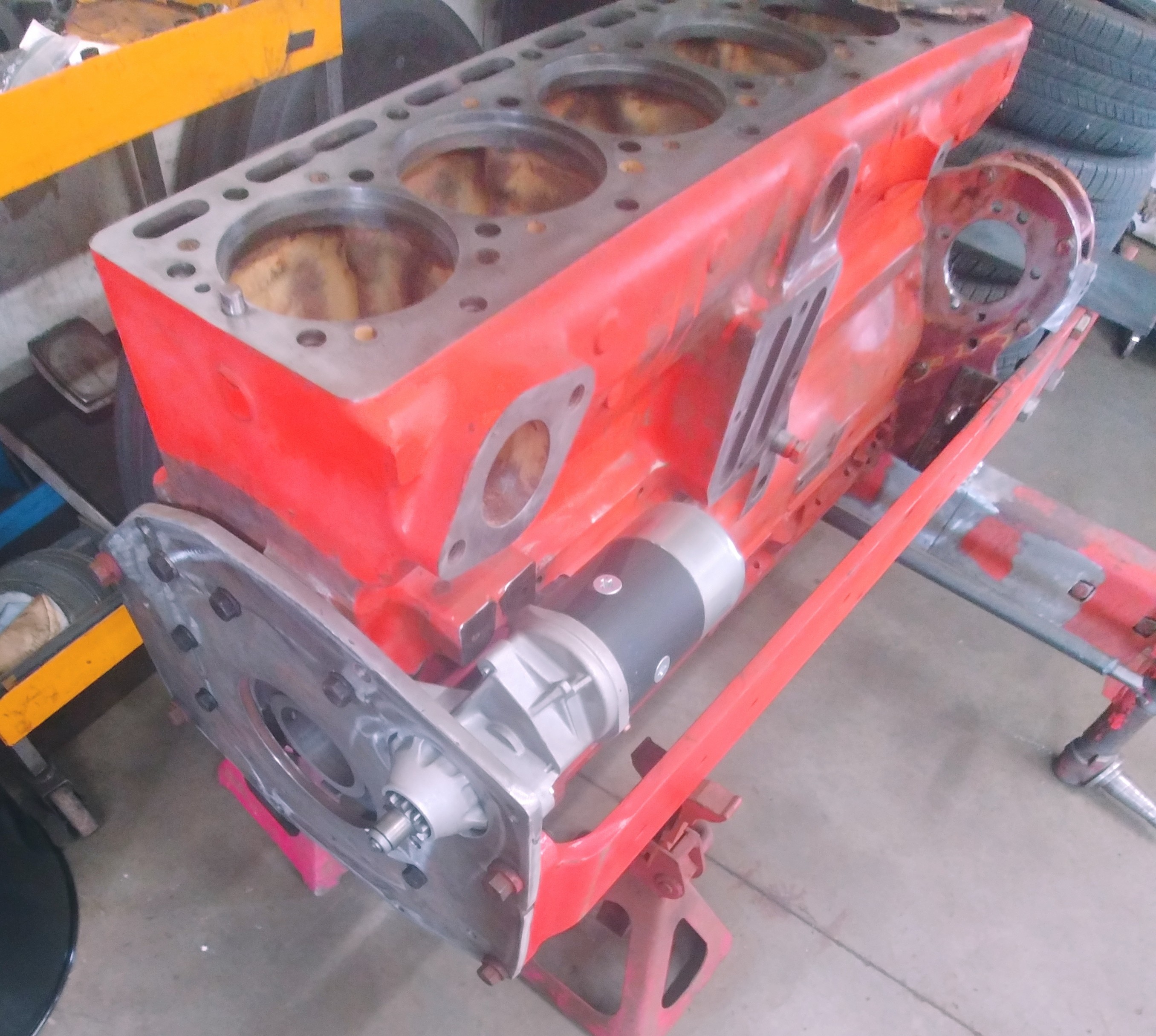

[IMG]

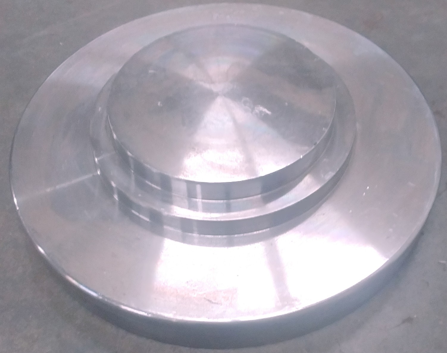

Post Options Post Options   Thanks (0) Thanks(0)   Quote goomer Quote  Post ReplyReply Direct Link To This Post Posted: 26 Dec 2021 at 9:32pm
My centering device to lay both back plates on
Points: 8428
Post Options Post Options   Thanks (0) Thanks(0)   Quote DougG Quote  Post ReplyReply Direct Link To This Post Posted: 27 Dec 2021 at 5:38pm
Dang Goomer you got it going on there ! Nice
