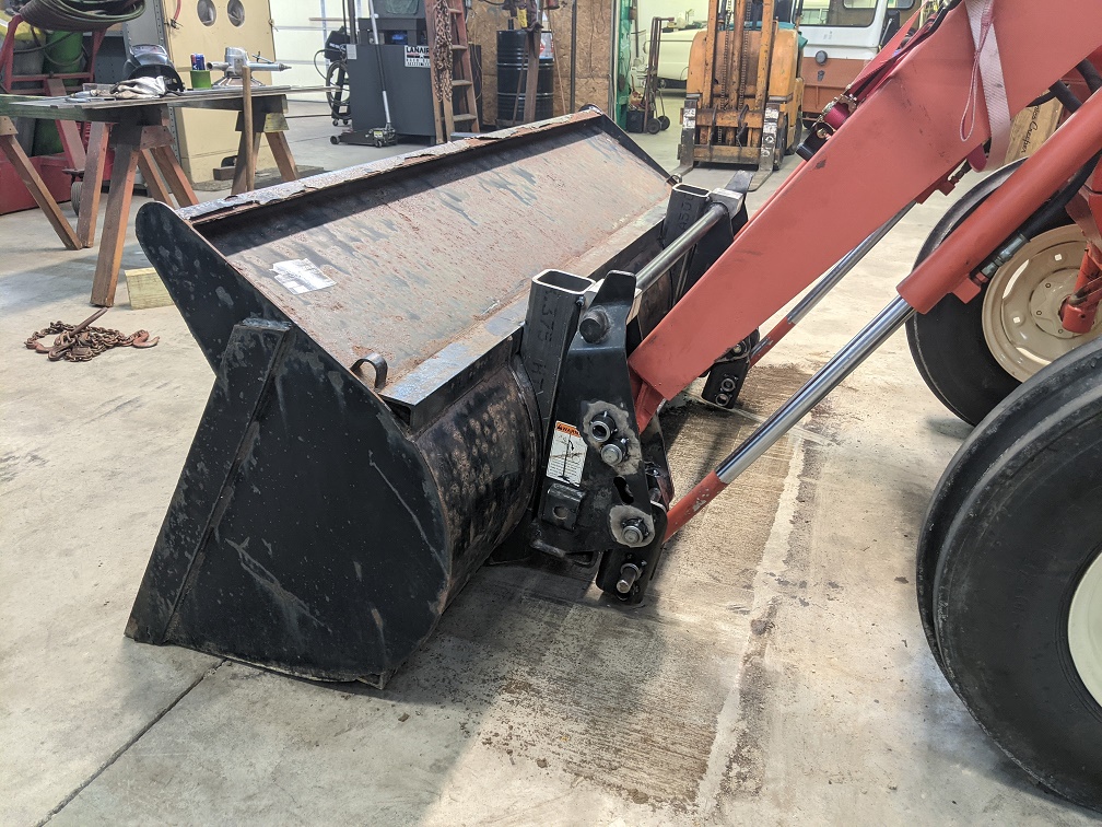

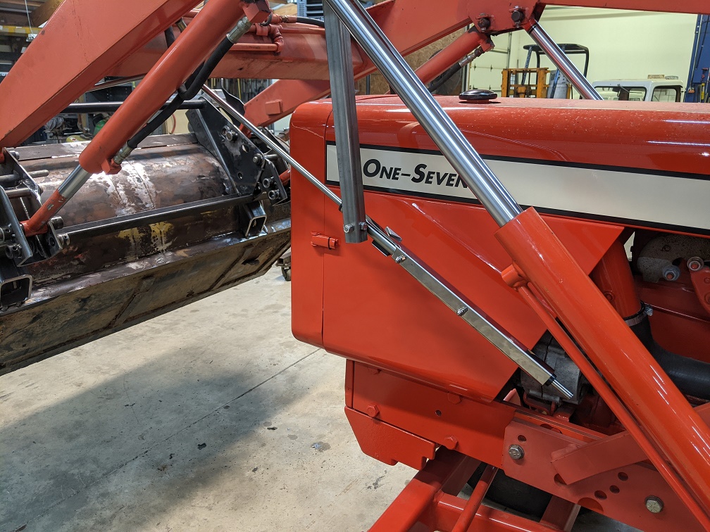

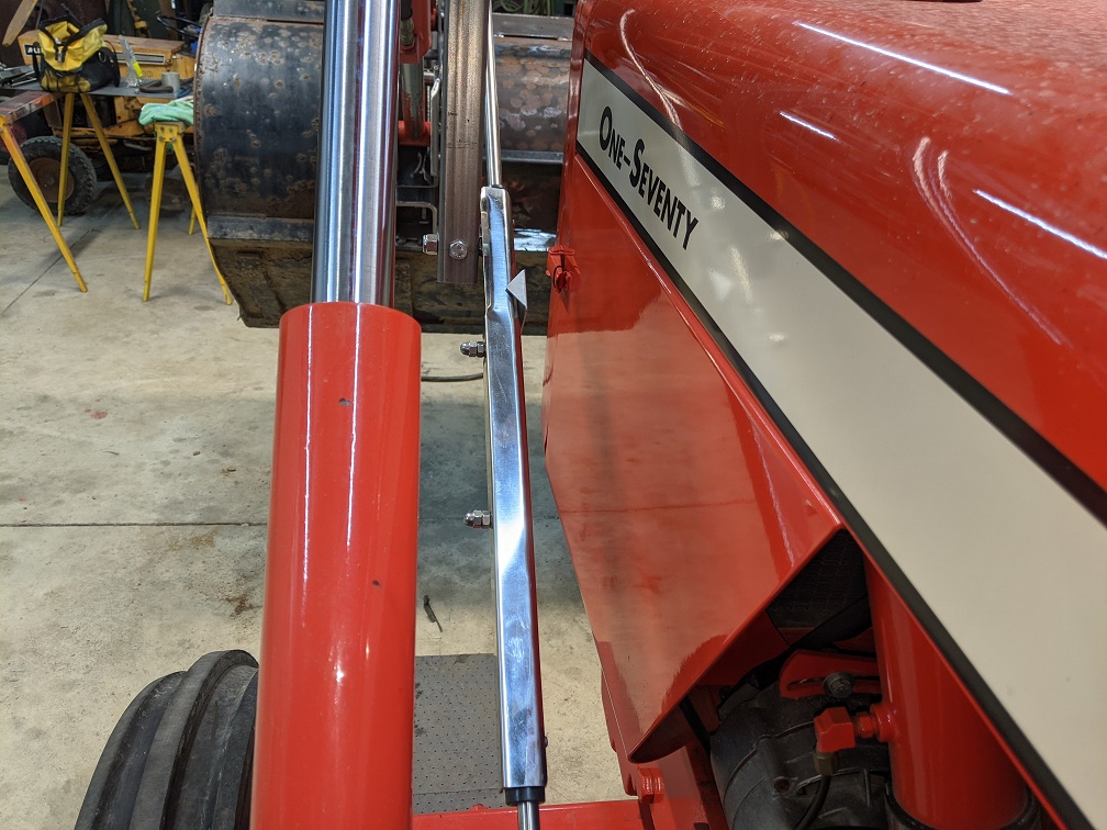

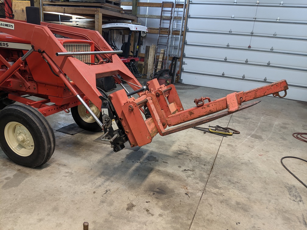

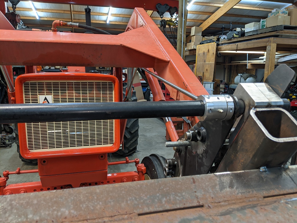

Just finished modifying a new old stock Farmhand quick attach and bucket for the One-Seventy with a 500 loader.  Here are some "in process" photos.
You may have to do the same with a quick attach for your 400 series.

Brett, beautiful 170. Nice fab work to suit your needs.
