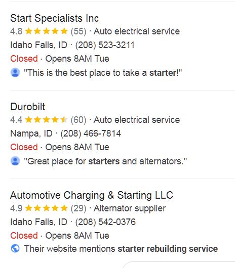

Points: 90873
Post Options Post Options   Thanks (0) Thanks(0)   Quote steve(ill) Quote  Post ReplyReply Direct Link To This Post Posted: 01 Nov 2021 at 9:31pm
Les Kerf View Drop Down
Joined: 08 May 2020
Location: Idaho
Points: 1640
Post Options Post Options   Thanks (0) Thanks(0)   Quote Les Kerf Quote  Post ReplyReply Direct Link To This Post Posted: 01 Nov 2021 at 9:49pm
Thanks Steve,
Those are all 450+ miles from here... Smile
