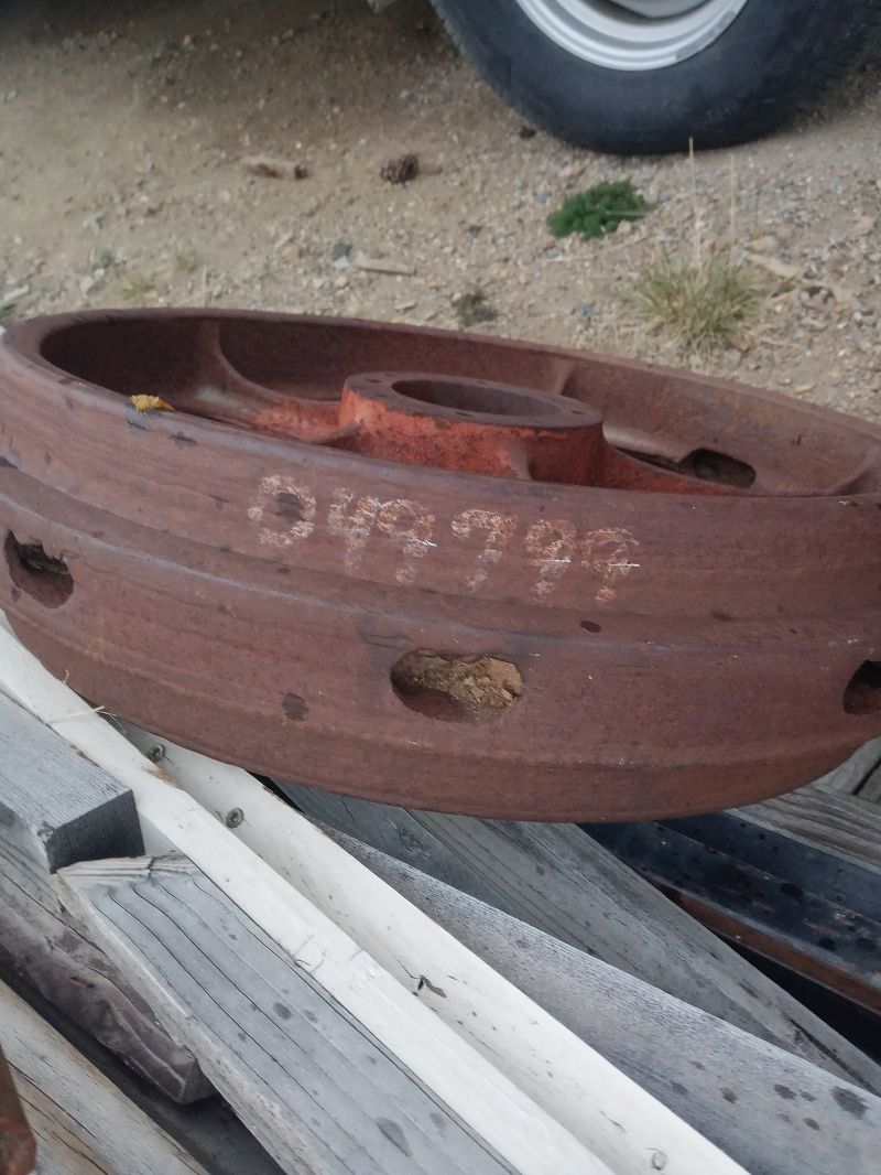

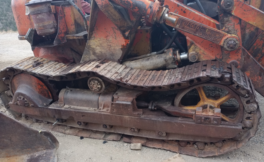

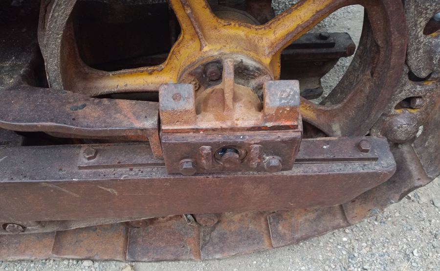

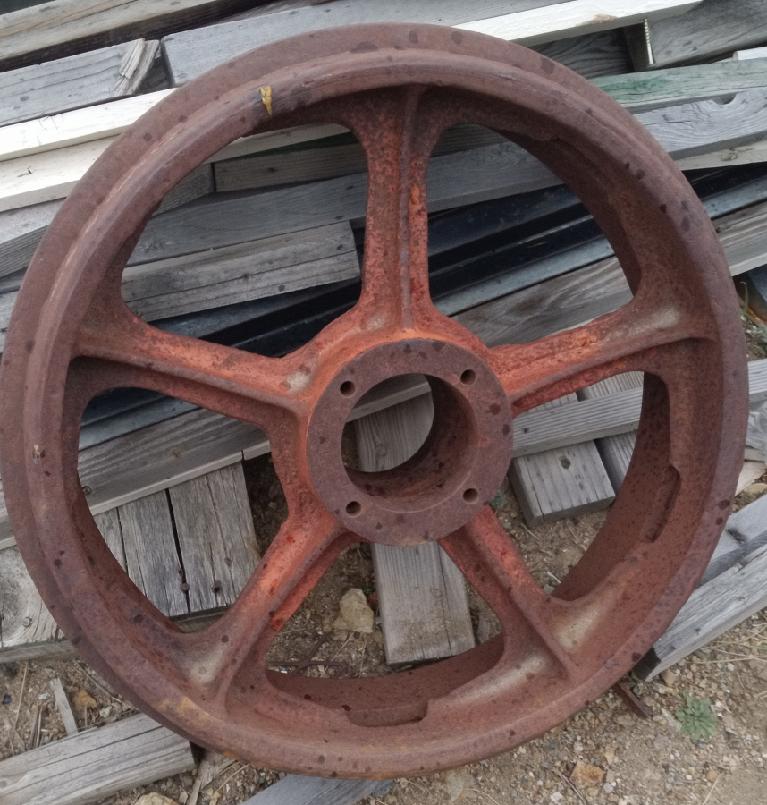

Wondering how tough it is to change the idler and is the 20 ton press completely necessary.  My track is 50% worn.  With the adjuster all the way in, the track looks like this:
This is the position of the old idler on its mounting bar:
The idler to be installed:
Condition of circumference:
The track has come off so many times (when adjusted) I think I can get it off without splitting the track.
How tough would it be to transfer the inner bearings and shaft to the new idler?  Can a rank amateur do it who tries pretty hard?
With the more bulky replacement idler is there a chance to get the track back on without splitting it?  Do I run a risk of having to split it and it being much more difficult from being loose?

You better removed the master pine and separated the track and  not surs if it is the master pine in picture were a brooken pad and about the motor did you change the fuel filter or maybe the governor rod need adjustement

I would guess just fixing the idler is not going to keep your track on. Old school is a 10 lb or bigger hammer to take the master pin out. Build a jig you can use a bolt whole in the pad to bolt it up and hold your punch to push pin out. Or if you have a crazzy friend that will hold the punch. I have held the punch with a pipe sitting on blocks for a friend that was good at this kind of thing. He used a 16 lbs hammer. If your bottom rollers still have good bearings, is there any lip or shoulder to keep the track on top of rollers when you turn.
If you are thinking of using a press to remove the master my guess is 50 ton may not be enough.
I believe it should be tapered roller bearing in the idler. Hammer the races out and tap new in.

You have to press the shaft out of the idler assembly as per the manual: we used a 50 ton press on my Son-in-law's HD5G idler and the gauge indicated just over 40 tons of force before it came apart.
Les Kerf View Drop Down
Joined: 08 May 2020
Location: Idaho
Points: 1630
Post Options Post Options   Thanks (1) Thanks(1)   Quote Les Kerf Quote  Post ReplyReply Direct Link To This Post Posted: 11 Oct 2021 at 5:56am
Originally posted by WaltDevore WaltDevore wrote:
How tough would it be to transfer the inner bearings and shaft to the new idler?  Can a rank amateur do it who tries pretty hard?...
I would not recommend doing this; removing the old races  and re-installing them perfectly straight without damage will be quite difficult to accomplish.
If you do wish to try it, do NOT use a hardened punch, nor should a soft brass punch be used.
Get a suitable size piece of mild steel rod and grind it to shape as needed. Use a fairly heavy hammer, 3-4 pounds is about right, and use light blows, tapping around the race to keep it straight.
Edit: You may be able to simply transfer the entire inner assembly to the new wheel without removing the races as they are already on the old shaft and bearing retainer, the bearing clearance may need adjusted by adding or removing shims.
Good luck :-)

After recheck the picture if you change the idler it will change nothing and if you have no more adjustement it should be the tread in yoke are no more good if the adjstement rod tread are in good condition  you could instaled a second big lock nut on the rod adjustement and with the new idler  with the track 50% worn the bushings ill hit the center idler gide and after 20hours work the bushing will be scraped

Thanks for the replies.  I may have created confusion in that the slack track picture is with the adjusting bolt (shaft) turned all the way in for maximum slack.  I can adjust the track out no problem for proper tension.  Thus the track still has
50% life.  I wonder how much that changes things?  So getting the track off the idler staying intact is not difficult.  I wonder if the track intact  could be pulled back over the idler?  I think coating the idler with grease to minimize the friction would be helpful. I'd have the tilt hydraulic and another tractor to help with pulling the track on.  My fear is that too much pressure may crack something.
If that is not a good idea, then removing the pin is the issue.  My instinct is to use a biggest sledge.  Is that not a good idea?  I have heard it's not a good idea to use heat, while others say it's the only way.

That changes things quite a bit; I misunderstood and thought that you were out of adjustment.
If the track comes off readily it can also go back on without damage.
If you do need to remove the master pin use the biggest hammer you can swing. As has been mentioned before, buck the track with a pipe braced to the other side to minimize lost motion.

I hope to pull the track off intact at maximum slack using another tractor to help pull.  I then hope to remove the bearing assembly to transfer to the replacement idler.  Hopefully that will be an intact piece without too much fancy messing around.  I then trust the amount of max slack coupled with greasing the replacement idler circumference will allow me to work it back on with track intact.  Sure need to get this done.  Winter is severely threatening.
