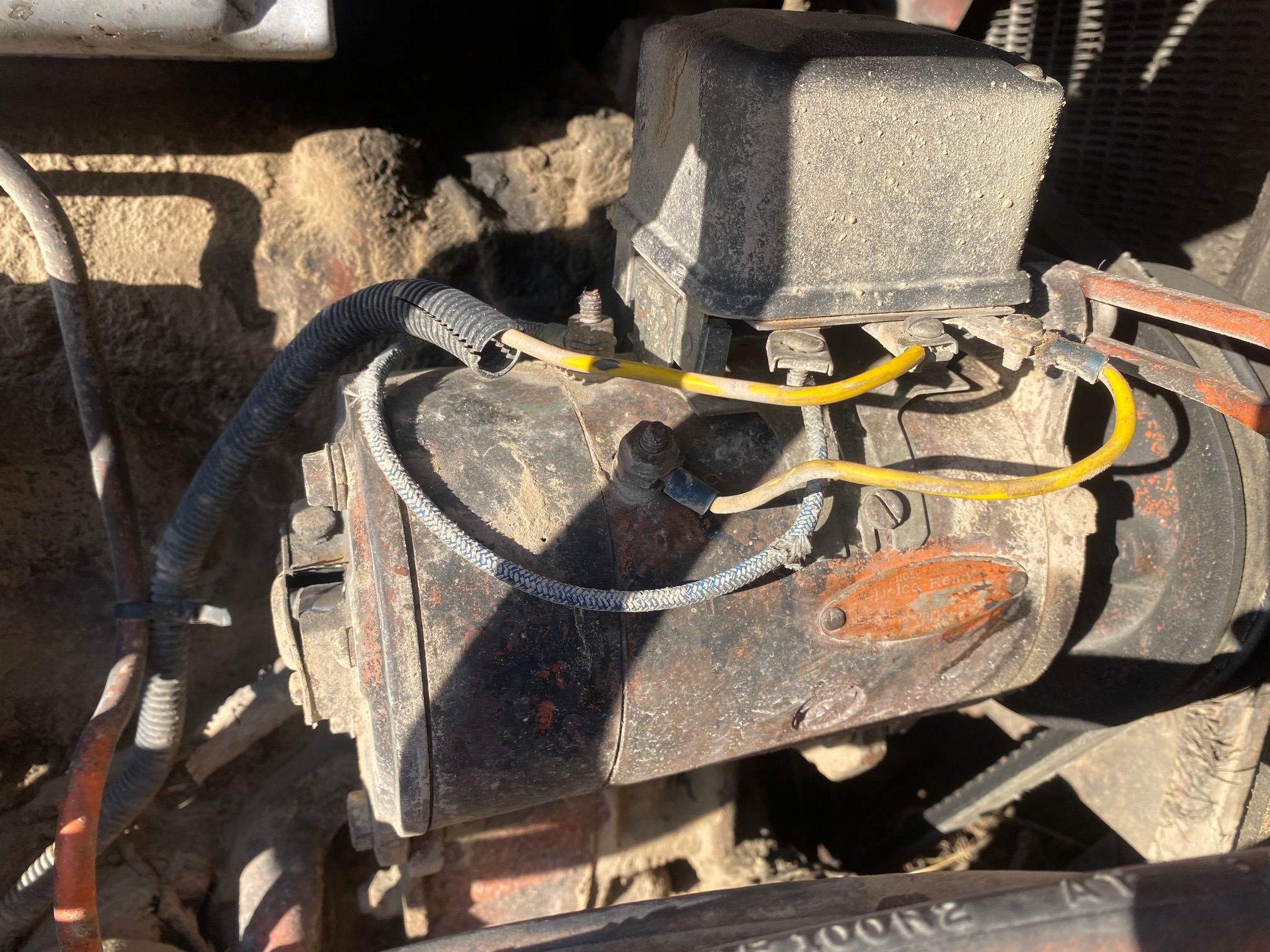

Im looking for a replacement generator for my 1949 HD5. The bearings are bad in mine.
Delco Remy 12V p/n 1100963

Bearings are easy to replace - your generator uses a cut-out relay to control the charge .
If you switch over to a Delco 10SI alternator the present pulley from generator will fit but the speed will be low and to get it to charge you need to rev engine to high RPM to get it to charge .
 I found a 2 belt pulley off a GMC truck alternator but was for small thin belt - I had to machine it out to accept 2 - 5/8" belts and being smaller in diameter it turns alternator faster for charging
 Nonce thing with 10SI is it is internally regulated so only 1 wire as you take a wire from battery side and hook to one of the spade lugs on alternator as sensing wire for unit.

Problem with using a car generator is most use a bushing in rear armature support and that brass bushing will not handle the load - replacing the present bearings with sealed ball bearing should be a easy job if you have a impact wrench to remove front pulley .
  Automotive units also use a 3 terminal regulator and you need a switch in wire or regulator points will close and drain battery unless unit is running - 10SI uses a diode so no back-feed to unit when stopped .

Thanks for the reply, Coke. I'd replace the rear bearing but if you look at the pic, you can see that it wore through the top of the rear flange. Maybe I can find a used one for parts?

It looks like rear bearing failure lead to armature eating through outer bearing race along with end plate - so a new armature along with new end plate would be needed - then front bearing has to also had damage from angle change of armature -
  Making a bracket to hold a 10SI is easy using present base - and adding spacer
