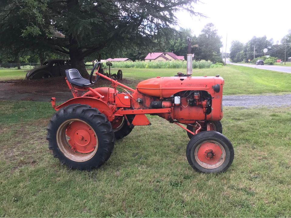

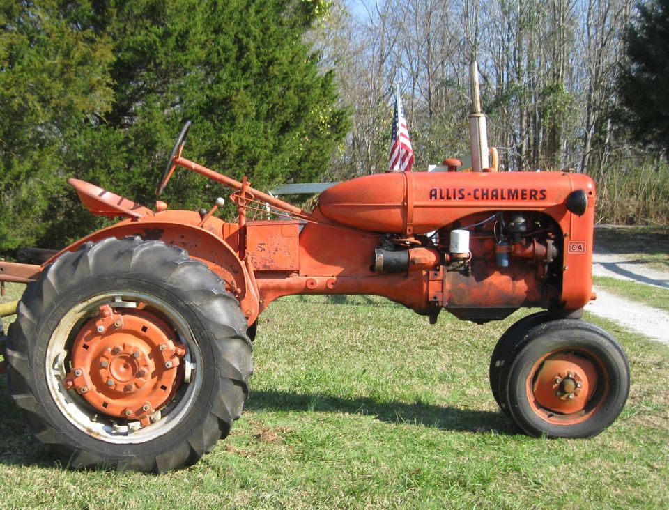

I am looking at 2 different AC's, Model B and CA. Both are priced the same. I already have a 3 point brush hog so 1 is obviously more useful out of the gate.
initially it will be used for brush hogging, and eventually hobby farming.
Model B Wide Front. Needs gas tank cleaned and sealed & needs new brakes( I am capable of these repairs). It is converted to 12 volt with New battery. Has underbelly brush hog and finish mower but are not complete and possibly not all components to mount on tractor. It has brand new rear tires. It is confirmed running on an auxiliary gas tank.
Model CA - Tricycle front. Has been shed kept. It was Running when parked 2 years ago. (famous last words) it needs a new carburetor - not rebuilt. has original 6 volt system. may need a new battery but battery was new 2 years ago. New Points, distributor cap, and wires. Has a 3 point hitch. 1 new rear tire, but other tires are servicable. No confirmation that it will start up now, but according to seller should with a new carb.
My land is flat with only a few smaller ditches that are not steep but more rolling. I have always heard the warning of tricycles tipping but again user error and ability of machine must be taken into consideration.
I would ideally like a 3 point hitch. I know the B would benefit from an overrun clutch. but the kit is 500 and the clutch is around 70.
Wanted to get others thoughts on which would be the more useful machine given this above information.

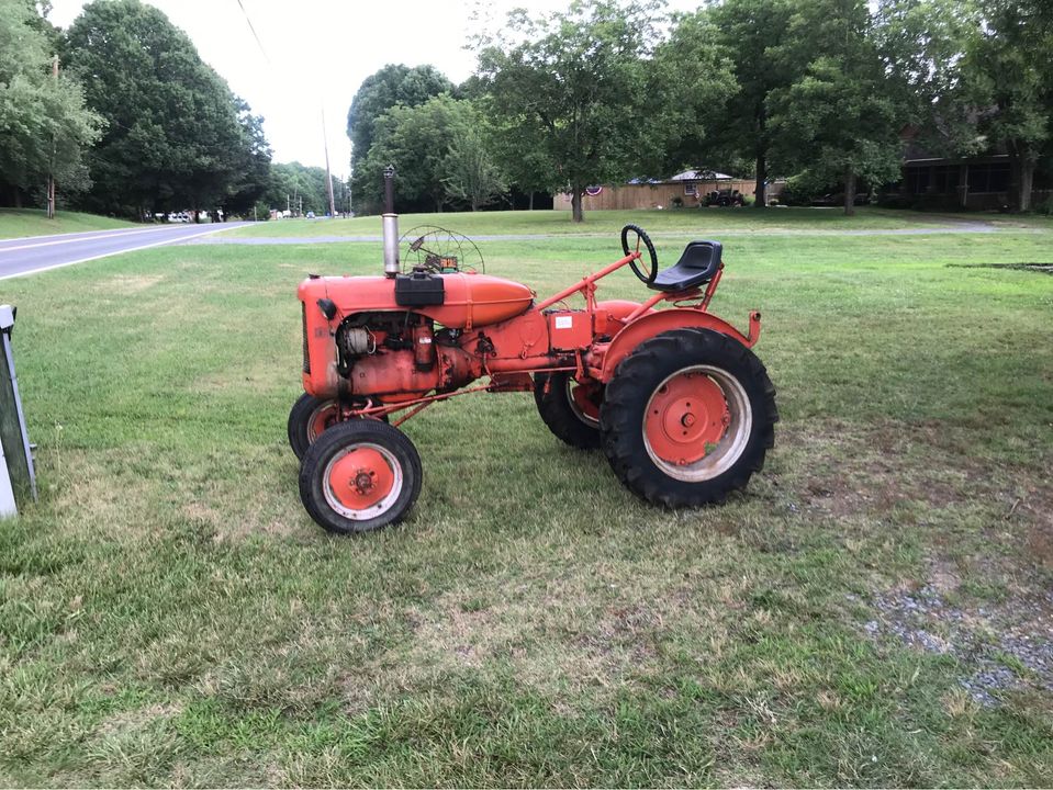

Post Options Post Options   Thanks (0) Thanks(0)   Quote mosstrumpet Quote  Post ReplyReply Direct Link To This Post Posted: 19 Jul 2021 at 1:36pm
This is the Model B

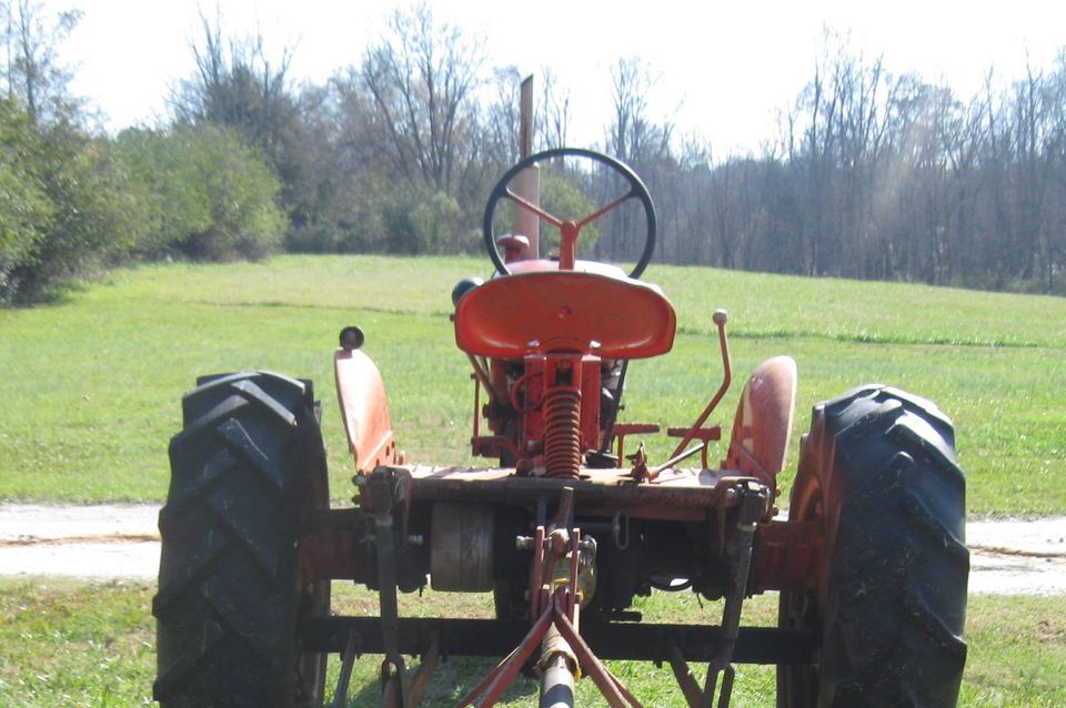

This is the CA

those are both Nice, Straight tractors !

The B obviously has a fuel tank issue, hence the side saddle plastic tank. Wrong style seat also. Plus the CA is worth more if they are both in good mechanical condition. The CA is a much more versatile tractor. Again, the CA hands down.

One of the things to remember is that the CA is about a foot wider at the rear to start with. Also, as was pointed out above, you have the option to "spin" the power adjust wheels out for maximum width.
With the added width, the CA will be much more stable on sidehills.

Well I own both a B and a CA, as far as putting a 3ph on, the CA is easy, never tried putting one on the B as it is used to cultivate sweet corn.  The CA has more power plus the hand clutch.  I pull a 6' finish mower on my CA narrow front.
