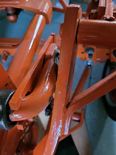

When raising the plow, it swings in toward the center line until the top of the frame comes to rest against the rocker arm and, of course, scrapes the paint off both the rocker arm and the upper arm of the frame. The rocker arm is pushed in as far as it will go and I haven’t read anything in the implements manual that gives me any clue about why this is happening.  Anyone have a suggestion on how to correct this?

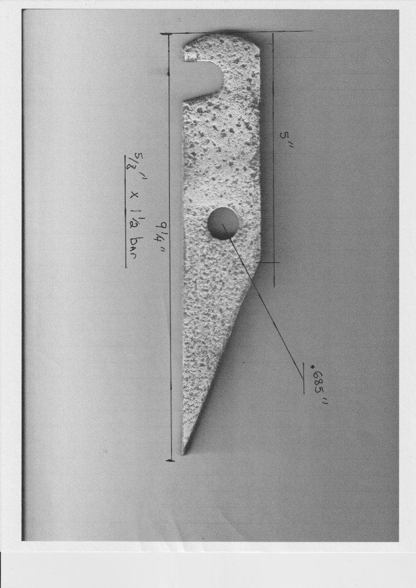

Post Options Post Options   Thanks (0) Thanks(0)   Quote JoeM(GA) Quote  Post ReplyReply Direct Link To This Post Posted: 21 Jun 2021 at 10:44am
see if this helps anyone in the future

Post Options Post Options   Thanks (0) Thanks(0)   Quote Dusty MI Quote  Post ReplyReply Direct Link To This Post Posted: 21 Jun 2021 at 10:58am
Nice job Joe.
I just looked at mine, it's holding the plow on my G right now. I have pair of right and left plows on my G right now, and only one of those wedge plates, and it is slightly different than yours. But it's not easy to measure because it's in use.
Dusty

Post Options Post Options   Thanks (0) Thanks(0)   Quote Dusty MI Quote  Post ReplyReply Direct Link To This Post Posted: 21 Jun 2021 at 4:45pm
Mine is mounted on my G right now so it's a little hard to measure, but it's a little different.  It's
5/8" x 1-3/4" x 8-1/2"
One bolt hole is in the center of iron, both ways.
The other hole center is 7/16" from the side/edge.
The taper starts at the center of one side to the end of the other side.
It looks to me that either one will work. If Allis only made one size I would guess that mine was farmer made.

Post Options Post Options   Thanks (0) Thanks(0)   Quote BobDinNC Quote  Post ReplyReply Direct Link To This Post Posted: 25 Jun 2021 at 12:50pm
A local shop will make a replica of 1/2" (not 5/8" as original) for $25. If anyone is interested in one, let me know by June 30 and I'll have one made for you. Bob
