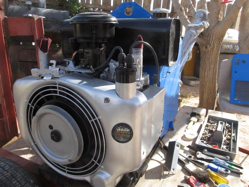

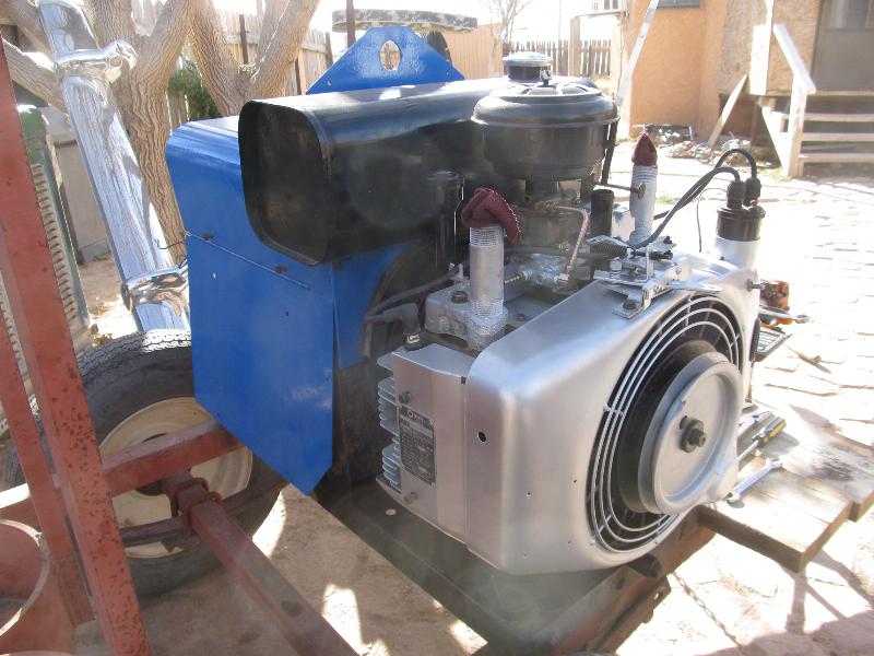

 Well,,Ya'll know how the sayin goes,,,"When anything "sets" long enough,,,it'll start to set",,,,( I thought of that one all by my self),,,,,,LOLLOL
 Anyway,,after ole Thad reminded me,,,,the Welder/Generator has been settin for nigh on 5 years or mayhaps even longer,,,,,,I got it out the boat shed and brought it up to the shop and after a few shots of start fluid it finally started ,,,,but it sure did NOT want to,,!! I pulled the carb and cleaned it out as had some gookies build up. Tried it again and still would only run with almost full choke which is indication of starving for fuel. Flushed the gas tank and it had some brownish chit in it and one bug,,,,,?Tried again and engine STILL wants bout 3/4 choke to continue to run and ragged as it is,,,WTF,,? pulled carb again and used a wire pilled from a wire brush and all the crannies I can see are clear and flushed with carb cleaner,,STILL wants 3/4 choke,,,I'm gettin MAD long bout here,,,,,!!!!
 Decide to try the welder part and it won't weld either!! It has a knife switch for switching from welder to generator and so I sandpaper all the knife contacts and VIOLA,,It works again!  BUT it still will NOT run but with almost full choke on,,,So,,after the 5th time of removing the friggin carb AND the manifold, I'm ready to try something else. I've got a buyer waiting on this machine and I am pizzed,,!!!
 I checked out Ebay and Amazon and a new carb can be had for $45, but the mounting bolts of the new carb are 2 1/4" center to center and the old carb is 1 3/4" center to center,,,!!  THose that have worked on these Onans, know the carb bolts to the manifold from the bottom up,,is why manifold has to be removed to work on carb.
 Now,, I have an idea for making a "spacer/adapter" to install the new carb with the 2 1/4" bolt spacing on the 1 3/4" bolt spacing manifold,,,,,,,
Has anybody done something like this,,,??  I should mention that Exact in kind replacement carbs  for the CCKA Onans are available for $356 IF you can find one,,,and I ain't gonna look at them prices,,,,WinkWink

 GREAT Points JC, Thad and Steve,,,Clap OH and Shameless,,,,no fair,,,"IF" I'm rememberin correctly,,,you had quoted me a price for the Chevy Allis,,that was a few songs lower then the Miller is worth,,, Now,,I maybe havin a few issues with my danged old memory on the price you gave me,,,,and when I get these little bitty issues worked out,,,,,,AND,,,,AND,,,I WILL,,,!! I will have a better "pallavering spot than I gots right at this minute,,,,,,LOLLOL
OK,,now that we gots those issues ironed out,,,I had went ahead and ordered one of them new carbs on Ebay cause it listed the place it was gonna be shipped out of as HUMBLE, TEXAS which last time I looked is in the USA,,,right?? So I figured we was looking at a week for delivery.  NOPE,,NOT TO BE,,,!! Soon as I hit the "BUY"  button it calculated the tax and gave me the total,,which was OK but then the delivery screen comes up with a 2 week delivery date FROM CHINA!!  I contacted the seller several times right quick,,,but no response as of this morning,,,SO, I CANCELLED THE SALE last night and notified Ebay of the discreptancy,,,!!  Ebay notified me that I cannot cancel the sale til Sunday. Them AH's got to get up way earlier then that to get to ole joe,,,,,
 Gonna try all of ya'lls suggestions today.....I'm OK now,,,,sigh,,,,,Clap

 Well,,,a bit of an update on the Miller/Onan welder project,,,,,
 I got the new carb the other day and since I had already fabbed the bottom half of the new "Adapter",,I set, measured and welded the top flange up and painted it purdy,,,, The Onan has a hand primer and after a few pumps I hit the starter switch and,,,,and,,,thet sob started up and ran like ole Shameless's shoes when he sees an auction going on,,,,,LOL
 It does tho,,,that new carb was what the Onan was lookin for,,,,,Clap

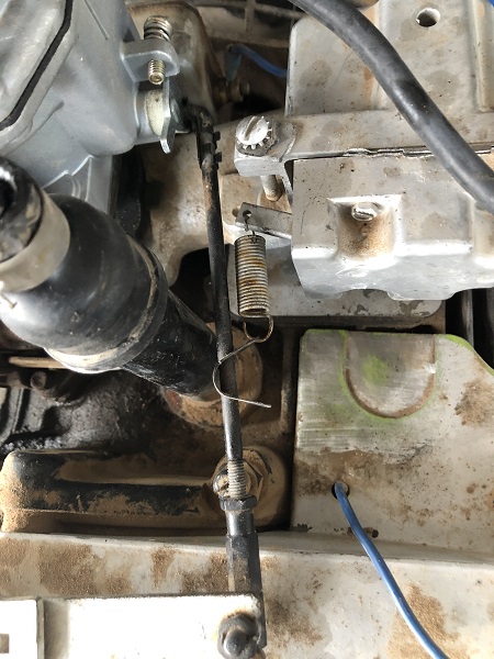

 The Only'ist thing I cannot figure is how the dang mechanical guvnor is susspossed to work and my friggin computor is acting up and WILL NOT resize the pics from my IPhone AGAIN,,!! The existing guvnor arm bolted right up to the new carb so,,,,?  Anyway,,when I strike an arc with the welder ,,the engine will NOT rev up just keeps loading up and will finally almost die down,,,," SOOo,,I raised the idle HANDLE to the middle position and it will weld like crazy but engine RPMs never change til I stop welding and lower the idle handle,,,I don't think  that is how it susspossed to work,,,,"
 Any kind words of wisdom,,,??

Joe they have to run at 3600 to weld or 1800 for the generator side.
Thad in AR. View Drop Down
Location: Arkansas
Points: 9731
Post Options Post Options   Thanks (0) Thanks(0)   Quote Thad in AR. Quote  Post ReplyReply Direct Link To This Post Posted: 16 Apr 2021 at 4:59pm
Low speed is generator
Medium speed low current for welding and high speed for high setting on welder

 I had just about come to that conclusion, Thad,,,,,this thing I'm thinking to be a guvnor is just a low idle, medium idle and a high idle for the particular job you wanting to do,,,Clap
 You remember the little fuel primer pump with the small handle,,,?? That sob started to leak a little oil and that little thing is way under the carb with NO WAY to get to the 1/4" bolts,,,,,SOOOOO,,,I got to take the friggin intake/exhaust manifold off Yet again,,,,,,why didn't that sob leak yesterday,,,,,????WinkWink

OK, my 3rd son from El Paso is here and is a little guru with PC's so I asked him to help on resizing pics and he showed me an easy way long as I don't forget,,,,,,,
 Ya'll see the square box that has the little arm that has the spring attached to it,,??  That arm is constantly trying to move back and forth bout 1/4" but is controlled by the manual handle at the front of the engine,,, SO,,what is the purpose of the little arm? THe throttle rod is controlled by the lever arm (handle) at the front of engine,,,,so that little arm can go back and forth all it wants to but cannot move the throttle rod till the operator does,,,right?
