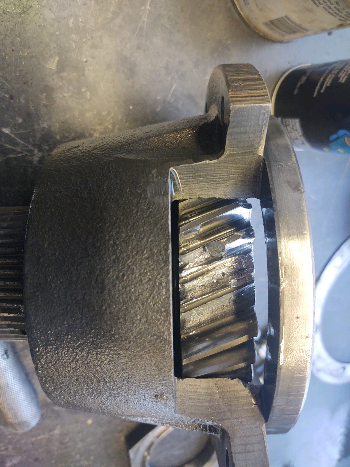

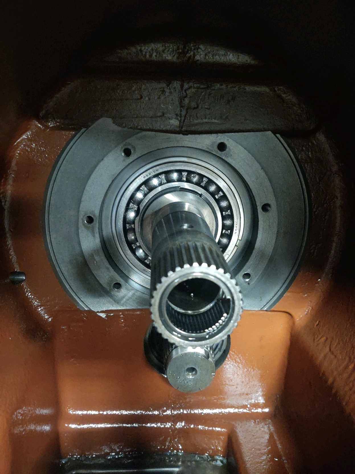

Hey everyone. I just wanted to give everyone an update on the transmission and to ask for help as to what I am looking at. It turns out it was not the power director making the noise, but rather some teeth broke off, and it looks like it was starting to take out a bearing.
Would anyone be able to provide insight on the gear that had teeth break on it? I am always a curious guys, and was wondering what the gear actual went to? Did it run the low side of the transmission? Was its job to transfer power from the engine to another part of the transmission? The reason I am curious is because it looked like it bolted up to something.
Are teeth breaking off normal in this transmission? We have had the tractor for 8 years, and use it mainly to pull a 24 foot disc 3 inches in the ground which I thought it could handle on hilly ground in western Iowa.
Thanks for any replies!

That happened to me too!
I bought the tractor (8070) used and it had a ticking sound in the trans but only in a certain gear and range.
The tractor had two previous owners and you know someone overloaded it when the damage occurred. The guy before me didn't want to spend the money to fix it.
I had to split the tractor, remove the transmission and change two gears.
Luckily, there is a lot of cross over parts with that trans with the other smaller models so you may find the gears at a wrecker.
Good thing you found the problem before it got worse!
