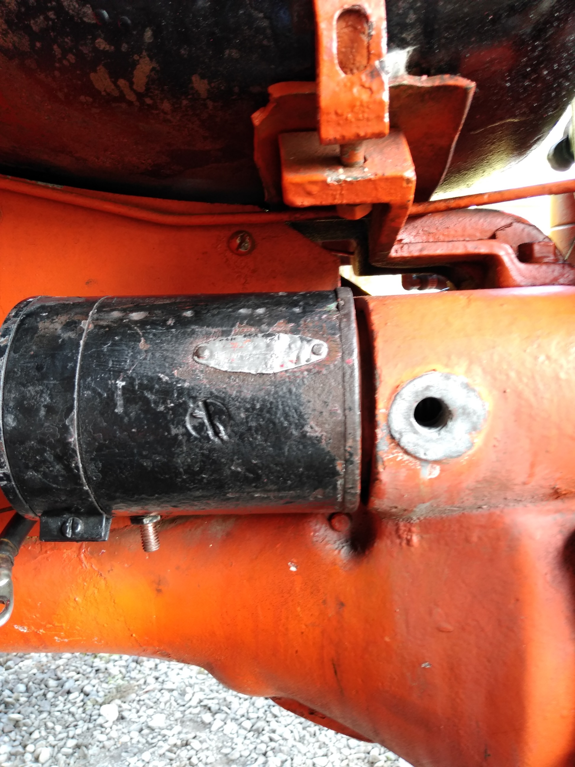

It might be hard to see from this picture, but that hole is not right. The armature and internals could probably use replacing after all this time, that I can do.... I'm worried about that hole though.... it really does look oblong, even with the taper.
From time to time (since I got the tractor last year), the starter would lose ground. I would have to loosen that bolt, and re-snug it to get juice to it. Even when I got it locked down tight, it would eventually slip back - towards the seat, then it was wash, rinse, repeat. My neighbor and I had the same idea - tap it - but there does not seem to be enough metal - towards the taper - to put a proper tap.... it's really worn out in there. Maybe that's normal.... I just don't know without seeing enough of these things. I guess I could go with a 6 volt starter, they seem to be available.... pricey for the newbies though.

That hole looks like it has the remains of some threads in there.  The original hole is drilled with a taper to match the lock bolt and was never threaded.  Some one has attempted to modify that one.  You should probably try to find a good used nose cone with the proper tapered hole or you will continue to have problems.

That image clarifies things for me.  I'm with Phil, you need to replace the nose section.  Alex09(WI) or Stookless can probably hook you up.  Both have served me well on my project.

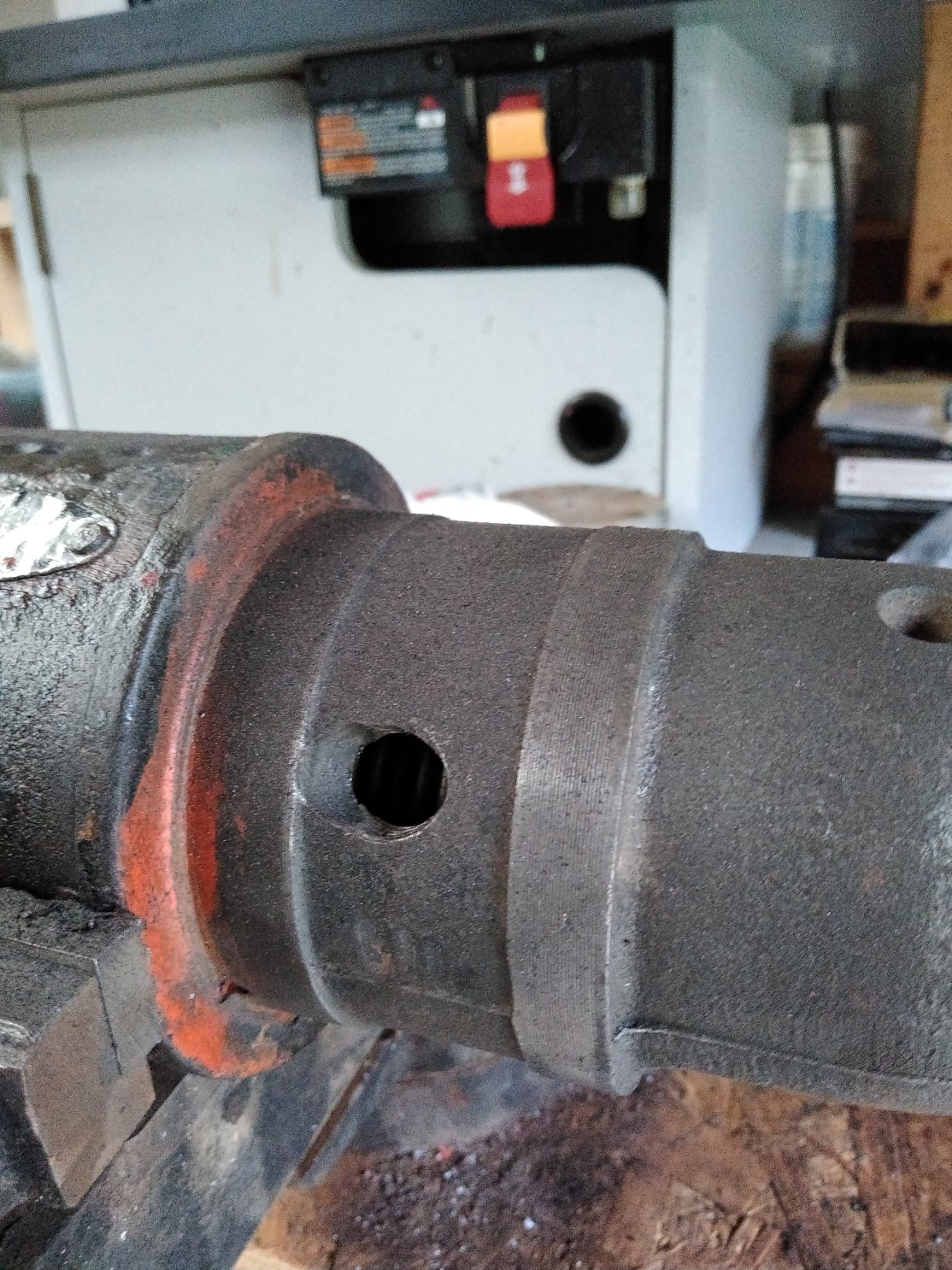

That retainer bolt hole seems too far back on the nose. It is normally centered between the starter cone's locating bands.
A photo with the starter mounted looking into the starter retainer bellhousing bolt hole would be helpful to see if there is an alignment problem.

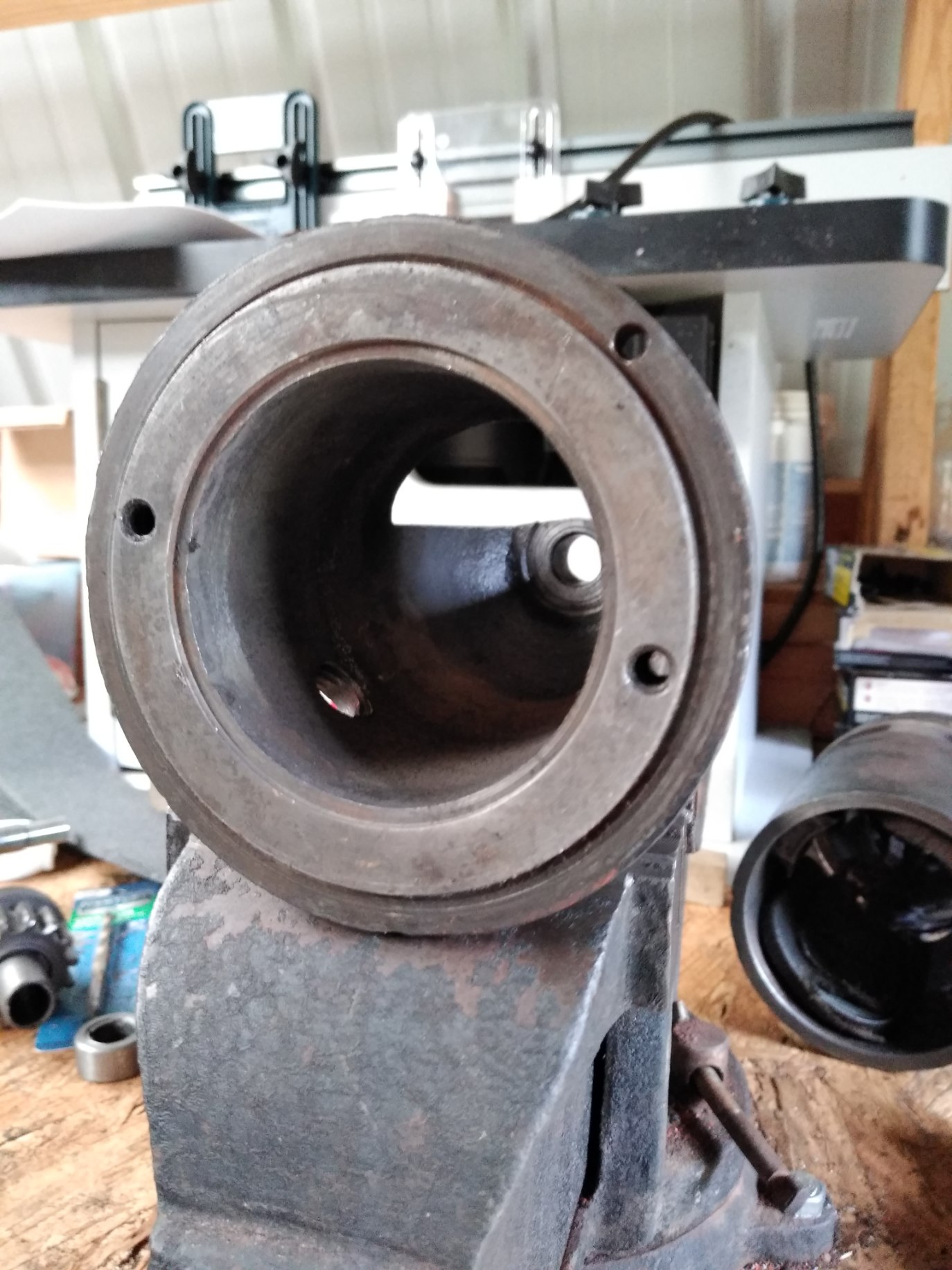

There is not supposed to have threads in that hole.  Some one has messes up the starter lock (pocket).
I just check ebay to get a picture to post and see the brand new starter cones have a threaded hole. The only way that would work is if the torque tube was not threaded. All the starters I have here has a taper hole that the tapered end of the tapered stud locks the starter in place. With that large of a hole the tapered stud would never work properly.  You might get it to work by using a longer bolt without a taper that would go all the way thru the cone casting. I would then add a ground wire from a starter bolt the the torque or to where the battery ground bolts to the tractor.
To use a new starter cones with the threaded hole and have success you would need to remove the threads from the torque tube or the starter could not pull up tight.

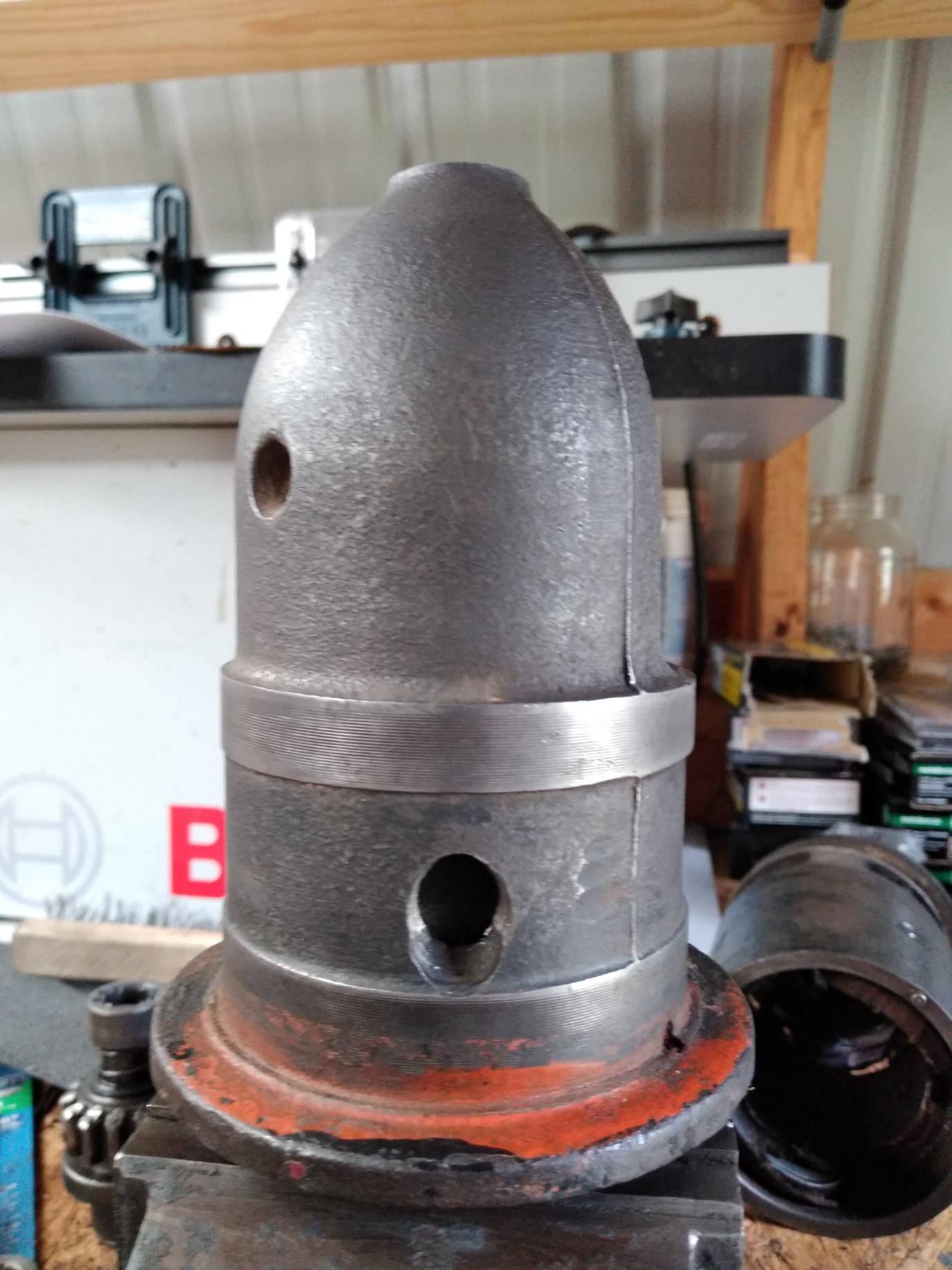

This is the starter, perfectly aligned with the tube opening.
I have noticed that, of all the starter nose cones I have found, none match the one I have.

Yes, I noticed that when my neighbor and I found a bolt to mate up with those threads in the cone. It stopped back and forth movement, but it did not lock the starter down tightly.
Since I am having a hard time finding that particular nose cone, I think my neighbor and I will attempt to weld the hole, then retap with a slightly smaller bolt, to bypass the threads in the torque tube.
If I understand you correctly, the threads in the torque tube should not be there?
I am going to rebuild the starter. It would be nice to find that particular nose cone. I wonder why everything I have found does not seem to match up to what I have, even though some that are for sale say those cones should work with the 1107043.

NO.. I dont think you understand.. The bolt is POINTED on the end.. It screws INTO THE TORQUE TUBE and the point goes INTO THE STARTER NOSE.. It PUSHES the starter toward the motor and forms a GROUND for the elect to work.. The "HOLE" in the starter nose is suppose to be tapered and match the point on the BOLT... The THREADS in the TORQUE TUBE are what holds it all together.

You can grind the taper hole in the starter nose a little to reform it... you can also grind the point / end of the bolt so it fits "better" into the starter nose hole... A good FIT will guarantee a good ground and will stop the starter from MOVING back and forth.
The starter may not set ALL THE WAY INTO THE TORQUE TUBE HOLE.. Seems to me that when i install the TAPER BOLT and it pilots INTO THE STARTER NOSE HOLE, that the starter motor may be 1/8 OUT from bottoming out in the torque tube.

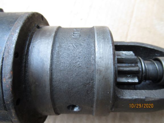

All good points.  Look at the space on mine in the pic below.  It works perfectly and doesn't get loose. (I also wire brushed the inside of the starter hole on the torque tube and the outside of the starter nose where it rests against the hole for added contact).
starter
I took this picture some time ago for another purpose, but you can see how far the body of the starter is from the hole.

That looks a bit similar to where mine ends up, after engaging it, over time. To everybody else that offered it, thanks for the advice/heads up with the welding option.

The problem I have run into so far, are the mating holes on the nose not matching the starter cylinder. On my cylinder, there are the two bolt holes, and a tab that have to line up with the nose. Maybe I just haven't looked in the right places yet, but I have looked at a few.... prices ranging from $50-75.

That hole in my nose is so deformed, that when I tighten that bolt it actually pushes the starter back away from the motor.... guessing around an 1/8"....
edit to add
when I install the starter into the tube- before threading the bolt, the holes line up perfectly and the tip of the cone is flush against the tube.

The old pinch bolt system was a pretty crappy design to hold these Starter motors in place. Being most of the weight is to the rear of the unit, it didn't take much for the Starter to become loose and lose its ground. The rings on the nose cone are also for grounding purposes on some applications. I've repaired some of the nose cone mounting holes with either JB Weld or if the hole was really bad (like yours is) had my welder fill the damaged part of the hole, and I would taper it for the pinch bolt to fit much more snug in the cone. Another thing to inspect is to make sure the threads in the hole in the torque tube are not stretched to where the bolt is loose and when the jam nut is tightened cocks the Starter motor, or does not hold the unit tight as it should. This will cause mis-alignment problems possibly cracking the nose cone or pre-maturely wearing out the ring gear teeth on the flywheel.
The nose cone problem you are having is not new. There were a lot of these old Starter motors that had different indexed nose cones that were used for different applications. I myself had some problems finding the correct cones for certain motors over the years and I rebuild the damn things. A lot of my old suppliers are gone and it makes it tougher to find the CORRECT parts for certain units. Some I would have to index myself to make the cone work for the application. I've come across a lot of goofy stuff over the past 50 years I've been rebuilding Starters, especially these older Delco units, and even more so with other older brands such as Autolites, & Prestolites.
On some of the high torque pulling Starter motors I've built over the years, I would make the suggestion to the customer to build a support bracket to support the rear of the Starter to keep it from moving when my high torques engage to a high compression pulling engine. This keeps the motor straight and snug to where it won't move and all torque gets transferred to the engines flywheel when engaged. If you run into the problem of repairing the nose cone, you might want to consider that idea to help support the rearward weight of the unit and keep it aligned correctly. A rear support helps emensly with the poor pinch bolt design.  Of coarse, like anything else, designing a rearward support bracket depends on the application involved...   HTH
Steve@B&B
Brian G. NY View Drop Down
Location: 12194
Points: 2256
Post Options Post Options   Thanks (1) Thanks(1)   Quote Brian G.  NY Quote  Post ReplyReply Direct Link To This Post Posted: 29 Oct 2020 at 10:22am
[QUOTE
I would guess that China had a better idea! Angry
[/QUOTE]
Different, but I'm not sure better.
There are a few nose cones on ebay right now and the vendors say they fit Bs, Cs, CA,s, WCs, WDs and WD-45s.
I don't know how that is possible since the location of the tapered hole has to be different between the smaller and larger engines. If you look at the threaded holes in the blocks, you will see that, in the case of the larger engines, the hole is exactly perpendicular with the crankshaft. It is not on the smaller engines. Assuming the housing is the same diameter, it would probably be fairly easy to machine a new tapered hole in a WD-WD-45 housing so it would fit either engine.
The original tapered hole is located dead center between the two machined surfaces.
Although the hole in jibintn's housing is really messed up, it appears to me that there is
enough of the original hole left to allow the tapered bolt to be inserted far enough to still hold the starter in its correct position. Here is a picture of a nose cone which I think came from a WC. You can see that the tapered hole is located differently than the one on the B.
t

Thanks again to all of you. Lots of good information, ideas and suggestions. Got the innards for the starter today, going to completely rebuild it, thinking about how I want to go forward with the cone.
Welding the hole and re-tapping is still at the top of the list.
Heating that nose up before welding.... minimum temperature should be what since it's cast iron?
I've read 300 F, I've read 500 F minimum. Then letting it cool slowly, immersed in sand.
Thanks again. I'll keep y'all posted on the progress.
p.s.
I like the idea of a bracket, btw. Might be an option.
