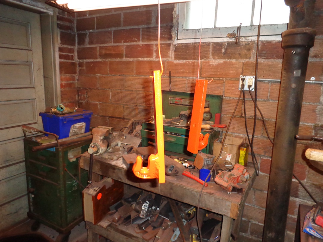

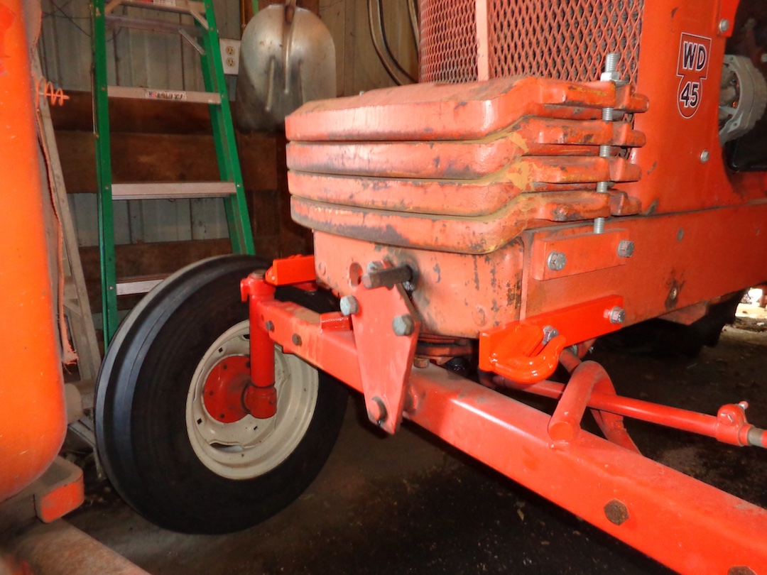

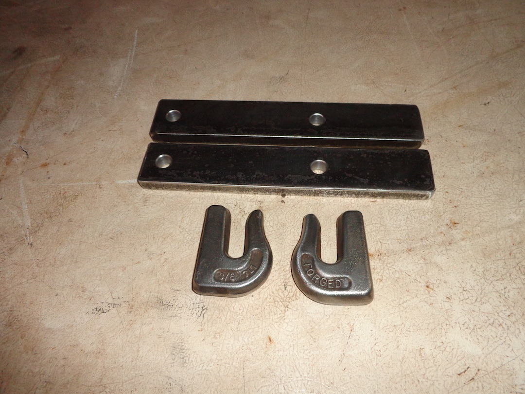

I trailer my WFE WD45 a fair amount. Used to just run a chain around the front axle tube and bind her down. After the front-end rebuild and painting I can't do that anymore. Have been using 1/2" 'swivels', down side is they have to be removed before moving the tractor as the hoop would hit. Found a couple of weld on chain hooks in the shed awhile back and got this idea. Found some flat iron the right size, little welding, little paint, wala!
Pictures in reverse order as usual, you get the idea.

Mike that neat I've seen them weld on the frame behind the front wheels.

Dam I wish I could weld that good. Looks nice!!!!

 I was thinking the same thing on that weld! You laid down a nice bead!

If you don’t mind me asking where did you get them weld ready hooks? TIA

Thanks guys, since I found the local/remote setting on the welder, it's working much better for me!
Chris, I put three passes in each joint. Welder is set up on tig right now, going to build an engine stand and possible some splitting stands this winter so I will have to change it back to mig. Hate changing from one to the  other.
Kenny, I wanted something removable, hopefully looks better and can be used on my other WD's/45's.
