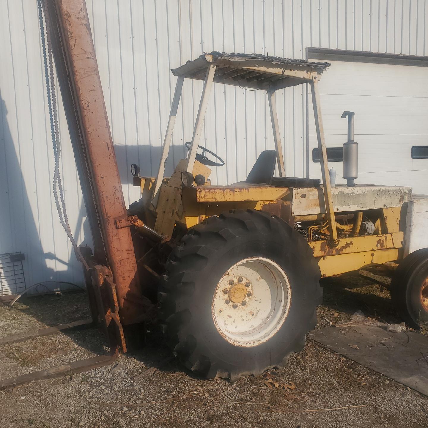

Last Sat. I ended up getting ANOTHER project hauled home (NON-Allis) destined for scrap, and I mean literally scrap (being it was located 1/2 block from the scrap yard).
1975 International 4500B forklift.....

That is the type of fork lift that would be real handy.

That's what I was thinking when I received the pic from the owner.
With the forklift AND the HD5 I might actually be able to at least start on another building to house them and a small shop to work in.
