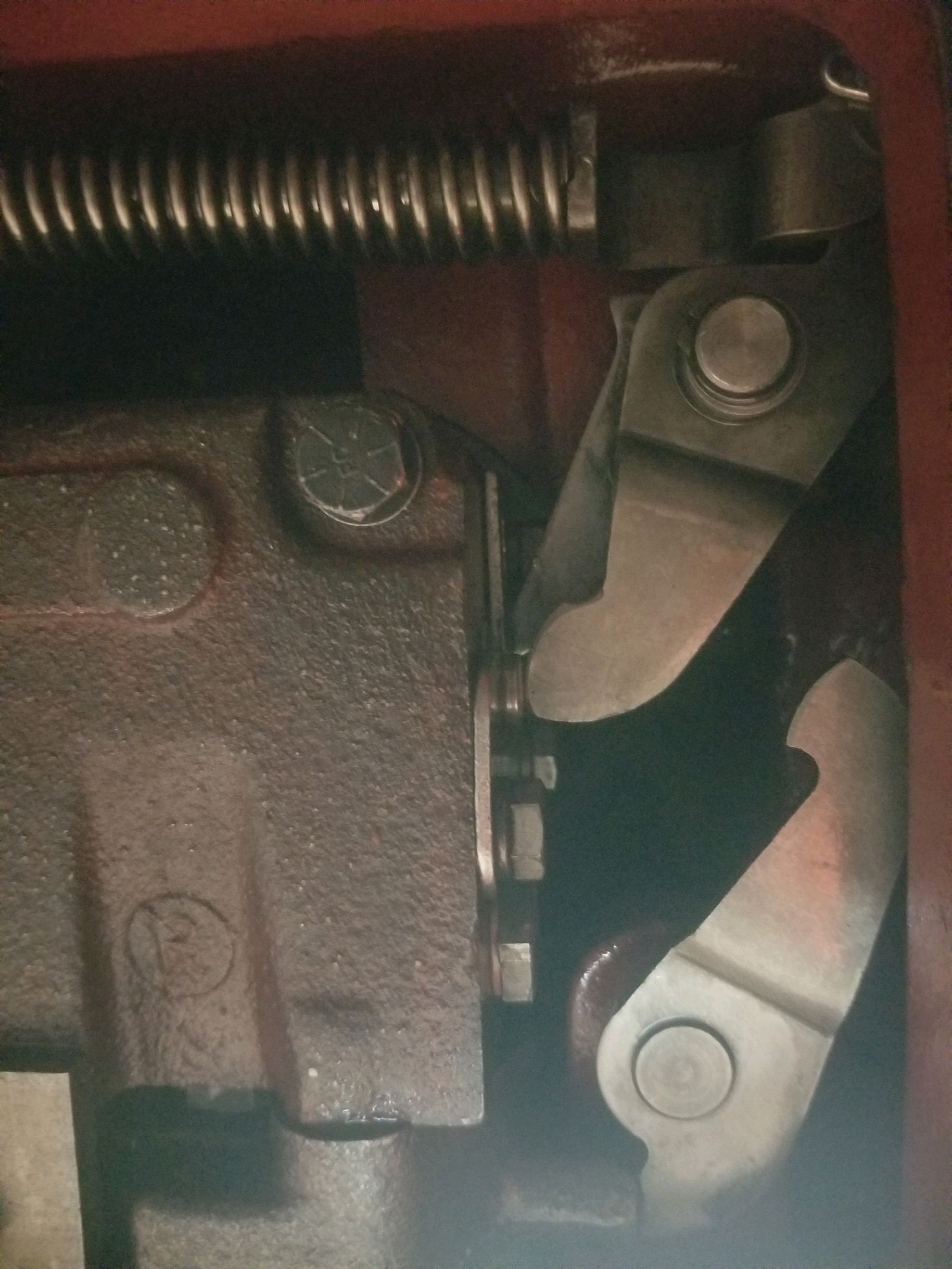

Post Options Post Options   Thanks (0) Thanks(0)   Quote hkirschner Quote  Post ReplyReply Direct Link To This Post Posted: 04 Aug 2020 at 7:53pm
uploads/21253/AC_D17_series_1_HYD_pump_pic.jpg
I did disconnect the drawbar linkage from HYD pump connection and problem still exist. When tractor is running the rear arms raise, and attached loader raises, regardless of positions of both levers. In the picture i have both levers in the lower position and the Control valve stack is still pushed in by traction booster lever, The lower lever is away from the control valve stack, The Traction booster linkage for lever, to my knowledge has no adjustment. Let me know what it could be. Thanks

Post Options Post Options   Thanks (0) Thanks(0)   Quote DrAllis Quote  Post ReplyReply Direct Link To This Post Posted: 04 Aug 2020 at 8:36pm
With drawbar linkage removed, the loader and arms will raise to the top. With the same drawbar linkage mal-adjusted (too short) the loader and arms will raise to the top. This part must be installed and adjusted LONG enough that the lift cannot work unless the Traction Booster lever is raised 4 notches from clear up. All this is in the Owners manual.

Post Options Post Options   Thanks (0) Thanks(0)   Quote MACK Quote  Post ReplyReply Direct Link To This Post Posted: 04 Aug 2020 at 9:00pm
adjust link from drawbar spring to pump cover until you only feel spring pressure on TB lever the last two notches from top. Takes a 3/4 wrench to adjust.        MACK

Post Options Post Options   Thanks (0) Thanks(0)   Quote hkirschner Quote  Post ReplyReply Direct Link To This Post Posted: 09 Aug 2020 at 1:10pm
Thanks for Info, I made the adjustments to the Traction Booster linkage and she working fine. Thanks again guys for advice.
